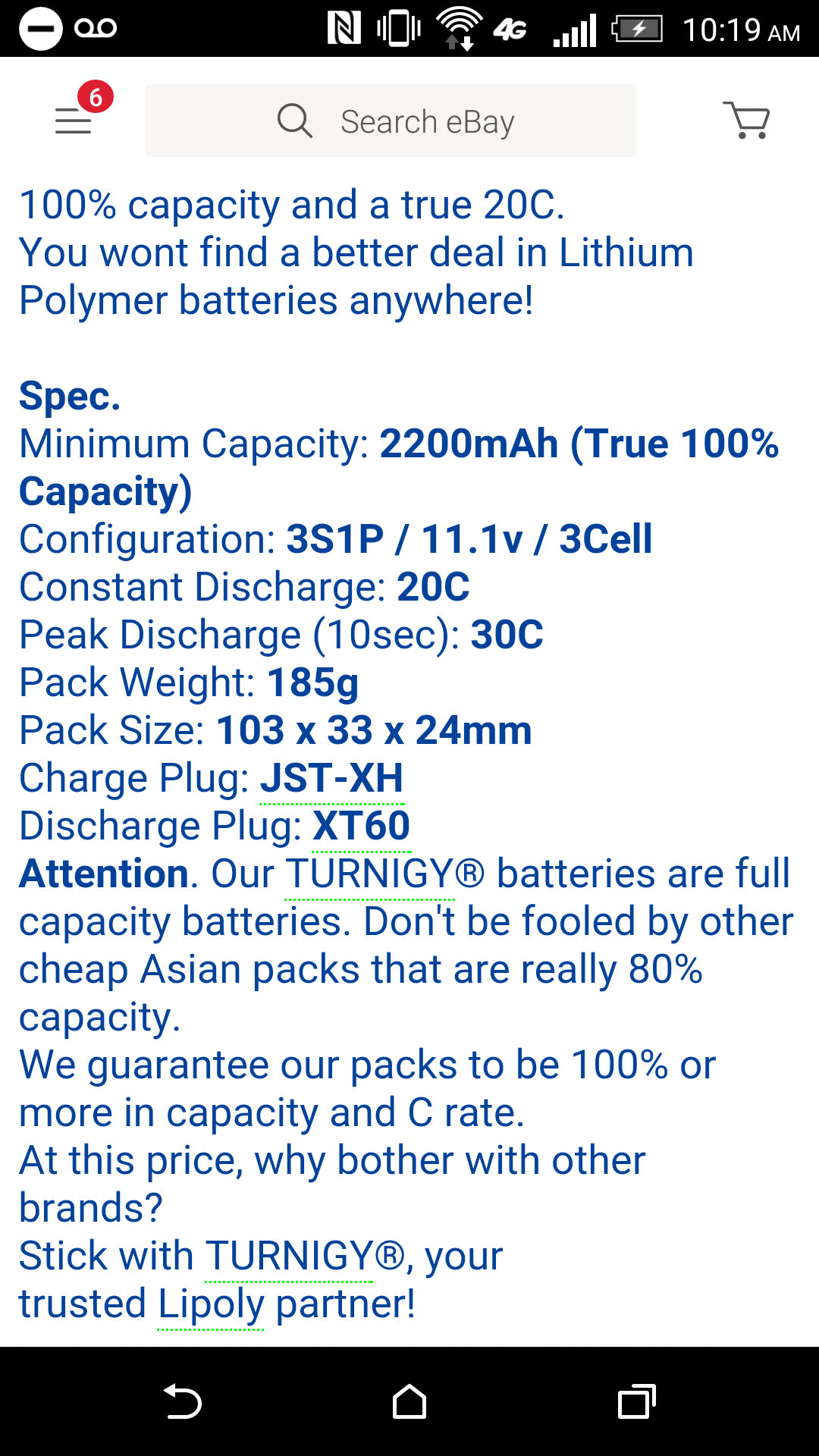

lalemandrew Posted December 2, 2015 Author Report Posted December 2, 2015 What does the discharge need to be on a battery to properly run the DNA 200 board and how do I figure out a battery discharge rate? Will this work
VapingBad Posted December 2, 2015 Report Posted December 2, 2015 20C is the rate, 20 X the capacity = 20 X 2.2 = 44 A
VapingBad Posted December 2, 2015 Report Posted December 2, 2015 Yes it is up to spec, the make is OK, but they do have to occasional misswired one, it is on the big side but they all will be if you want that capacity/
lalemandrew Posted December 2, 2015 Author Report Posted December 2, 2015 WHat A is the battery supposed to supply to boarx
VapingBad Posted December 2, 2015 Report Posted December 2, 2015 They are fine, I am using one, think of them as a reasonable value brand (the main brendon hoibbyking.com), as for the best brands IDK maybe an RC hobby site is a good place to look, if you are in the US and price is no prob Max Amps have a good range.
