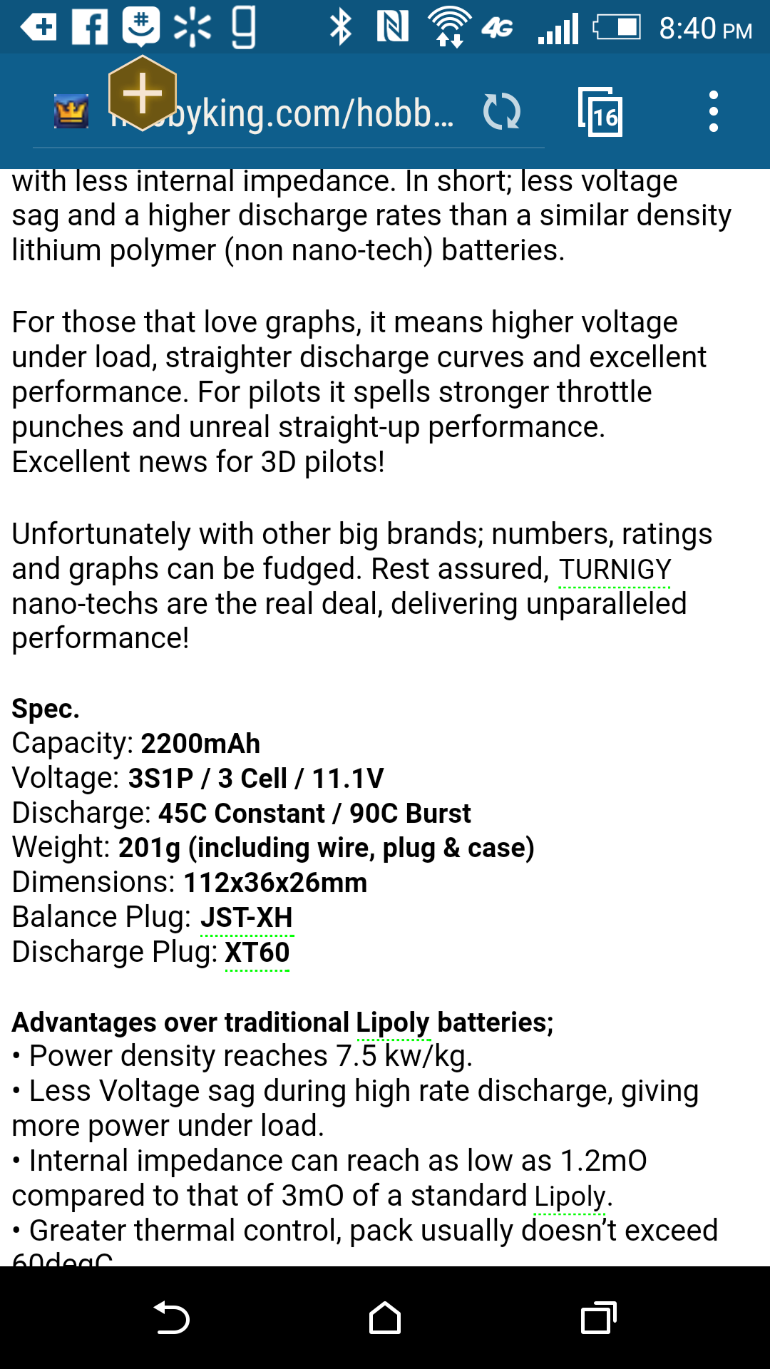

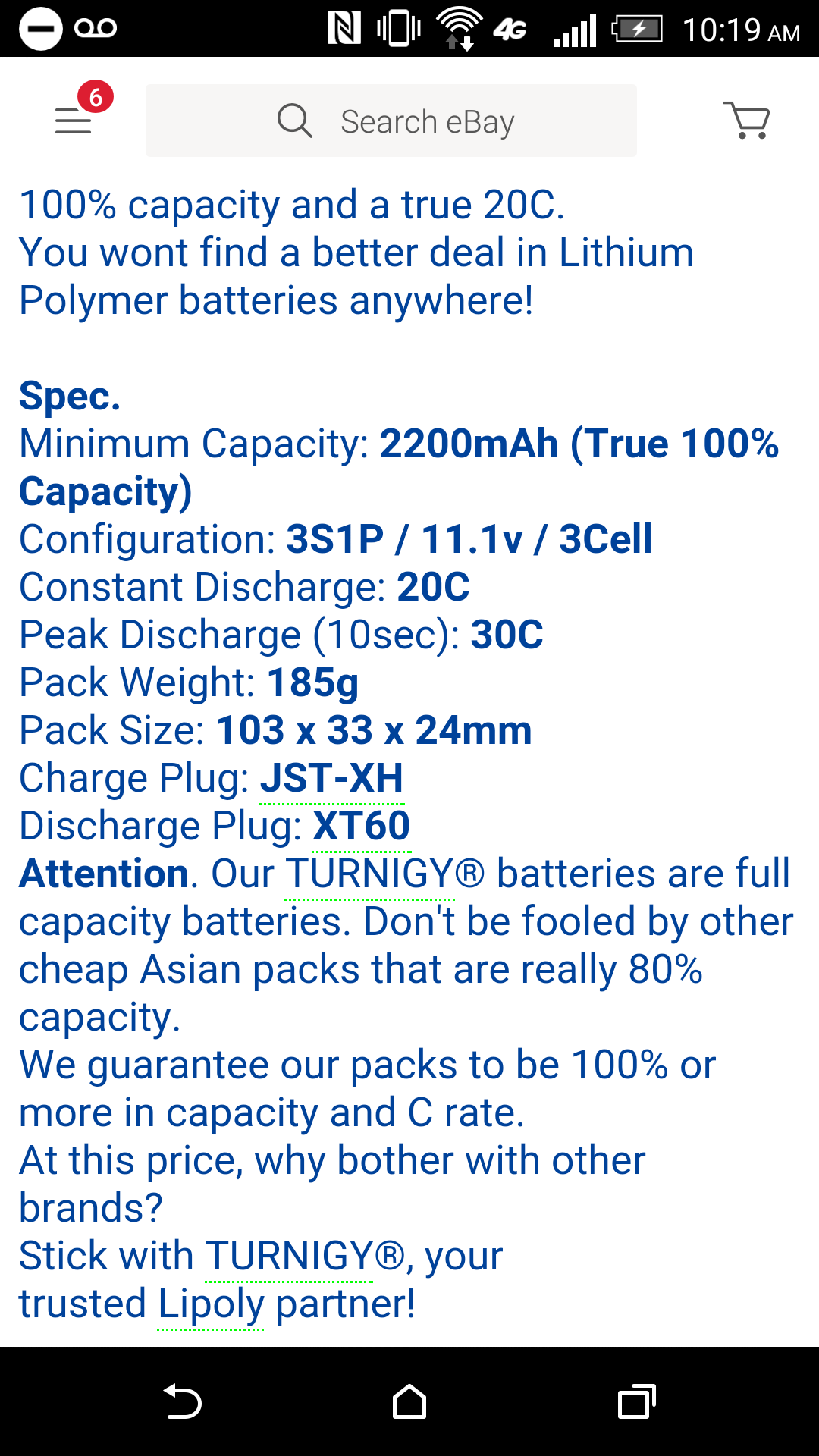

lalemandrew Posted December 3, 2015 Author Report Share Posted December 3, 2015 One of these work Link to comment Share on other sites More sharing options...
Jaquith Posted December 3, 2015 Report Share Posted December 3, 2015 lalemandrew said:One of these workBoth will work fine. 1. (2200 mAh / 1000) * 20C = 44A ; 2. (2200 mAh / 1000) * 45C = 99A both are 3S LiPo's w/balancer's (JST-XH), and 11.1V. Link to comment Share on other sites More sharing options...
