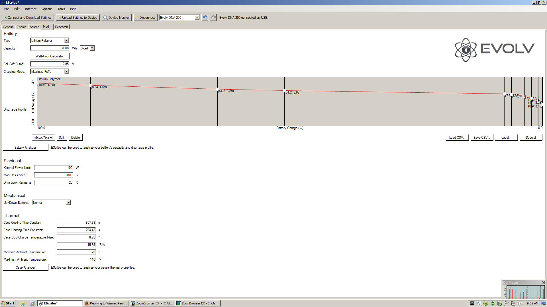

TrexWyo Posted November 26, 2015 Report Posted November 26, 2015 anaschillin said:I jus updated my firmware to latest from Wismec and using settings from them too. I have a issue at the moment. I am using Uwell Crown Tank with Ni 0.15 coils it doesn't seem to vape properly even when I crank it up to about 100 w @ 510 f. Theres minimal smoke and no nicotine hit. If I unlock the coil reading it reads the coil at 0.22 is that a problem or how do I fix it? If I reset back to original settings then it seems to vape fine but still reads the coil wrong at 0.15 Can anyone help me fix it? ReagrdsI had the same issue with Wismec's settings. For some reason it was causing an error with the "cold ohms" that resulted in a vape that was poorer than poor. What I did was install the latest Evolv firmware and used Wismec''s thermal settings until I had a chance to run my own thermal case analysis. It has been working great since. Your Crown tank resulting in a bad cold ohms is more likely caused by the Crown Atty static resistance, A incorrect "mod resistance" setting under the Mod Tab, or Unstable or erratic resistance in your coil build contacts. Attached is my current Mod settings.
anaschillin Posted January 6, 2016 Author Report Posted January 6, 2016 Sorry about the really late reply but it was due to a batch of dody coils.. Not had problems ever since upgraded to latest firmware and used config from Wismec website.
