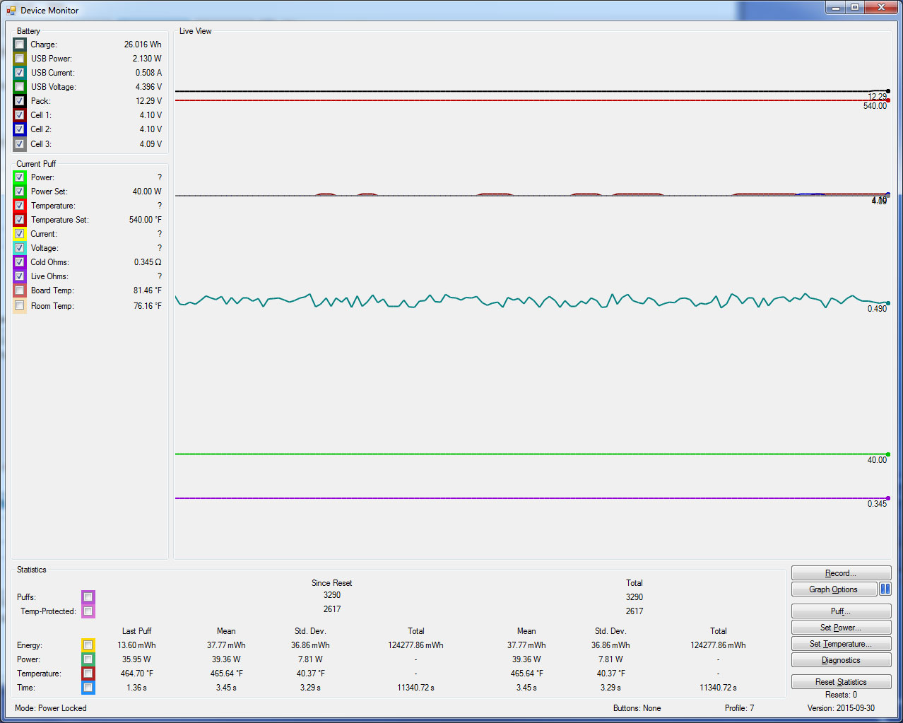

Jaquith Posted December 5, 2015 Report Share Posted December 5, 2015 Post a screenshot of your Device Monitor; see attached. I assume on your PC that you can charge, read live data, and obviously update your Mod. Further, I assume that your Mod is fully functioning when used for vaping. Link to comment Share on other sites More sharing options...
