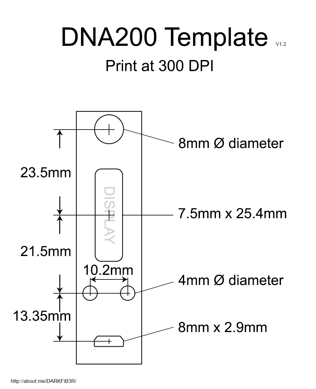

  1. Not really. I had to print off several copies at different zoom percentages and hold up to board to get closest fit. Once I found the size that matched up, it was easy sailing.
  2. I think this is what you mean when you say "cutting template". Hope it helps. DNA200_Cut_Template.pdf
