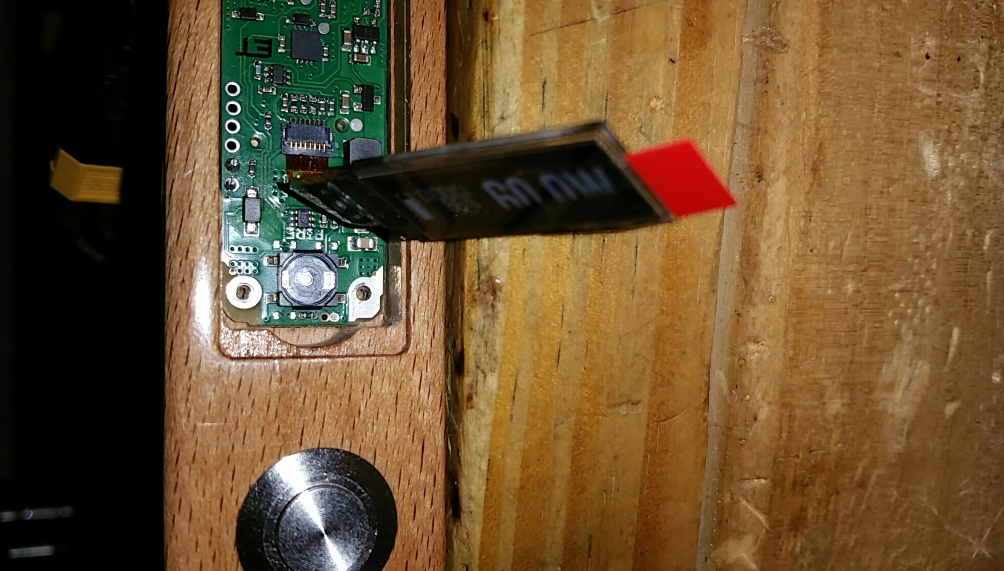

bnitch Posted March 10, 2016 Author Report Posted March 10, 2016 This is the 3rd time I changed wires.

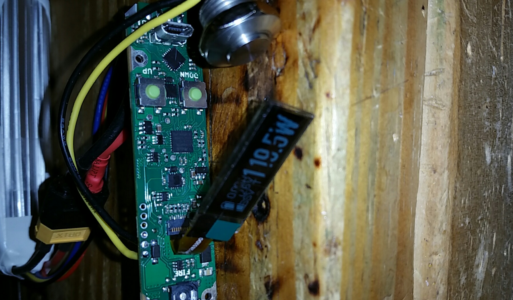

bnitch Posted March 10, 2016 Author Report Posted March 10, 2016 This is another board I have tried to hookup an off board switch to and it autofired till the screen froze or more like the board locked up. Could it be latest firmware? It also does the same thing with just the usb connected and no battery.
BobC Posted March 10, 2016 Report Posted March 10, 2016 Make very sure there isn't a single strand of wire from one connector port touching the other wire or port
bnitch Posted March 10, 2016 Author Report Posted March 10, 2016 I think it was the flux on the board.
