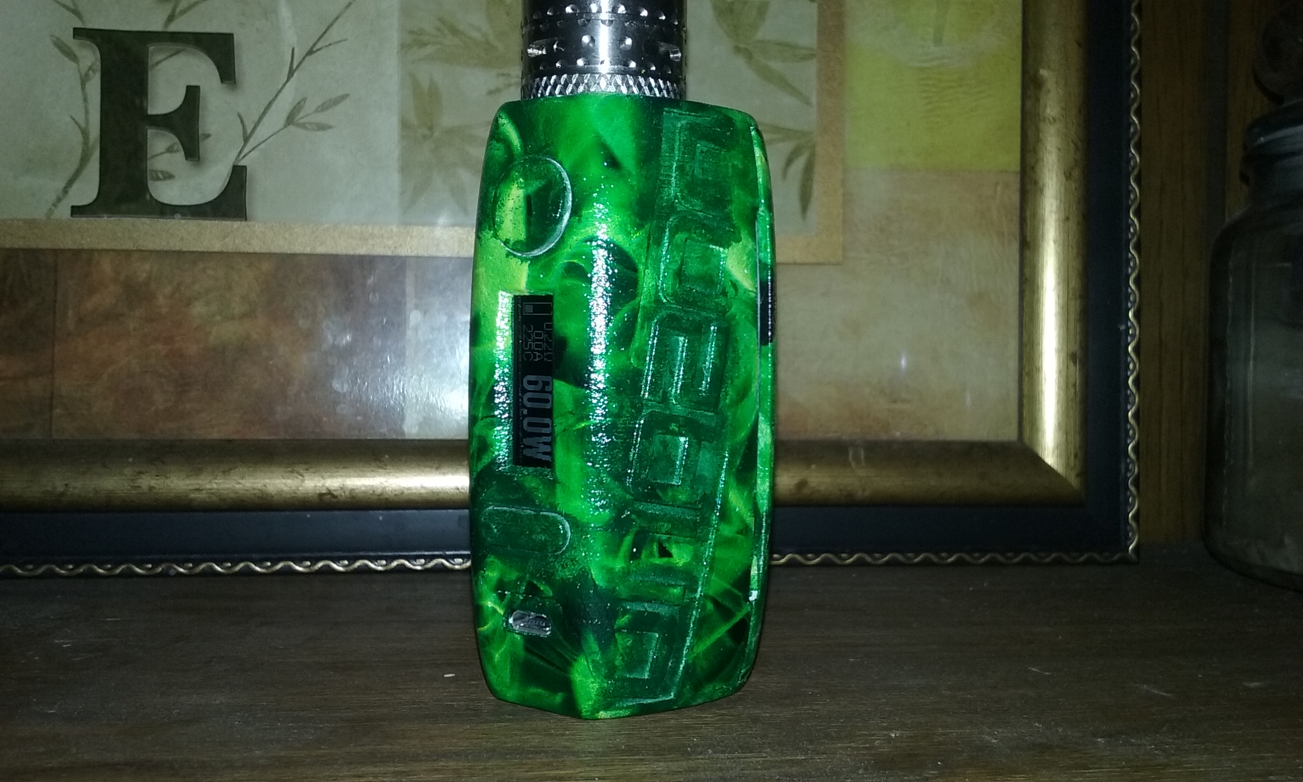

VapingModeration Posted May 3, 2016 Author Report Posted May 3, 2016 Yeah, I keep a DNA40 handy now for just such purposes. I can't say I'm happy that super subohmers won out over much less current hungry higher ohm builds. DNA's being able to fire a screwdriver isn't news to me. lolol.Either way, I have the perfect enclosure for the 75 that will be parallel 18650.
