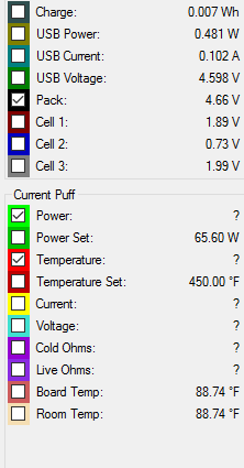

Cloudsville Posted May 3, 2016 Author Report Posted May 3, 2016 So my lavabox is having an issue (it wont vape) or do much of anything screen lights up on plug in but wont charge and my battery is out of wack. sad thing is i just bught a new lipo from volcano and within 5min of vaping my box did well this to it. my box has some.......green stuff on the bottom battery connection but idk how to clean it or take this box apart(i have a deeeeep fear of ruining anything on this pricy beastbut atm its a paperweight ALSO!!! i tried recovery charge idk if it was actually doing it cause nothing popped up :/
BillW50 Posted May 3, 2016 Report Posted May 3, 2016 Did you even charge the battery after receiving it? Off of the assembly line, lipos are usually about 40% charge. This is also the recommended charge state to store lipos. Although they lose 1 or 2% of their charge per month. It seems like at least your cells started out high enough because the DNA200 won't let you fire it if it wasn't within specs.Charging low cells is kind of tricky. I normally wouldn't do this for more than 10 minutes. But that is in EScribe and in the Device Monitor, Diagnostics (button), Advanced, and then Perform USB Recovery Charging. This will attempt to charge up very low cells which normally won't be chargeable.

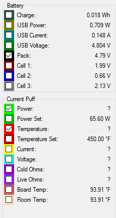

Cloudsville Posted May 3, 2016 Author Report Posted May 3, 2016 This is what i did and nothing I'm not sure its working but my real issue is my lavabox has done this to 2 different lipos from full charge to zip in about 4-6 min of vapingI'm running recovery charge atm and its rising slowly but surely i suppose
BillW50 Posted May 3, 2016 Report Posted May 3, 2016 Now I am getting concern. How warm is it where you are at? Device Manager states it is in the 90's there? Is this correct? And if possible, I would try to get all of the cells above 3.2v. And try the same with the other lipo. I also wouldn't leave it alone and touch it every few minutes to make sure it isn't getting too hot. If you can get this far, remove the battery and contact Volcano and get a RMA started. I am serious, I wouldn't trust it alone with batteries installed or plugged into the USB.
Cloudsville Posted May 3, 2016 Author Report Posted May 3, 2016 Yeah that is way off its 70 in my house and the box is cool to the touch ive seen people with the same problem just clean the board with iso but i have no idea how to get the board out OR IF I SHOULDi take electronics apart and fix them all the time but my mod is my baby Lol also I'm with the mod as we speak. there was a gu on this forum somewhere that had this issue and fixed it by cleaning a bit of juice off the board but like i said idk how it comes out and don't want do damage anything.
Cloudsville Posted May 3, 2016 Author Report Posted May 3, 2016 Update cell 2 is still at .68 and its been a while now / i wish something would let m know the recovery charge was active or not

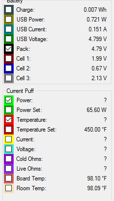

Cloudsville Posted May 3, 2016 Author Report Posted May 3, 2016 i got it out and cleaned it after air drying i got it all put together and the mid cell is finally going up (pretty quick too) fingers crossed but I'm thinking the problem is solved as i haven't seen the warranty screen nor the check battery as has been the norm for me heres a screenshot Not quite out of the woods yet but this the best its been so far
Spector NS5 RD Posted May 4, 2016 Report Posted May 4, 2016 Cloudsville said:i got it out and cleaned it after air drying i got it all put together and the mid cell is finally going up (pretty quick too) fingers crossed but I'm thinking the problem is solved as i haven't seen the warranty screen nor the check battery as has been the norm for me heres a screenshot Not quite out of the woods yet but this the best its been so fardo you have an actual multi meter to test individual cell voltages? i would do that. if all three are at the the same voltage (even) then you have some cleaning to do or you have a bad connection somewhere between batt and board. but i hope you got it straightened out with this cleaning.
