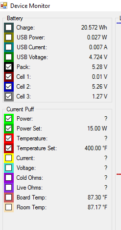

fredrogers Posted May 4, 2016 Author Report Share Posted May 4, 2016 Well I got home and tried again to get my EFusion Duo to use 2 18650s. I had the exact same experience. I tested the batteries with my multi-meter and they both read 4.21. I put the batteries in the sled and tested the voltage coming off the large red/black power leads: 8.41.I then put the sled in the mod and pulled up EScribe and changed the battery config under the Mod tab. I uploaded the settings then inserted the batteries and checked out the device monitor: I then tried to vape and the device "rebooted" again then the screen went dark. It would flash the welcome logo and then go black ever time I pressed the fire button.I plugged it back in to EScribe and did a soft reboot and opened up device monitor again: I am at a lost. I put back in the lipo pack, adjusted the battery settings back to 3 cell under Mod, and I am vaping like a champ. What do I need to do? Is it the board? The sled? The batteries?-=fred=- Link to comment Share on other sites More sharing options...

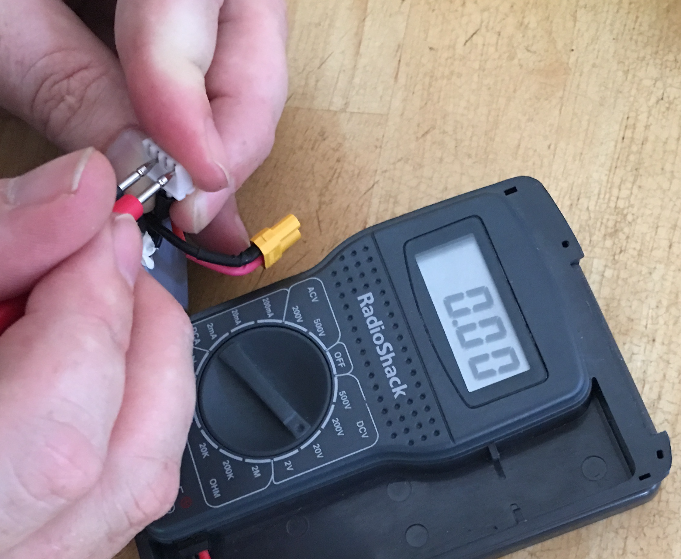

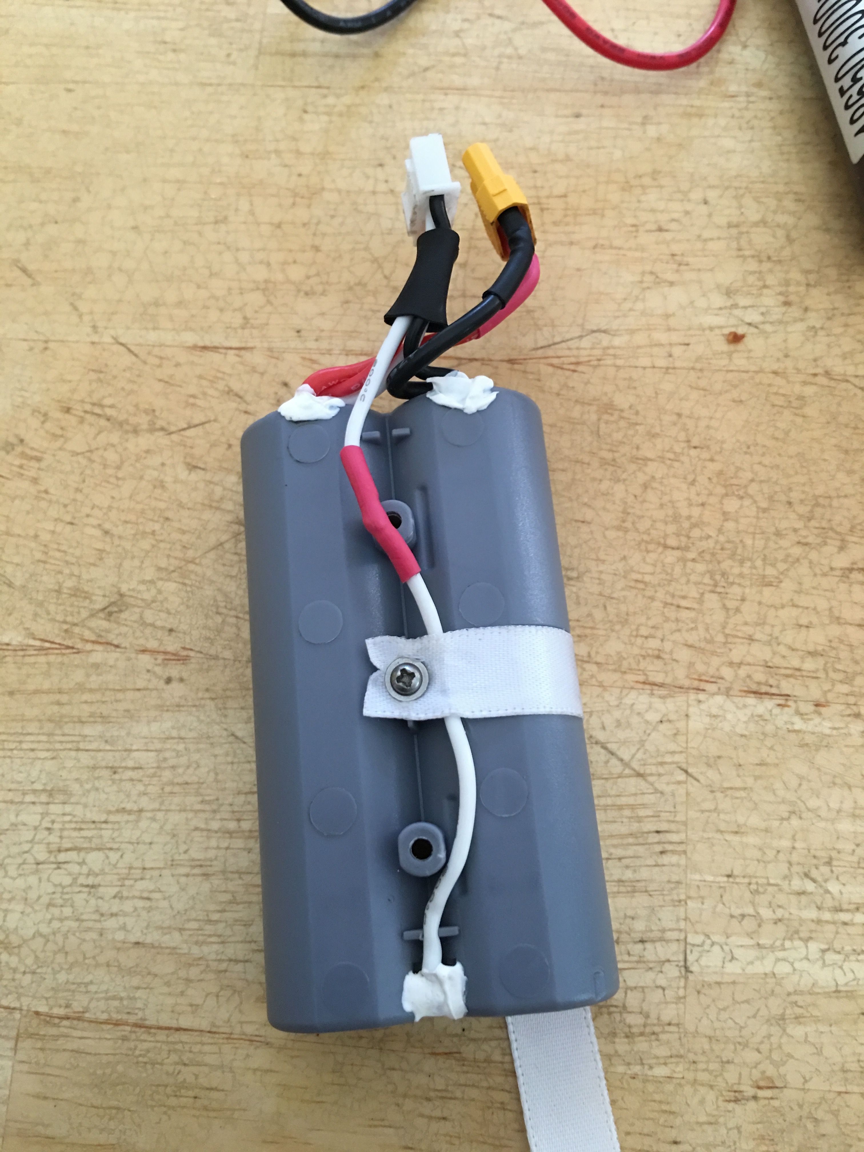

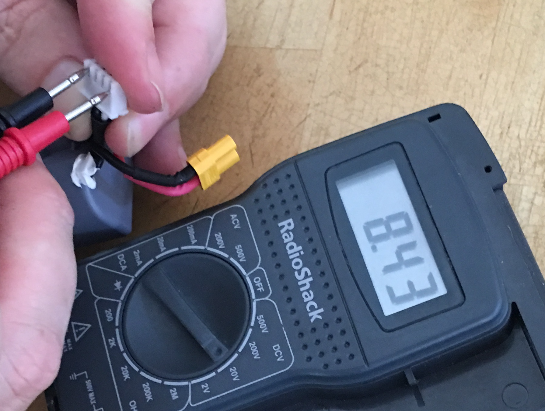

fredrogers Posted May 4, 2016 Author Report Share Posted May 4, 2016 Well I think I found it. Here is how I am labeling the JST for ease of reading: When I try to test for connectivity from the 3 pin (counting from left to right starting with the positive lead) to the connector plate at the bottom of the battery sled it is open. When I test with the batteries installed in the sled I get 8.4 on the main power leads and 8.4 on 1 and 4: But when I try 1 and 3 I get 0: I think the culprit may be a wire splice on the back of the sled: Or possibly the solder joint at the bottom. Assuming that is the issue, I just need to decide it I want to try my luck with a warranty or just repair it myself. But if there is something I am missing in my testing please let me know. Thanks!-=fred=- Link to comment Share on other sites More sharing options...
BillW50 Posted May 4, 2016 Report Share Posted May 4, 2016 Hey Fred, that last picture of the battery sled and plugs. Can you take another image so I can see the wires on the sled and which pins they go to? Well I guess you can tell me too. What I see is...1) Blk goes what you are calling pin 4 (it is really pin 1, but that is ok. We will use your numbering.)2) Wht goes to pin 33) And I can't see what is connected to pin 1 and 2. I assume two reds goes somewhere but I can't see. Does one go to pin 1 and the other red goes to pin 2?If that is right, ohm between pin 1 and 2 and they should be connected together and ohm a short. Link to comment Share on other sites More sharing options...
BillW50 Posted May 4, 2016 Report Share Posted May 4, 2016 EScribe is showing cell 1 isn't right. That should be between the black and white wire. You should read one battery between them. Between white and red would be another battery (cell 2). But it does seem that that white wire is open somewhere, probably where it was spliced.On that side of the battery sled, that white should be connected to both posts on that side. You could ohm it and make sure it is. Also ohm both posts on that side, they should be shorted together.P.S. Pull out the batteries when you start to ohm on the lowest range. Short the test leads together to test it can read a short. Link to comment Share on other sites More sharing options...
fredrogers Posted May 4, 2016 Author Report Share Posted May 4, 2016 BillW50 said: Hey Fred, that last picture of the battery sled and plugs. Can you take another image so I can see the wires on the sled and which pins they go to? Well I guess you can tell me too. What I see is...1) Blk goes what you are calling pin 4 (it is really pin 1, but that is ok. We will use your numbering.)2) Wht goes to pin 33) And I can't see what is connected to pin 1 and 2. I assume two reds goes somewhere but I can't see. Does one go to pin 1 and the other red goes to pin 2?If that is right, ohm between pin 1 and 2 and they should be connected together and ohm a short. Expand 1) Sorry I was not sure how to refer to the different pins. 2) Yes, that white wire goes to the connector plate at the bottom of the sled. When I try to ohm it out from the plate to the pin in the JST I get an open.3) There are 2 red wires that connect to the top positive of the sled. When I test them the are shorted. I took the pics over my lunch so I will have to get a better pic after I get home. -=fred=- Link to comment Share on other sites More sharing options...

BillW50 Posted May 4, 2016 Report Share Posted May 4, 2016 That is okay about the pin numbers. It is really numbered like this starting with the black wire.GND (black), 1 (white), 2 (red), 3 (red).The first pin they really call ground and not pin 1. I thought that was funny Evolv labeled it that way. And yes, if that white wire doesn't ohm through, that is it. Link to comment Share on other sites More sharing options...

fredrogers Posted May 4, 2016 Author Report Share Posted May 4, 2016 dwcraig1 said: Can't you check it for continuity? Expand Yes I did. Using the diagram you posted, thank you again , I checked all of the wires and the white wire is the weak link. It show an open from the pin to the sled. I am suspecting the splice you can see in in the pictures I posted. All of the other wires have good connection to where they need to go. -=fred=- Link to comment Share on other sites More sharing options...
