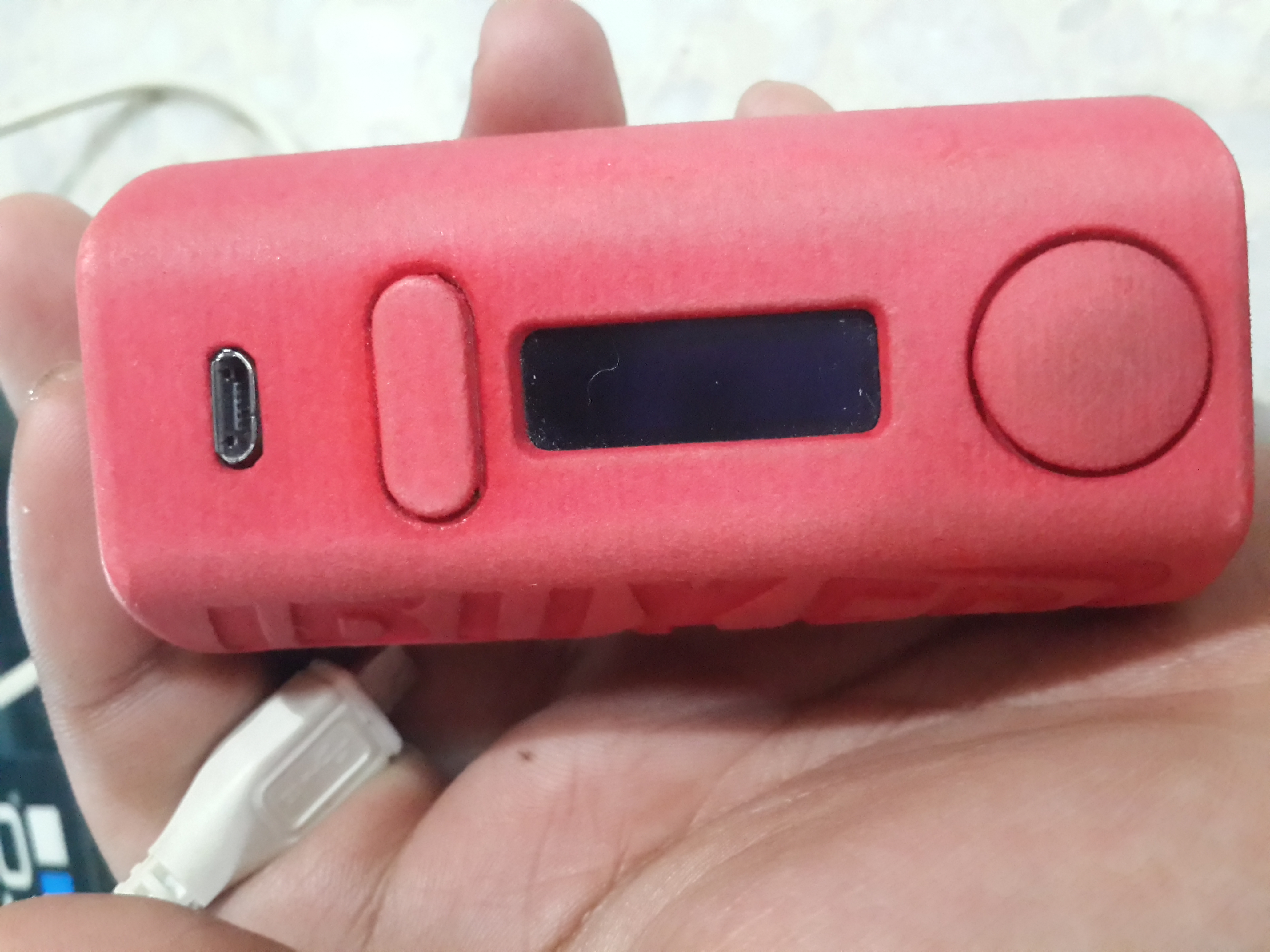

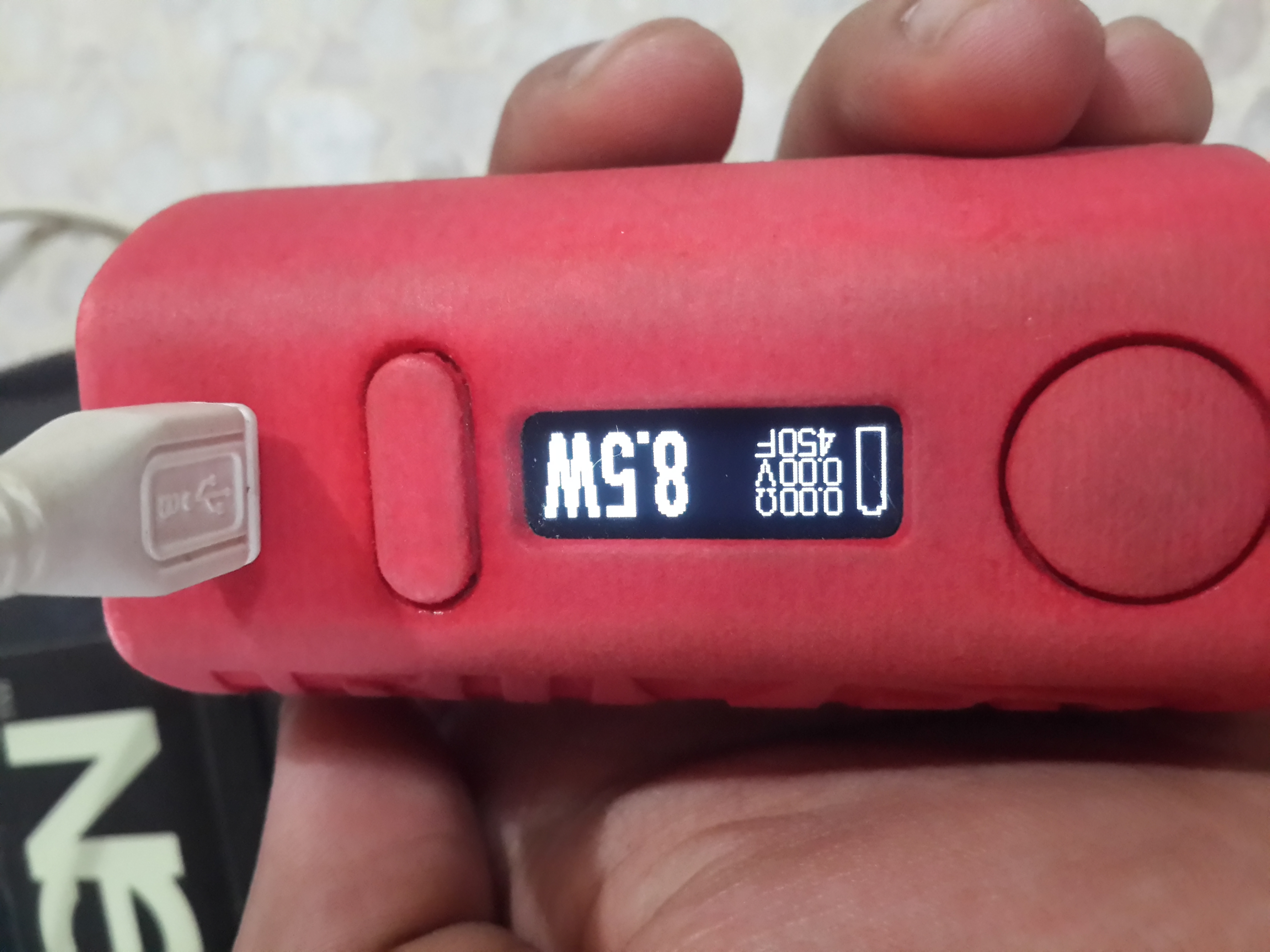

SyafiqSheafi Posted May 31, 2016 Author Report Posted May 31, 2016 When i plug my boxer dna 200 my screen on but not charging . When i unplug the cable it cannot turn on . It happen after i change setting on escribe . How to settle my problem ? I try to hard reset but command issue
SyafiqSheafi Posted May 31, 2016 Author Report Posted May 31, 2016 Only turn on when plug cable into pc but not charging . Help me pls

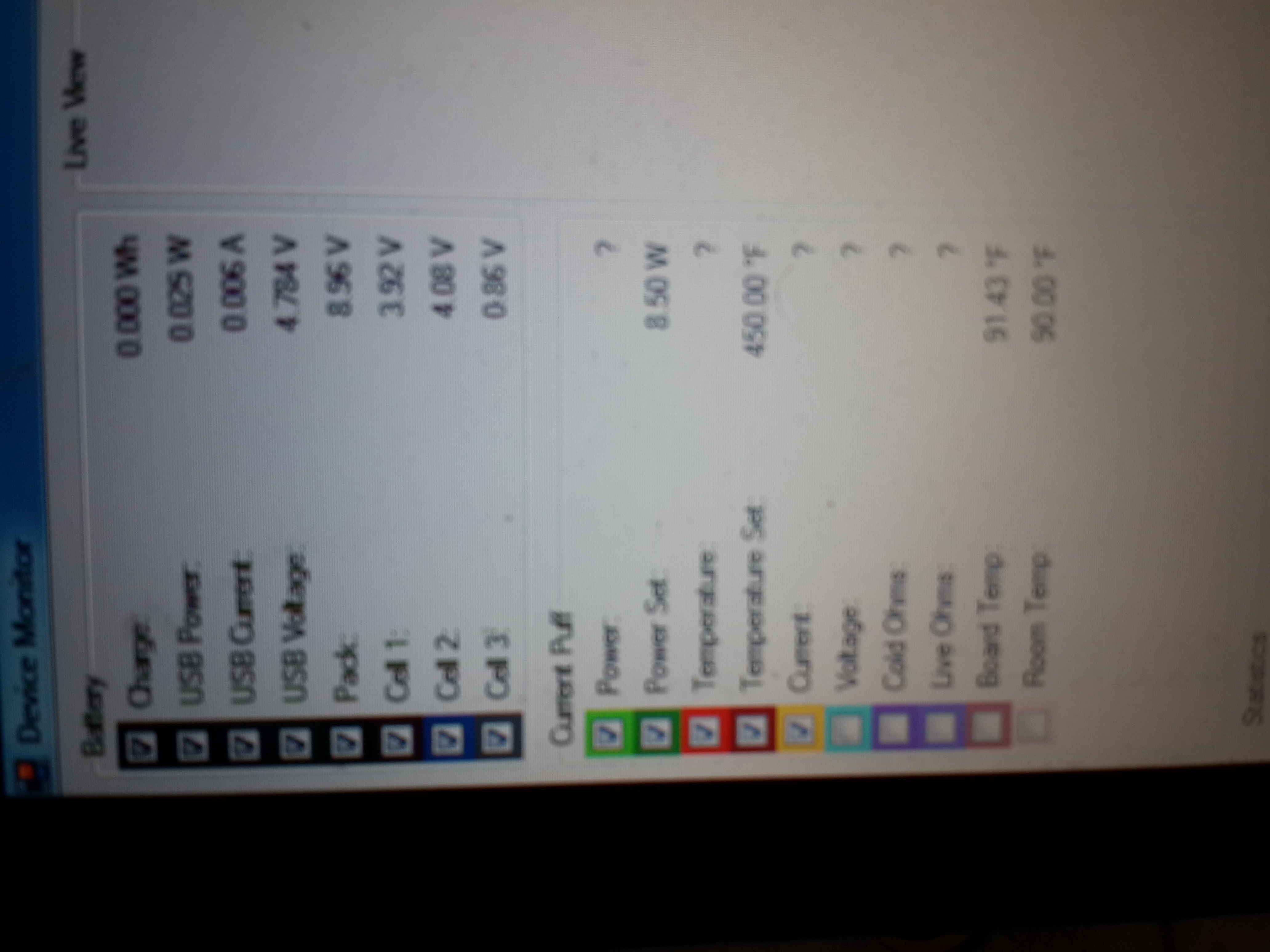

mikepetro Posted May 31, 2016 Report Posted May 31, 2016 Look at your cell #3. Unplug the battery, or at least the JST connector and manually measure the cells. If cell #3 is truly 0.8v then replace the battery.If cell #3 is more/less normal then RMA the board.While battery is out check the fuse.I hade one very similar, and the battery worked in another mod just fine. Mine looked like this and fuse was good, I RMAd the bard.

black lace Posted May 31, 2016 Report Posted May 31, 2016 am pretty sure that when connected into escribe, 1, select power from the battery drop down list, 2, with batteries removed, will it fire an atty,3, if not you have confirmed a blown fuse..your mod is saying that, that particular battery is dead flat according to the screen, (so you cant expect much to be happening)I would try charging it via an external charger conditioner before condemning it, just incase.
