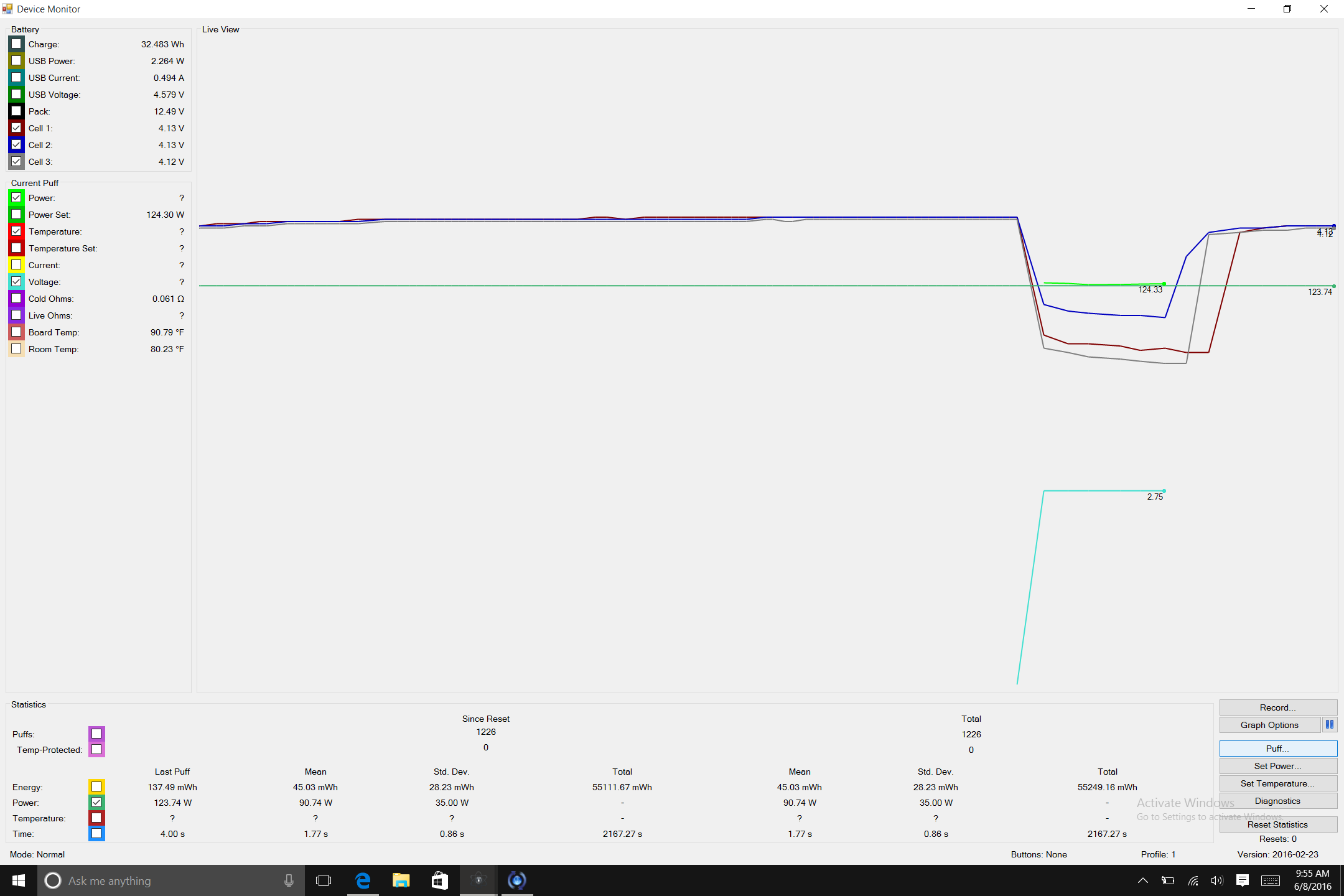

BillW50 Posted June 8, 2016 Report Share Posted June 8, 2016 And you can see the wattage drop on the display or you can tell that the wattage drops by the vape? Can you post a snapshot from the Device Monitor showing the pack voltage, power, voltage, and live ohms while it is firing? Link to comment Share on other sites More sharing options...
mattant19 Posted June 8, 2016 Author Report Share Posted June 8, 2016 wattage drop on both display and actual vape ... i will post the screen shot when i get to work Link to comment Share on other sites More sharing options...

Nick Posted June 8, 2016 Report Share Posted June 8, 2016 I would guess that your build is just a bit too low and you are hitting one of the output limits after you put the mod down, it cools completely, and the resistance of the coil drops. Once its warm and you reset the mod it re-reads it as a higher resistance.Check the DNA200 spec sheet below (Pg. 4) for the "DNA 200 Kanthal Power" graph. Based on what Device Monitor is saying the resistance of your coil is it looks like it would drop you down to the wattage you are seeing.http://evolvapor.com/datasheet/dna200.pdf Link to comment Share on other sites More sharing options...
