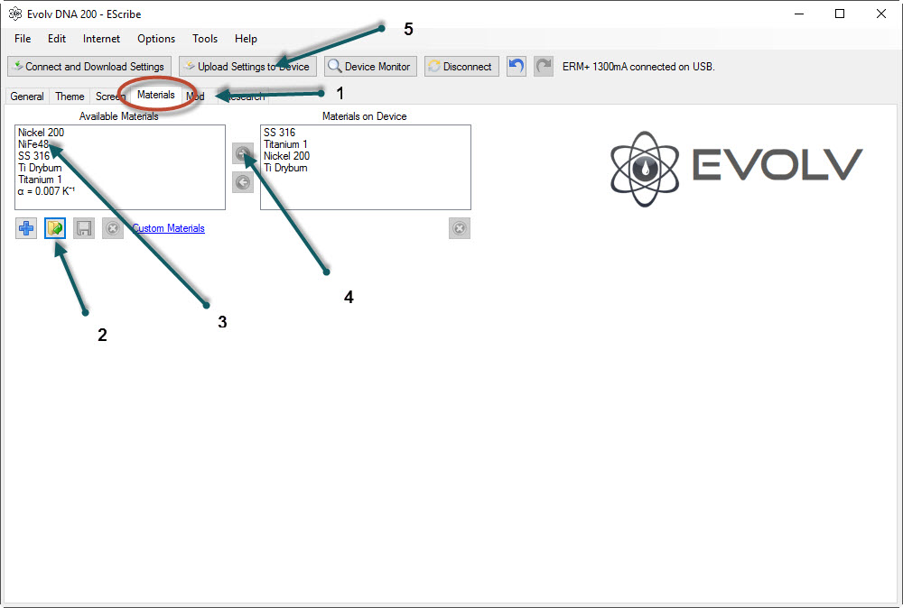

kingdal Posted June 9, 2016 Author Report Posted June 9, 2016 Hi guysFirst time DNA200 user here. I was trying to figure out how to set up custom wire (Nife48) on both an eFusion Duo and a Boxer 133w. Looking at the eScribe tutorial, it shows to go to a Preset, click the wire type and choose Custom, and from there you can upload a CSV file. My problem is, I don't have that Custom option. When I click on a Preset, it shows Nickel, SS316 and Ti and that's it. No Custom.I'm running eCcribe 1.0.42. What am i missing?Thanks
dwcraig1 Posted June 9, 2016 Report Posted June 9, 2016 kingdal said:Hi guysFirst time DNA200 user here. I was trying to figure out how to set up custom wire (Nife48) on both an eFusion Duo and a Boxer 133w. Looking at the eScribe tutorial, it shows to go to a Preset, click the wire type and choose Custom, and from there you can upload a CSV file. My problem is, I don't have that Custom option. When I click on a Preset, it shows Nickel, SS316 and Ti and that's it. No Custom.I'm running eCcribe 1.0.42. What am i missing?ThanksGo here, select your wire, use DNA200 tab. add to EScribe, add to device, upload to device.Use any browser except Internet Explorerhttp://www.steam-engine.org/wirewiz.asp(working from the materials tab)
kingdal Posted June 9, 2016 Author Report Posted June 9, 2016 Hey dwcraig, thanks for the reply. Yep I did all you suggested. My problem is I can't find where in eScribe I can upload a csv file (I guess that would be the "add to eScribe" part in your post). Every video I see shows people clicking on Presets, then moving down to wire type, choosing and clicking Custom. When I do that, I don't have the Custom option. The list shows Nickel, SS 316, Titanium and then it ends. So I don't know what is wrong. Is my version of eScribe not working properly (I just uninstalled, re-downloaded and reinstalled eScribe -- same problem)? Is this some kind of limitation by the mods? Is there some kind of setting I have to choose to enable a Custom wire option? Because I'm not seeing it.As a workaround, I tried going to the Materials tab and creating a new wire type. I was able to do that but it only allows a TCR value to be keyed in. I still don't see where I can upload a CSV file. Any advice would be really appreciated. Thanks
kingdal Posted June 9, 2016 Author Report Posted June 9, 2016 Just to add, its the same problem as this post, except I would like to be able to upload a CSV filehttps://forum.evolvapor.com/topic/66958-topic/?do=findComment&comment=902439Thanks
dwcraig1 Posted June 9, 2016 Report Posted June 9, 2016 kingdal said:Just to add, its the same problem as this post, except I would like to be able to upload a CSV filehttps://forum.evolvapor.com/topic/66958-topic/?do=findComment&comment=902439ThanksThe post linked was answered correctly.
kingdal Posted June 9, 2016 Author Report Posted June 9, 2016 Indeed. Very well done . I think that answered my question.Thank you both very much!
