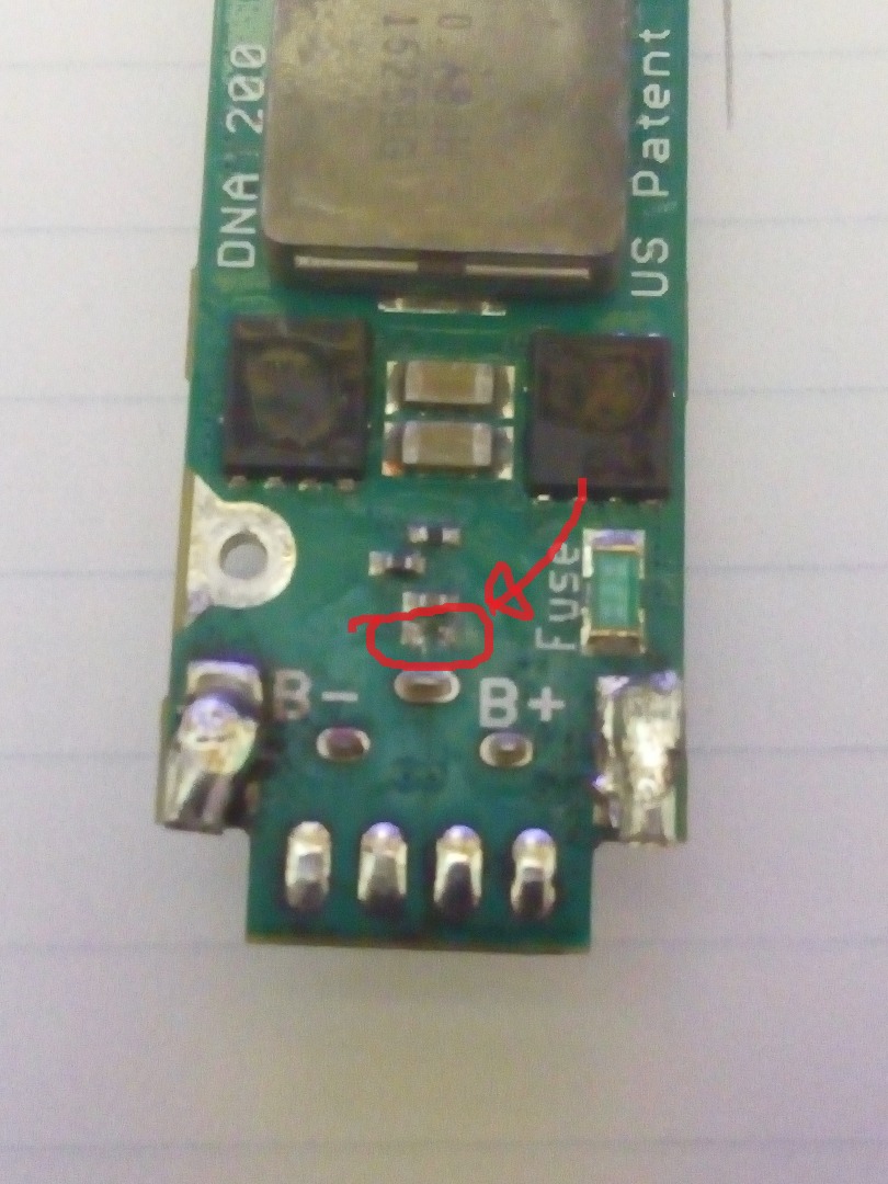

Deftones161 Posted August 14, 2016 Author Report Share Posted August 14, 2016 Hello everyone, i had a question. Could anyone tell me what the component is that is missing from the photo? i must have overheated the board while soldering and it came loose. I got everything soldered together and at first, it said "shorted" when i tried to test an atty. I unplugged my battery, checked the balance connections and B- and B+, then both gnd and out pads. Everything looked solid after I touched it up with the iron. Once I plugged the lipo back in, it sparked and I immediately removed the lipo. Now its totally dead when I plug it into my pc. I had pins 2 and 3 jumpered because I'm using a 2s lipo with a 3 pin JST balance plug. The board came out of a realeaux if that makes any difference.I ended up just buying a new mod instead of building one. Any help would be greatly appreciated! Link to comment Share on other sites More sharing options...
Spector NS5 RD Posted August 14, 2016 Report Share Posted August 14, 2016 Deftones161 said:Hello everyone, i had a question. Could anyone tell me what the component is that is missing from the photo? i must have overheated the board while soldering and it came loose. I got everything soldered together and at first, it said "shorted" when i tried to test an atty. I unplugged my battery, checked the balance connections and B- and B+, then both gnd and out pads. Everything looked solid after I touched it up with the iron. Once I plugged the lipo back in, it sparked and I immediately removed the lipo. Now its totally dead when I plug it into my pc. I had pins 2 and 3 jumpered because I'm using a 2s lipo with a 3 pin JST balance plug. The board came out of a realeaux if that makes any difference.I ended up just buying a new mod instead of building one. Any help would be greatly appreciated! welcome to the forum Deftones161. you're missing a resistor. you would of had to of gotten the board extremely hot in order for a component to fall off. if you find it you can try and solder it back yourself. if you can't, open a help ticket with evolv from their website. Link to comment Share on other sites More sharing options...
Deftones161 Posted August 14, 2016 Author Report Share Posted August 14, 2016 I had my fiance solder it. She does that for a living. She said that my solder tip was garbage and that she had to hold the solder to it for longer than it should have been. It wouldn't surprise me if it got hot enough to fall off. i opened up a ticket on friday and i'm just waiting for a response from them. i wish i could find the part, but its just so tiny. I'm wondering how much it would cost to have it fixed. Link to comment Share on other sites More sharing options...
Spector NS5 RD Posted August 14, 2016 Report Share Posted August 14, 2016 Deftones161 said:I had my fiance solder it. She does that for a living. She said that my solder tip was garbage and that she had to hold the solder to it for longer than it should have been. It wouldn't surprise me if it got hot enough to fall off. i opened up a ticket on friday and i'm just waiting for a response from them. i wish i could find the part, but its just so tiny. I'm wondering how much it would cost to have it fixed. smd components that are coming out keep getting smaller and smaller, lol. evolv is great about helping people out with warranties and even if the damage is.........self inflicted. my guess is you'll be very happy with their response. i've sent back a few boards i managed kill. they've taken VERY good care of me. Link to comment Share on other sites More sharing options...

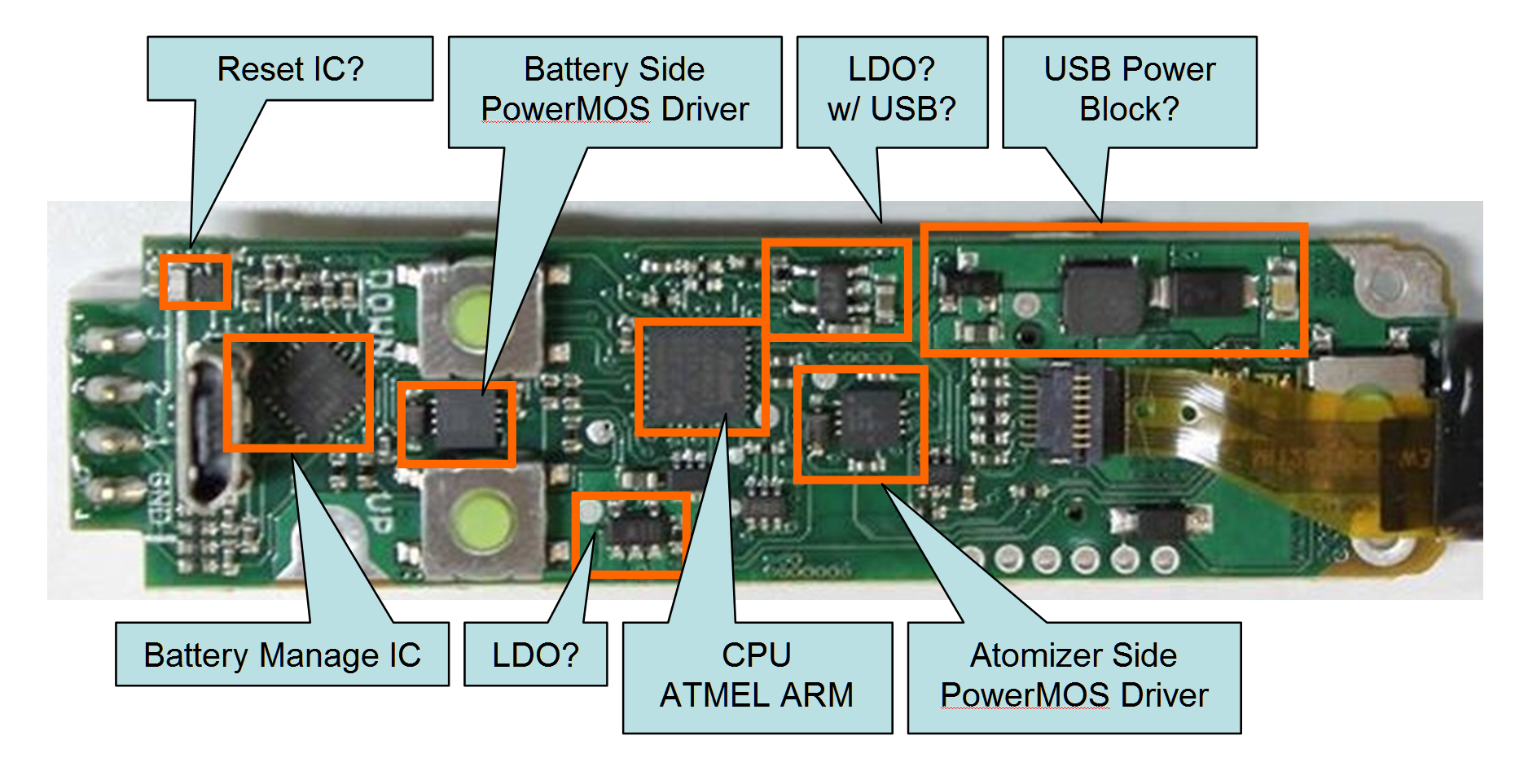

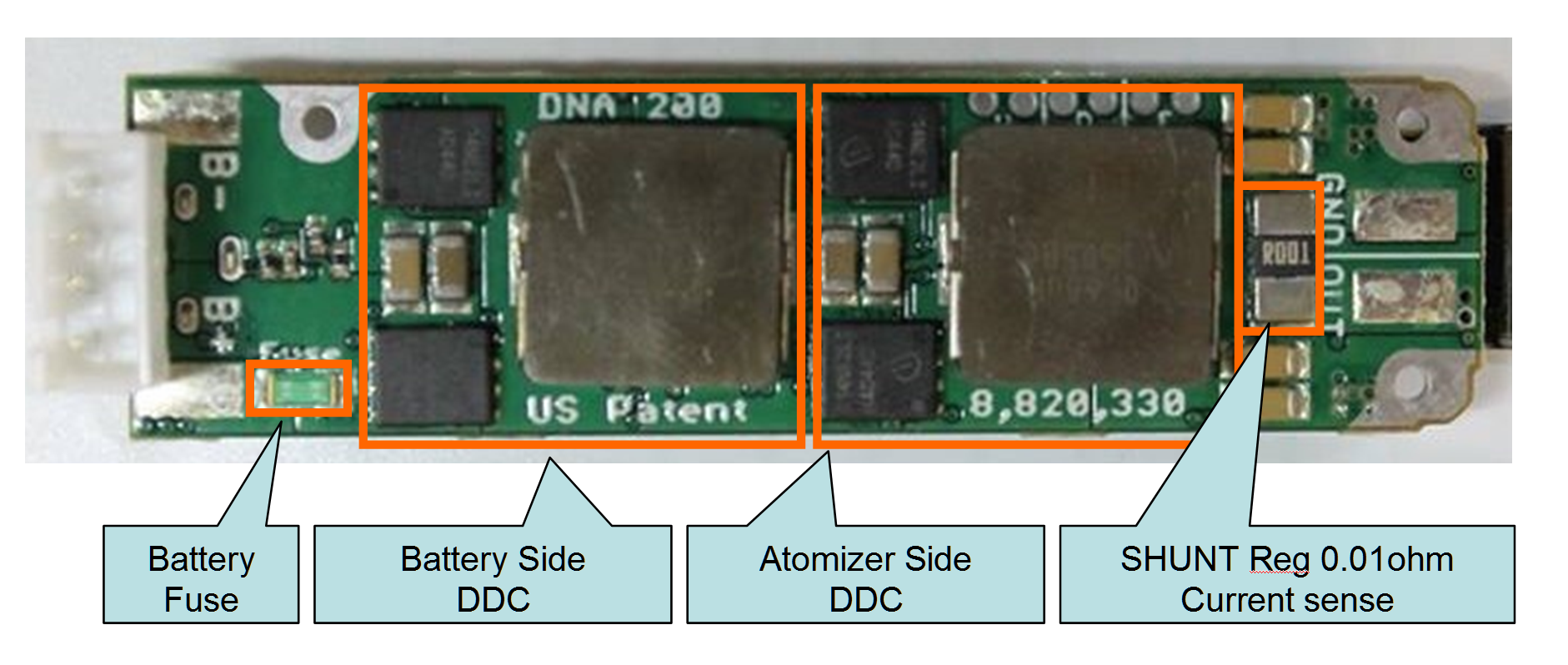

Modbustersecig Posted August 28, 2016 Report Share Posted August 28, 2016 Here are some pics I found on this site helps to identif some of the components if you could post a pic of the future up the board I am working on a though process with a Little Help from My Friends I would be thankful .I am not affiliated with evolv in any way . evolve is very good about there warranty head on over to there website contact customer service I am always bugging them good bunch Link to comment Share on other sites More sharing options...
