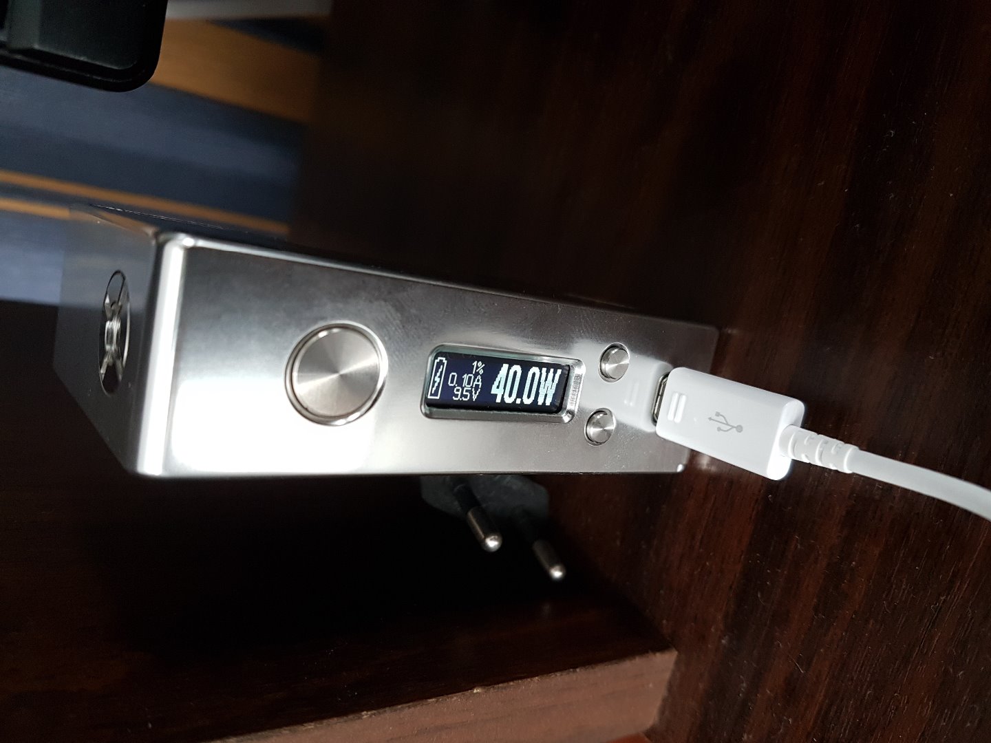

dhackwrench Posted September 14, 2016 Author Report Share Posted September 14, 2016 Hello! I am sorry for bad english . My Mod included stopped when the battery is inserted( black screen) , but when connecting it to a computer via USB, it is switched on and write error Check Atomizer. What do I do , please help . Thank you. I am from Russian Federation. Link to comment Share on other sites More sharing options...

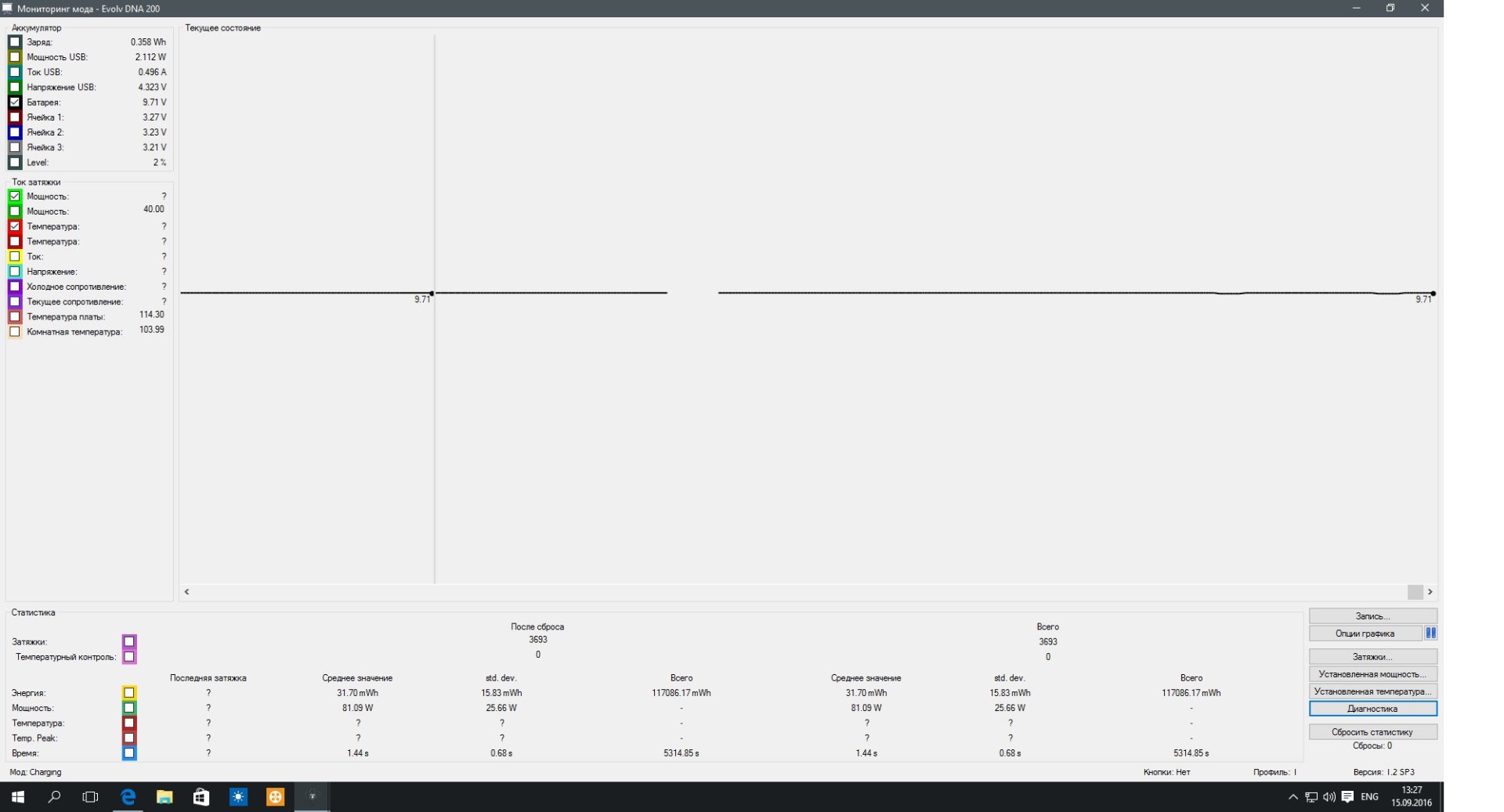

Spector NS5 RD Posted September 14, 2016 Report Share Posted September 14, 2016 Hi dhackwrench...... can you post a screen shot of device monitor with all of the "Battery" options checked. let's see what your cell voltages are at. it will connect to escribe with the lipo battery installed, right? Link to comment Share on other sites More sharing options...
dhackwrench Posted September 15, 2016 Author Report Share Posted September 15, 2016 ChunkyButt200 said: Hi dhackwrench...... can you post a screen shot of device monitor with all of the "Battery" options checked. let's see what your cell voltages are at. it will connect to escribe with the lipo battery installed, right? Expand lipo battery and 2x18650 and not working Link to comment Share on other sites More sharing options...
VapingBad Posted September 15, 2016 Report Share Posted September 15, 2016 That looks like the batteries were empty and are now charging OK, wait until the battery is over 10.5 V with the cell voltages of 3.5 V and check again. Link to comment Share on other sites More sharing options...

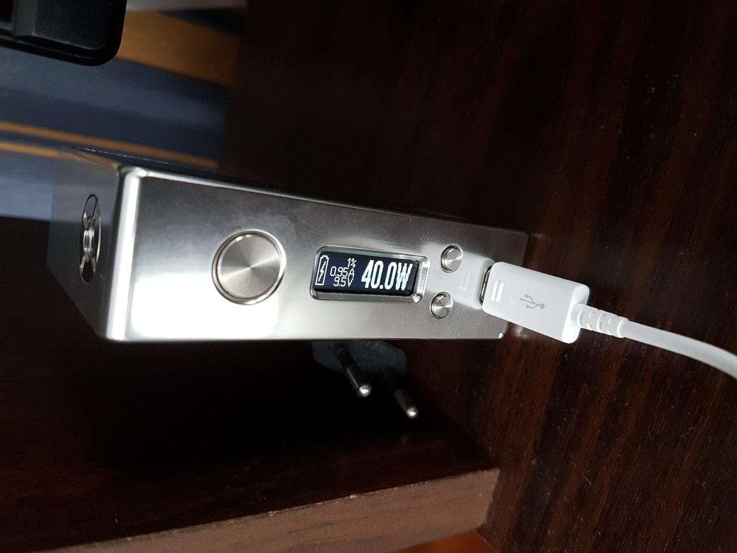

dhackwrench Posted September 15, 2016 Author Report Share Posted September 15, 2016 VapingBad said: That looks like the batteries were empty and are now charging OK, wait until the battery is over 10.5 V with the cell voltages of 3.5 V and check again. Expand thanks, but 18650 is fully charger and mod not working. Now charge the mod , the voltage drops from 0.96 to 0.10 and back. also can't remember the percentage of battery. Link to comment Share on other sites More sharing options...
