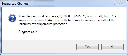

EndraDAce Posted October 12, 2016 Author Report Posted October 12, 2016 it says "Your device's mod resistance, 0.100006103515625 , is unusually high. Are you sure it is correct? An incorrectly high mod resistance can effect the reliability of temperature protection. Program as-is?"
txmonkey214 Posted October 12, 2016 Report Posted October 12, 2016 What wattage do you have it set at? If you're vaping at a very high wattage setting, this is probably correct.
VapingBad Posted October 13, 2016 Report Posted October 13, 2016 In EScribe Options - User Interface choose Manufacture then go to the mod tab and set the mod resistance to 0 and you should be OK.
EndraDAce Posted October 13, 2016 Author Report Posted October 13, 2016 txmonkey214 said:What wattage do you have it set at? If you're vaping at a very high wattage setting, this is probably correct.Nope, around 30w
EndraDAce Posted October 13, 2016 Author Report Posted October 13, 2016 VapingBad said:In EScribe Options - User Interface choose Manufacture then go to the mod tab and set the mod resistance to 0 and you should be OK.oh yes. Thankyou very much. it worked.but should i left it at 0 ??
VapingBad Posted October 13, 2016 Report Posted October 13, 2016 EndraDAce said:oh yes. Thankyou very much. it worked.but should i left it at 0 ??0 is fine and much better than too high. At very low resistances or very high wattages you may notice the difference between 0 and the correct value for your mod, but it will still vape well only the watts and temp values may be a little out. I don't know what your value should, all of mine are 0.003 or 0.002 ohms.
