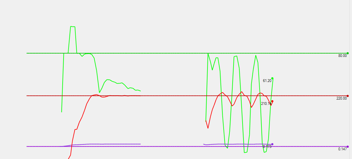

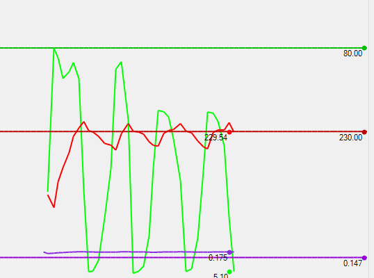

Two coils in parallel, fused clapton, core 2 x SS316L 26ga, wrap NiCr 80/20 38ga.
??nk resistance is 0.15 Ohms
This setup works well on Sigelei 213.
But I have problems with DNA200 and this setup.
I tested different SS and NiCr (same thickness, 26 and 38 ga) with the same result.
I use material profile generated by steam-engine.
What do I do?
