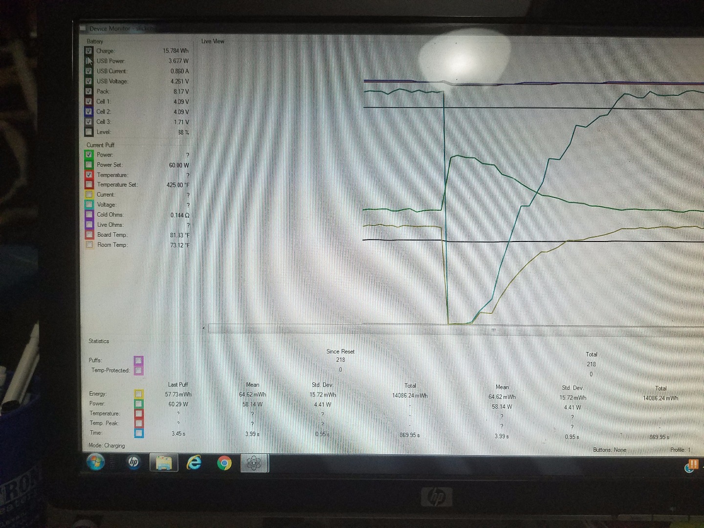

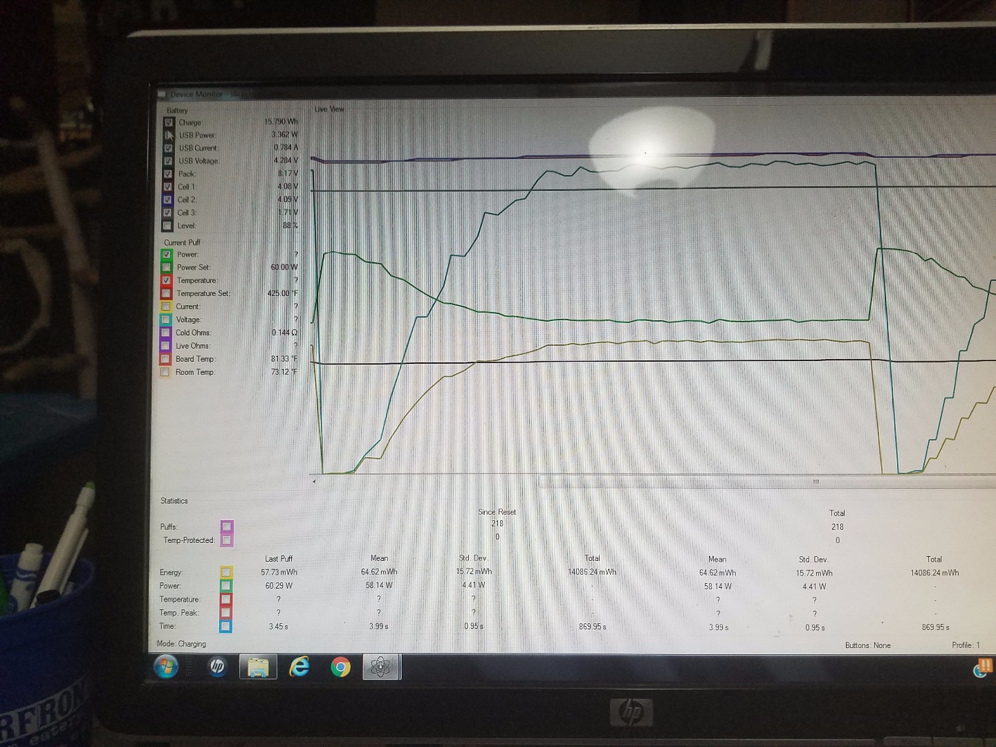

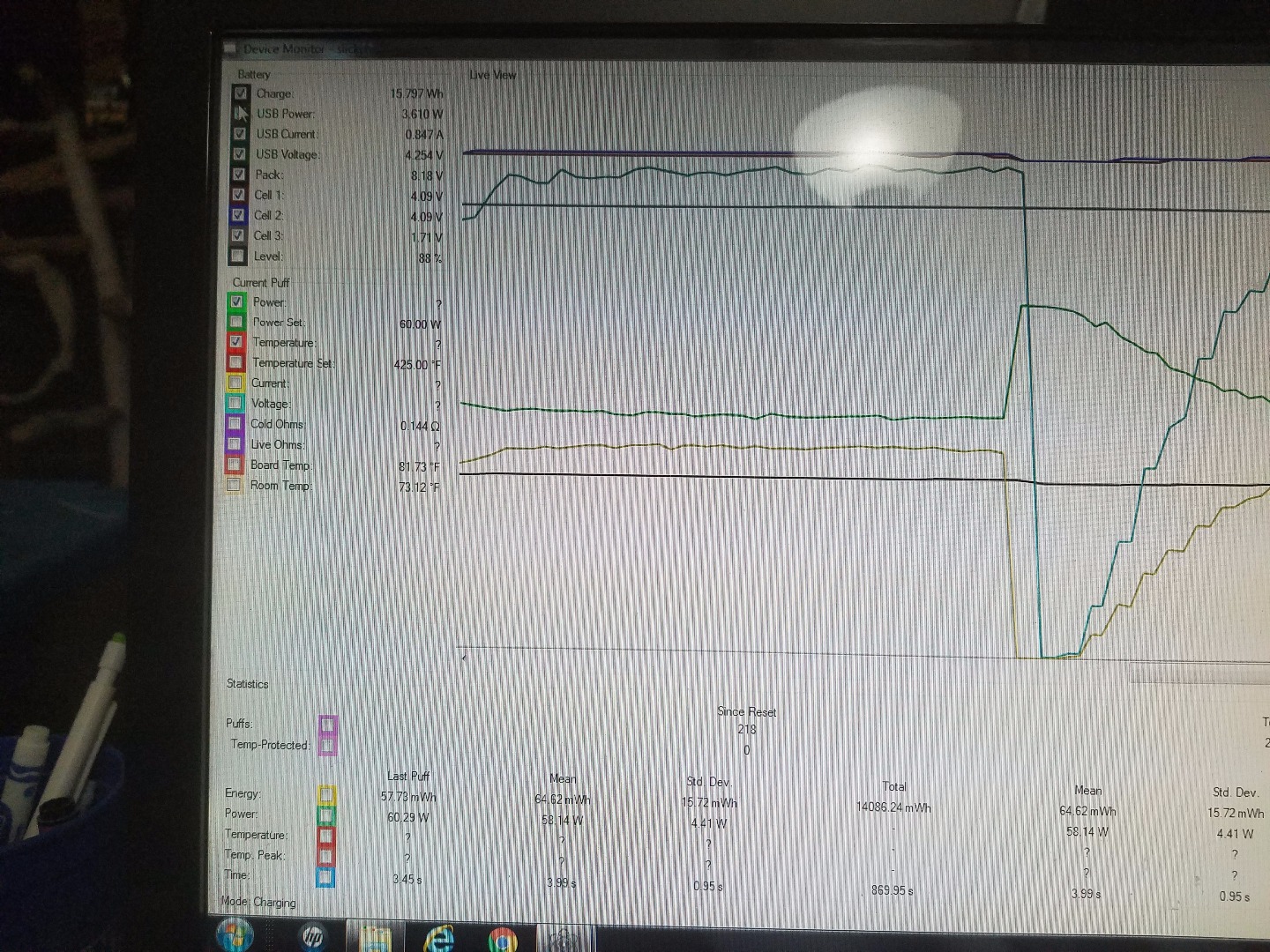

Jvape78 Posted October 26, 2016 Author Report Posted October 26, 2016 The sharp drop line is when fire is pushed momentarily
Spector NS5 RD Posted October 26, 2016 Report Posted October 26, 2016 Jvape78 said: The sharp drotp line is when fire is pushed momentarilyit's hard to tell from pictures of a monitor. you couldn't screenshot it using the snippit tool?either way, that line that drops of sharply is the the "usb current". that and "usb power" will drop to 0 when the fire button is depressed (this is normal operation). the DNA 75/200/250 are designed to interrupt the charging process while the fire button is depressed. then slowly climb back up in current (soft start) to resume the charging cycle.answer this......will the device fire while connected to escribe or if it is plugged in via USB to charge? if so, you're good to go.
