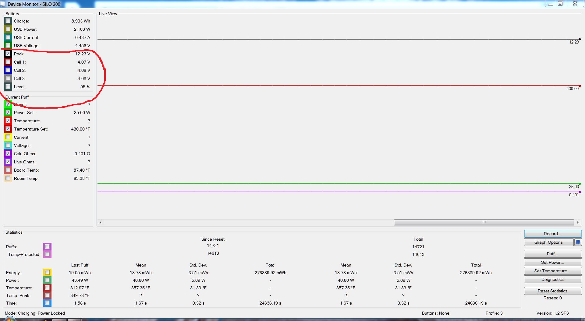

dwcraig1 Posted October 21, 2016 Report Share Posted October 21, 2016 A couple of questions. What it does Escribe Device Monitor show for cell voltages? Is your battery set for "maximum puffs" or maximum recharges? Link to comment Share on other sites More sharing options...
navytech77 Posted October 22, 2016 Author Report Share Posted October 22, 2016 Thanks for the response I actually unplugged the battery and seems to be working fine now. I'll keep you informed if anything changes. Thanks again. Link to comment Share on other sites More sharing options...
navytech77 Posted October 22, 2016 Author Report Share Posted October 22, 2016 dwcraig1 said:A couple of questions. What it does Escribe Device Monitor show for cell voltages? Is your battery set for "maximum puffs" or maximum recharges? Where would this information be at in the device monitor? Just curious. Thanks Link to comment Share on other sites More sharing options...
dwcraig1 Posted October 22, 2016 Report Share Posted October 22, 2016 Link to comment Share on other sites More sharing options...

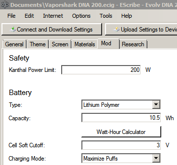

Ryan Marc Liversage Posted October 28, 2016 Report Share Posted October 28, 2016 Please help me out here as i seem to be going through the same issues my dna 200 vs won't charge full it only hits 81% , 5.11V . had a new battery out in and ever since this it is doing it. also if i connect the dan to escribe and restore factory settings it is say it cannot connect to server same as i ask for information on dna same message. Link to comment Share on other sites More sharing options...
Spector NS5 RD Posted October 28, 2016 Report Share Posted October 28, 2016 Ryan Marc Liversage said:Please help me out here as i seem to be going through the same issues my dna 200 vs won't charge full it only hits 81% , 5.11V . had a new battery out in and ever since this it is doing it. also if i connect the dan to escribe and restore factory settings it is say it cannot connect to server same as i ask for information on dna same message.i'm pretty sure restoring it to factory settings will reset the board to evolv's settings, not vaporshark's, which you do not want to do. vaporshark actually took the time to set the battery curve, mod resistance and run case analyzer. so you can't connect to escribe?if you can go into escribe......under the "MOD" tab make sure you're settings are at these are my battery settings for my VS DNA 200 they will work just fine for yours. maybe cut the watt hours down to an even 10 watt hours to be on the conservative side. Link to comment Share on other sites More sharing options...
