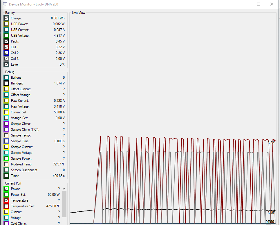

gizmoguy Posted October 29, 2016 Author Report Share Posted October 29, 2016 Hey guys so i tried charging my battery the other day and well when i hooked it into escribe it started spiking like a sawtooth wave it looked horrible. im not sure whats causing this issue ill attach a picture so you guys can see. Any help at all would be great.Its a panzerbox DNA200 latest firmware Link to comment Share on other sites More sharing options...
Spector NS5 RD Posted October 29, 2016 Report Share Posted October 29, 2016 Your cell voltages are very low and unbalanced. Are using the recovery charge function in escribe? You could have a bad Lipo battery. How many puffs are on the mod? Link to comment Share on other sites More sharing options...
gizmoguy Posted October 29, 2016 Author Report Share Posted October 29, 2016 theres roughly 10k puffs on the mod the cell pack voltage is slowly rising in escribe as if its charging im just scared to leave it in. charging it normally i tried doing a recovery charge seeing if it could fix it. the voltages that are in the pic for cell 1,2 and 3 jump around from 2-3.5 and slowly rise so jumping from 2-3.6 now Link to comment Share on other sites More sharing options...

VapingBad Posted October 29, 2016 Report Share Posted October 29, 2016 It just looks like recovery charge pulsing the battery, it is a special case most mods would just not charge if your batteries got that low. Link to comment Share on other sites More sharing options...

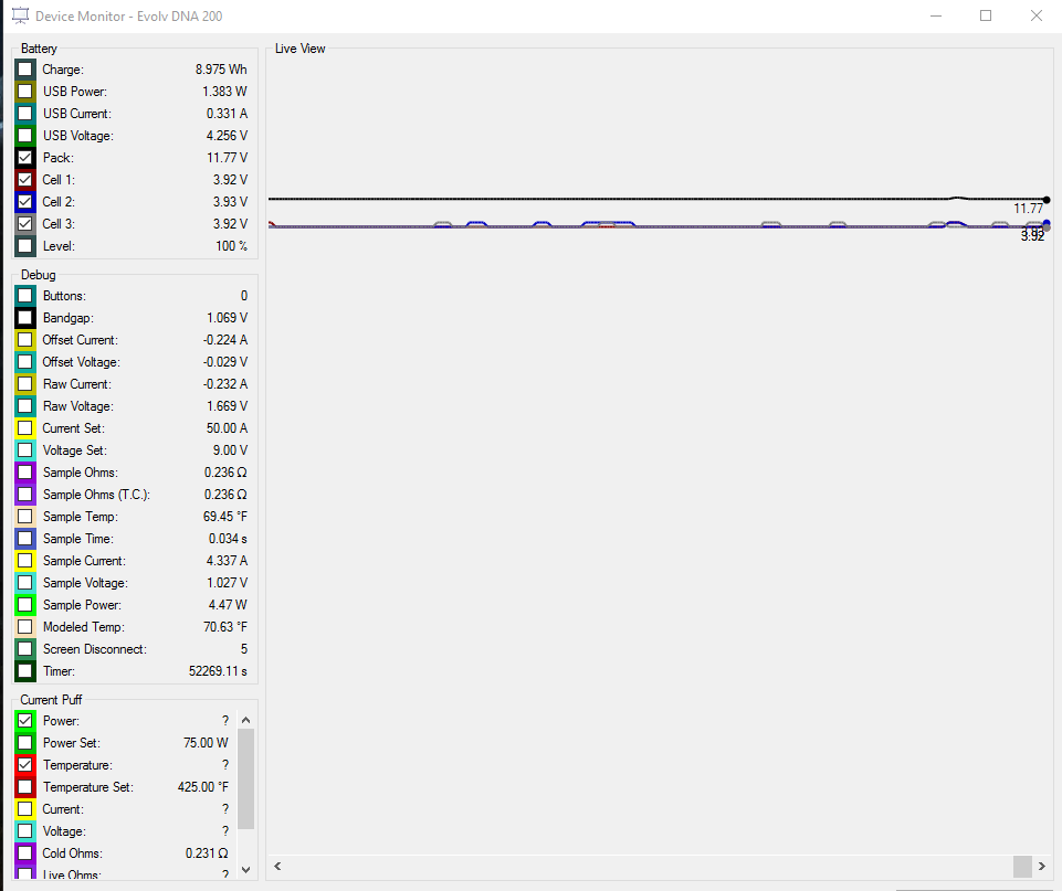

gizmoguy Posted October 30, 2016 Author Report Share Posted October 30, 2016 Left it overnight and it seems to be working now thanks fir the help guys Link to comment Share on other sites More sharing options...
