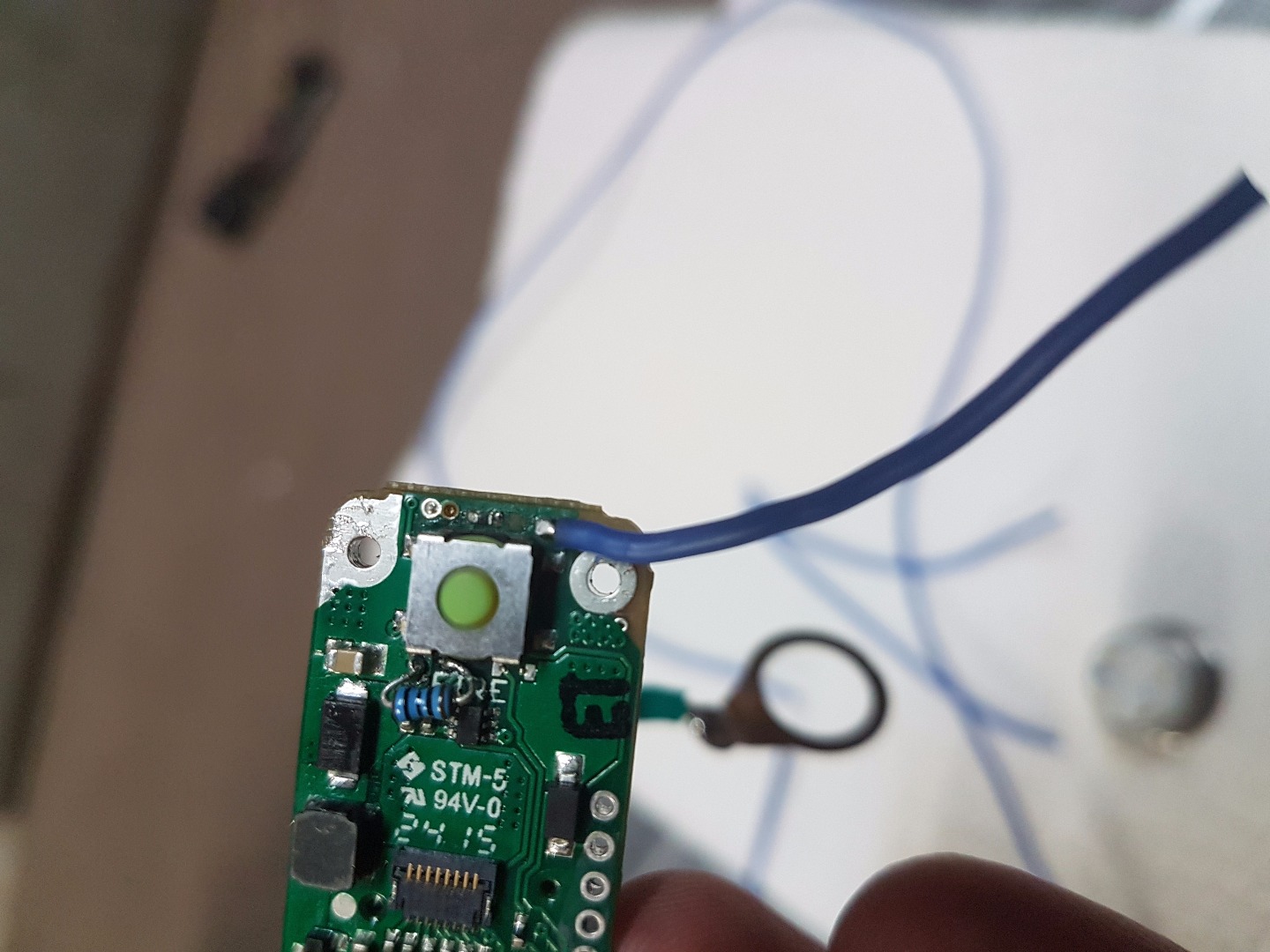

John la Posted October 29, 2016 Author Report Share Posted October 29, 2016 So I'm trying to get the led going and I soldered off the connection right next to the blue wire is there anything I can do or am I screwed chip still work BTW thanks guys Link to comment Share on other sites More sharing options...

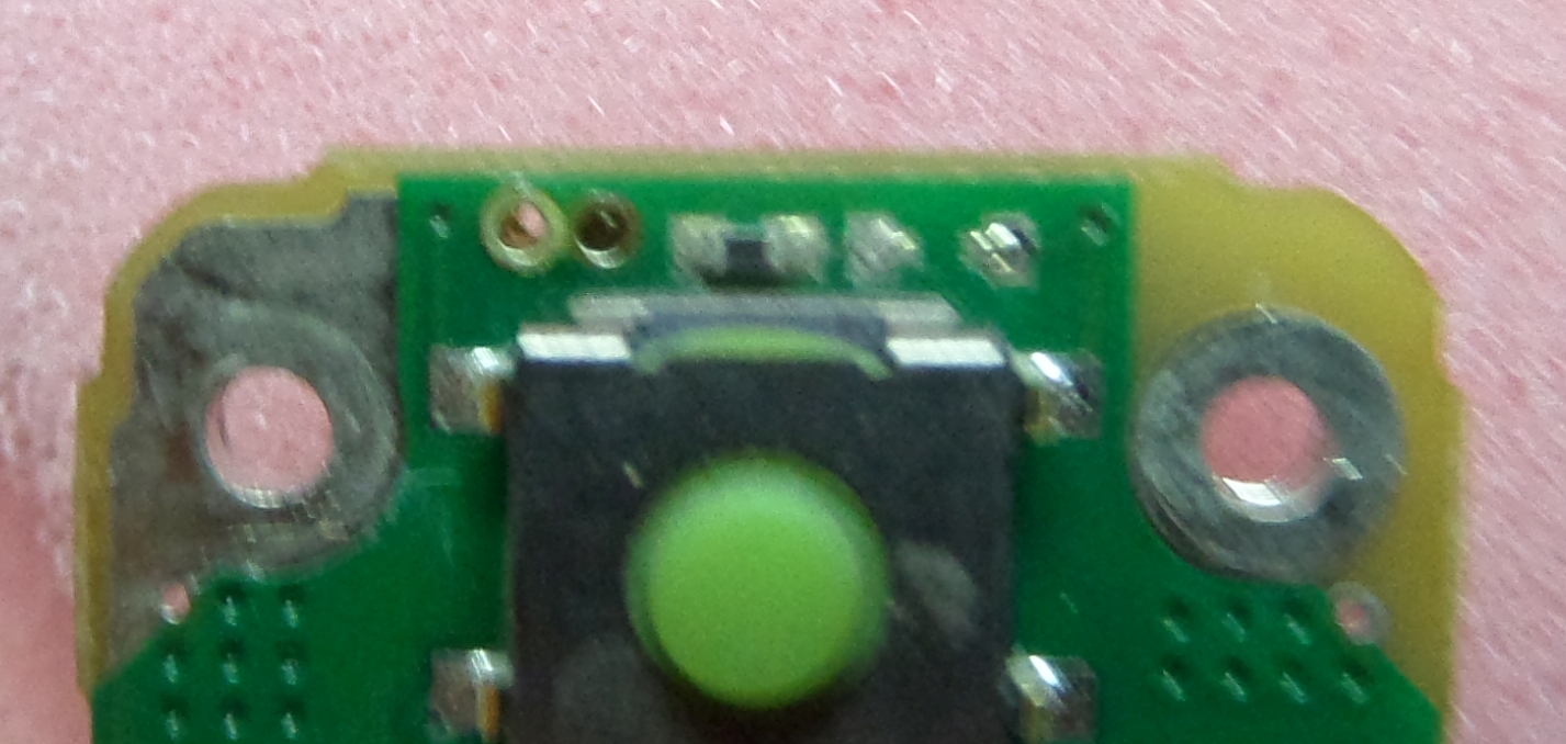

Spector NS5 RD Posted October 29, 2016 Report Share Posted October 29, 2016 you accidentally lifted the trace? if you look really close the resistor is still there. you could solder a very small gauge wire the end of the resistor that the trace was connected to. that small black resistor is connected to the trace you destroyed , i'm pretty sure. double check with a DMM. make sure you have a voltage, when the fire button is depressed, between your blue wire and that resistor. that voltage should power your LED. Link to comment Share on other sites More sharing options...

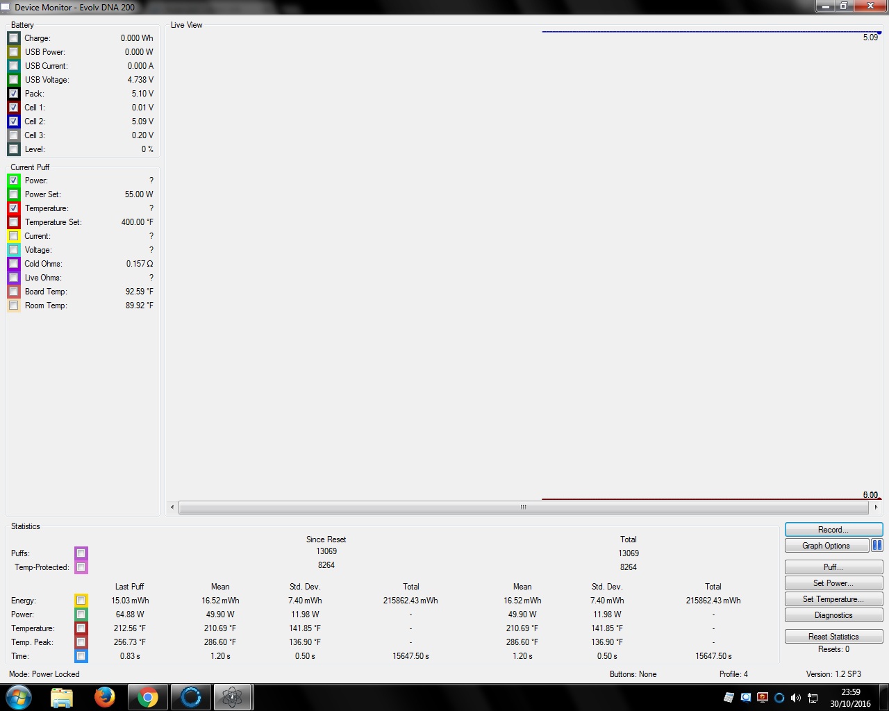

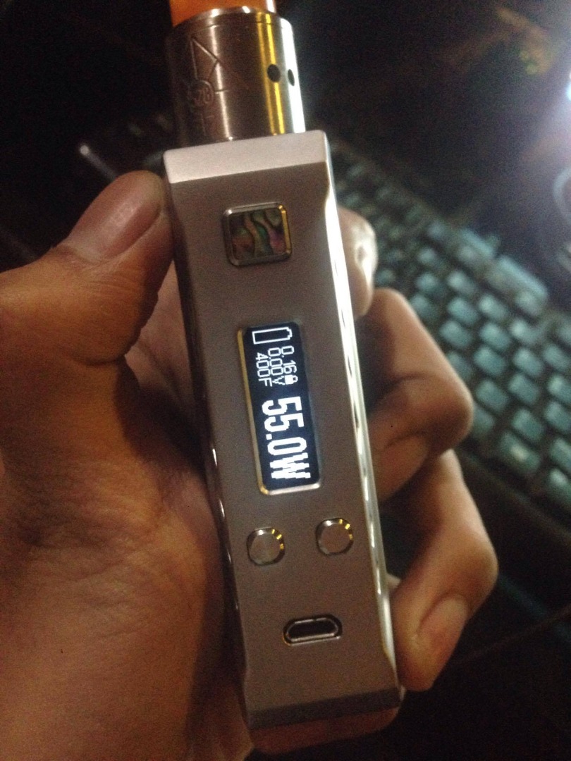

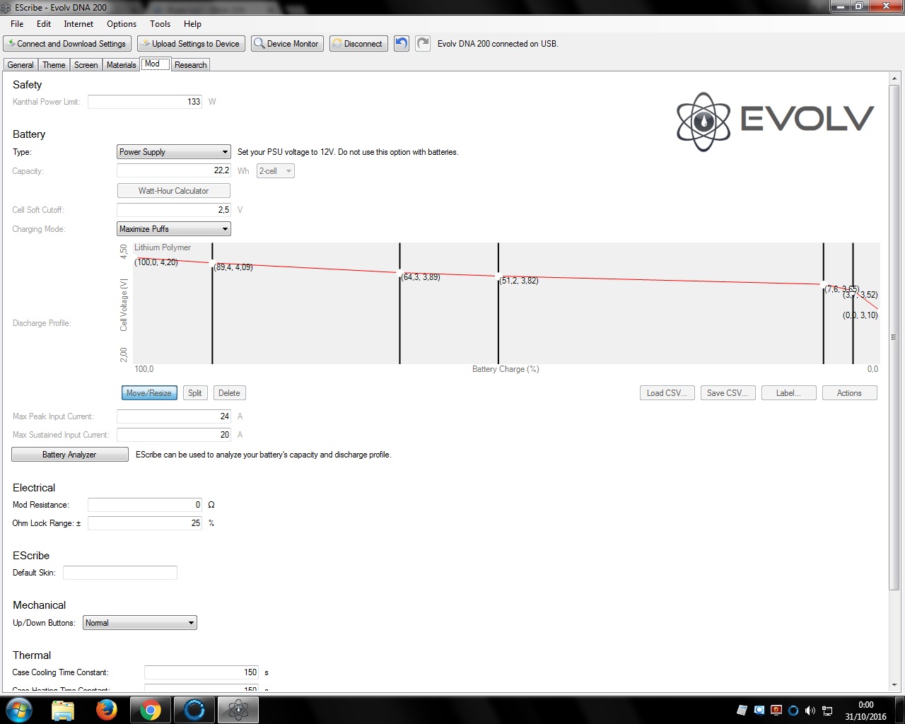

galuh Posted October 30, 2016 Report Share Posted October 30, 2016 133 finder suddenly die, but when firing long press turns on and off the firing button to die, try to check the battery indicator escribe cell 1 '0.0v' and cell 2 '5.09v' and replace the battery setting type 'POWER SUPPLY' normal and willing in firing but the battery indicator is empty, so please his problem where? 1 again whether it is safe by setting the batteries 'power supply' is? thanks Link to comment Share on other sites More sharing options...
Spector NS5 RD Posted October 30, 2016 Report Share Posted October 30, 2016 galuh said:133 finder suddenly die, but when firing long press turns on and off the firing button to die, try to check the battery indicator escribe cell 1 '0.0v' and cell 2 '5.09v' and replace the battery setting type 'POWER SUPPLY' normal and willing in firing but the battery indicator is empty, so please his problem where? 1 again whether it is safe by setting the batteries 'power supply' is? thanksyou most likely need a new board. do not run the finder 133 in "power supply" mode. there is no battery monitoring. contact the vendor you purchased the mod from. Link to comment Share on other sites More sharing options...
