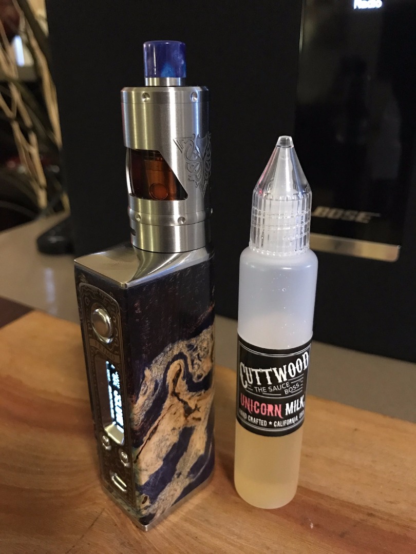

Harlequin Posted November 14, 2016 Author Report Posted November 14, 2016 So I was only just saying earlier today how much I love my VA Primo but tonight - after having had it for about 2 weeks - it has suddenly started randomly doing a power reset when I press the fire button.I've tried different batteries and different toppers but it will even, I've just discovered, do it with no atomiser attached.I know that some of the early DNA75 boards had some issues with measuring resistance and such but my Google-Fu cannot find anything relating to this particular problem....Does anyone have any knowledge or experience with regard to this issue?Pic for attention:
