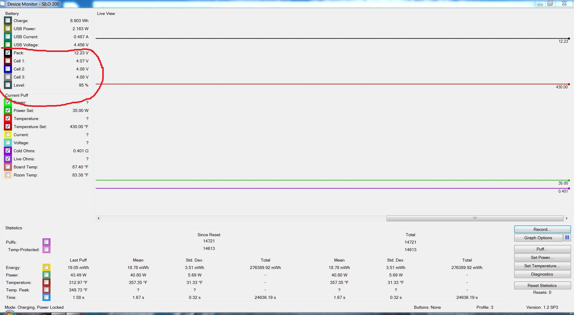

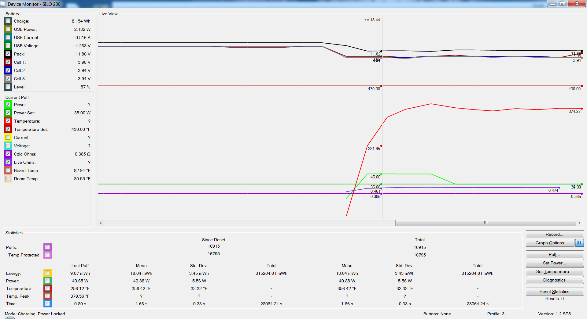

Spirometry Posted November 19, 2016 Report Share Posted November 19, 2016 Check individual cell voltages under load. Some people have had poor battery connections with that device due to the polarity rings. Link to comment Share on other sites More sharing options...
dwcraig1 Posted November 19, 2016 Report Share Posted November 19, 2016 Example:Here pack voltage dropped from 12.3 volts to 11.8 volts when firing 45/35 watts. Link to comment Share on other sites More sharing options...
