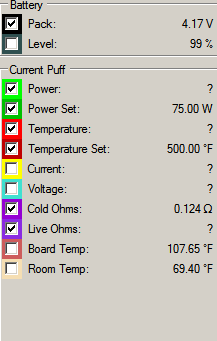

Spector NS5 RD Posted November 22, 2016 Report Posted November 22, 2016 go back into EScribe and set your mod resistance to 0 and upload that value to your tugboat. after that open atomizer analyzer and take note of the raw ohms. the reading should be fairly steady with only slight fluctuations. if the ohms are jumping around a lot, you could have a connection issue somewhere. what would also help is a screenshot of device monitor firing the build with these options ticked...........(this is for a 75 but options are almost the same)make sure you're using the correct wire CSV for your wire.

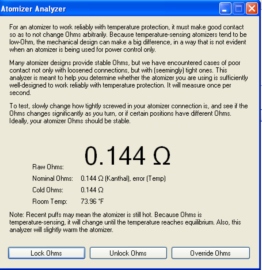

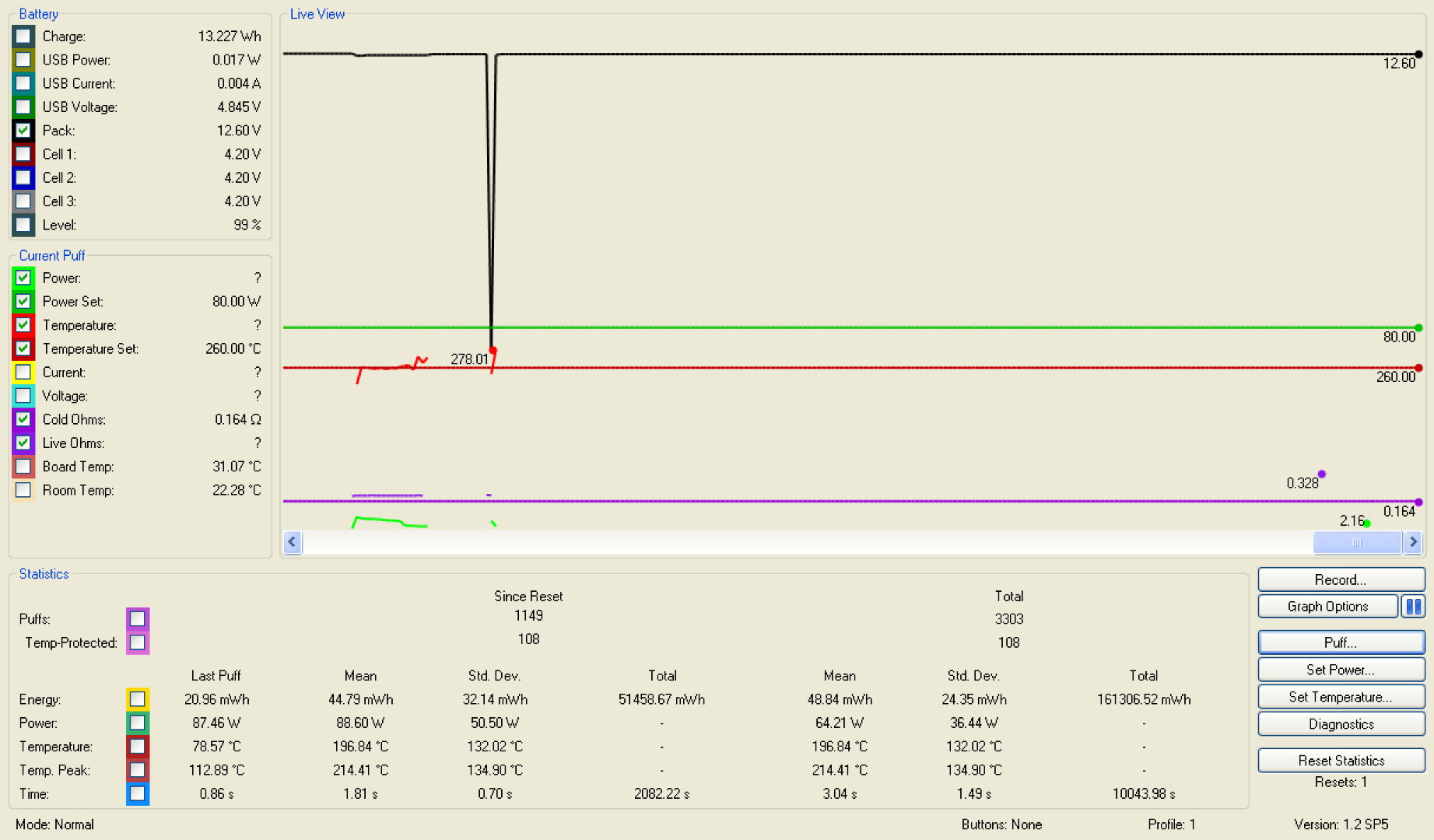

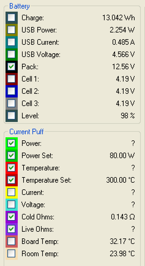

nikoskater8 Posted November 22, 2016 Author Report Posted November 22, 2016 atom analyzer started reading at 0,137 then stabilized at 0.01443 -0.0144 (peak at 0.0145 but mostly around 0.0143 - 0.0144 ). in reading it would seldom times for a fraction of sec read error in nominal ohms (temp) reading (see attached photo)the material csv is the one provided by escribe (316) and this is the link of the wire with the specs that i'm using (http://www.wireandstuff.co.uk/products/316-Grade-Stainless-Steel-Wire--AISI-316----0.6mm--600-Micron---22-AWG--314.html#SID=89)also attached the device monitor's screenshot
dwcraig1 Posted November 22, 2016 Report Posted November 22, 2016 A screen shot showing this (example)

nikoskater8 Posted November 23, 2016 Author Report Posted November 23, 2016 update:left the mod sitting for 20 mins with atomizer analyzer opened and both raw and cold ohms read 0.287 ohms (0.29 on device) tired firing it from the mod, not from device monitor and i got some OFF for a fraction of second and then a 5 digit temperature and it was not an 80watts firing for sure, more in a 150 watts range if i have to guesstimate, with atom analyzer still on the values went back to 0.148-0.150 in raw ohms but stayed 0.287 in cold ohms.closed and reopened the atom analyzer and i get 0.184 cold ohms and 0.154 - 0.155 raw ohms. the raw ohms seems to go up little by little if i'm letting the device sit without firing iti've tried running the atomizer analyzer with a non tc premade coil (0.54- 0.55 on the tab) on a different atty and it reads 0.628 cold ohms and raw ohms going between 0.617 to 0.627 with some higher peak still in the 0.62-0.63 range and mostly in the 0.620 rangeand another atty with 0.28 coil reading 0.347 cold ohms and 0.358 - 0.360 raw ohms and keeps going up after leaving it sit screwing back the original 0.1 atty (goon) it reads 0.22 raw ohms and no cold ohms after firing it it goes down to 0.16-0.17 both cold and raw ohms only to keep going up in raw ohms i don't know if it could help but i'm running the vmware fusion on a macbook to emulate windows xp and run escribe and also i haven't run no case nor battery analyzer, i've only set the Wh with the watts/hour calculator and the mah read on the lips pack and set a few custom screen imagesEDIT:i've tried the last atty i have (subzero 24) and with the same build as the first atty (goon) and it read 0.20 and overshould i do an hard reboot to reset the mod to factory settings and then re-apply the saved "general" backup file?
