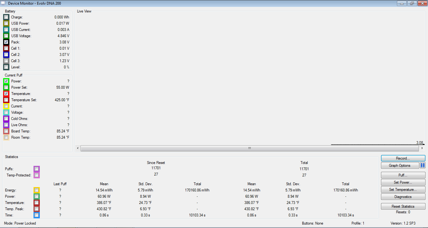

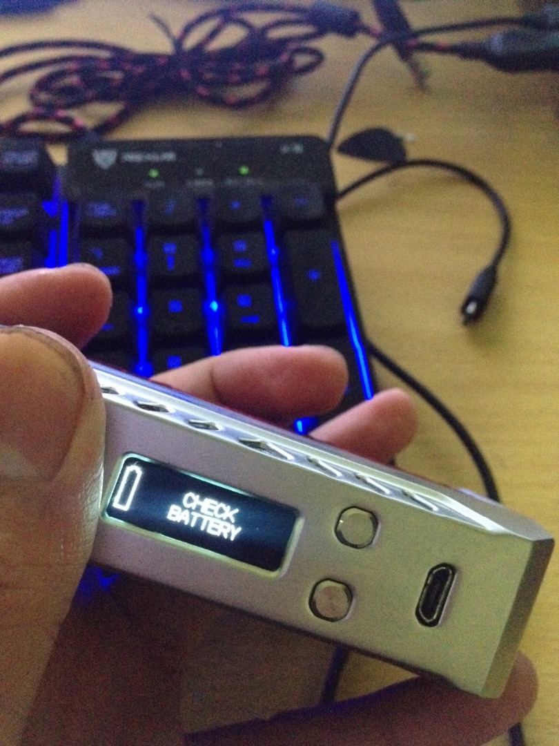

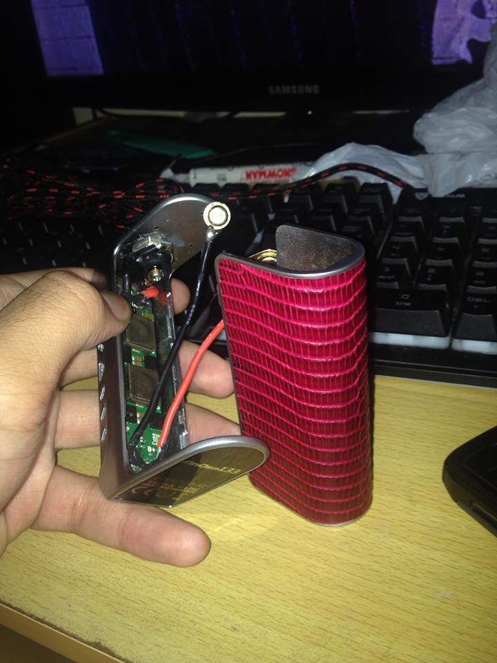

Lenharlend Posted November 23, 2016 Author Report Share Posted November 23, 2016 Can anyone help im having problem with the most common problem, "Check Battery" issue, which the "Cell 1" reads 0.01V on my device monitor. So i take apart my finder133, my fuse isn't blown, and the screen still works well. so i believe that the chip still normal but the problem is with those connector's. can anyone help me fix this problem? if the Cell 1 is the problem then how to fix it? which connector ive to fix?or the problem isn't with the connectors?and if i replace the wire, am i have to replace with the same wire like 18awg 200C?sorry if this topic keep repeated & repeated again, my phone kinda lag hihi Link to comment Share on other sites More sharing options...

Canadianvape Posted December 3, 2016 Report Share Posted December 3, 2016 I got issues on cell 1 on the releaux dna200... bit of cotton behind cells fixed it, use device monitor and make sure all your cells are making contact Link to comment Share on other sites More sharing options...
