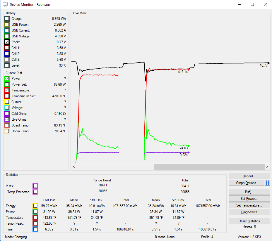

I have to agree with Yoseff here. My therion came with all nickel presets although they were labeled as different wires. Assuming correct values are used, there's a very noticeable difference between SS & Nickel in regards to the graph and the right most value in the graph. LostVape did a poor job setting up this device. Out-of-box experience was crap and frankly, SS is on the DNA (and other boards) is crap. On both the Therion & the Hcigar VT75 I have. The chip just can't decide what to do half the time. My VT200 running sp2 however is working great with SS.
im very new to the dna situation, although i learned escribe excelent i still have to figure out whats going on with the firmware updates. i will just update when escribe tells me to right? i set my profiles to pwr, ni, ti, ss all set from the steamengine curves. i also made a new material ''empty'' to use on the non set profiles. one last thing preheat on kanthal doesnt seem to work. any1 have some profile to share or its the latest firmware that cant do it?
SS on the DNA 75 out of the box is fantastic, if the board is having trouble seeing the coils as temp sensing it is either a build issue, wire profile/TCR mismatch, not enough power or connection issue, typically it is not seeing the temp rise enough in the first second.  I have never had ss drop out of temp limiting on DNA 75s or 200, but I have been using temp limiting since the DNA 40 was released so only use atties with decent connections and coiling for temp limiting is the norm for me.
