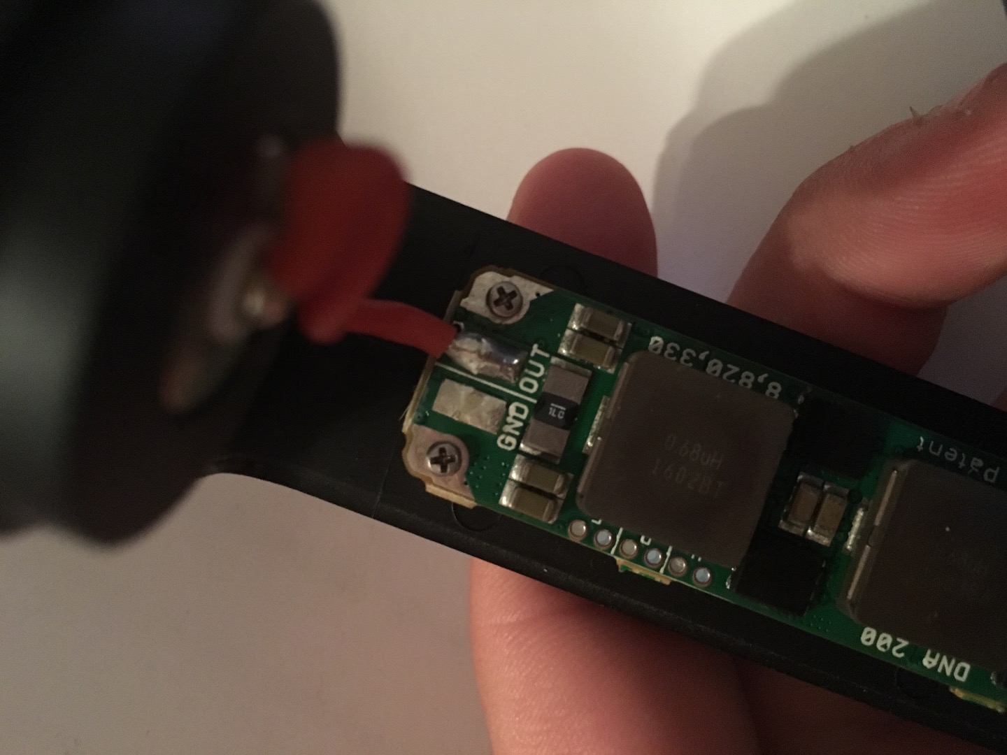

iBlond Posted October 20, 2016 Author Report Posted October 20, 2016 I have found out that my Aria Solara Dna 200 does not have a grounded wire. This makes the mod read about .05-.15 over what it actually is. Is this the right solution to my problem? And do I wire it from the 510 to the GND right next to the OUT?
dwcraig1 Posted October 20, 2016 Report Posted October 20, 2016 That is the spot on the board but how are you going to attach to the 510?You might check the 3 board mount screws to assure they are tight, they supply the chassis ground. Be extra careful not to over tighten and break them.
iBlond Posted October 20, 2016 Author Report Posted October 20, 2016 dwcraig1 said:That is the spot on the board but how are you going to attach to the 510?You might check the 3 board mount screws to assure they are tight, they supply the chassis ground. Be extra careful not to over tighten and break them. Thanks it was just the screws
