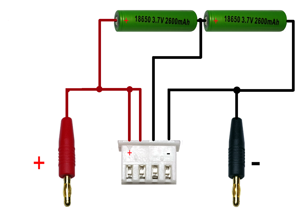

Collins Posted January 28, 2017 Author Report Posted January 28, 2017 I was wondering what modifications I would need to do to attach a 3 pin female jst for a 2s lipo?
VapingBad Posted January 28, 2017 Report Posted January 28, 2017 Just bridge the highest pin with the unused connection point.[CODE]Bridge 2 & 3 on the boardBoard -ve |GND| 1 | 2 | 3 | +veBattery -ve | 0 | 1 | 2 | +ve[/CODE]
