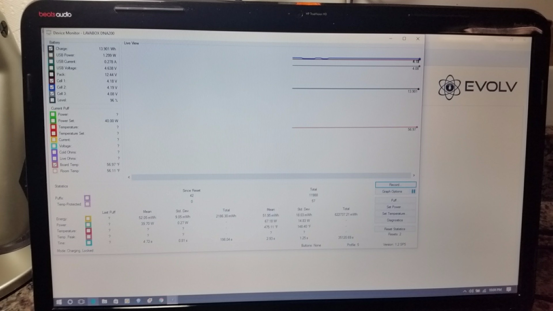

MRSpivey Posted January 26, 2017 Author Report Posted January 26, 2017 It seems that the DNA 200 board in my LAVABOX is discharging Cell 3 (likely an issue with the charging section). Any LiPo I put in her (the 900 mAh and two different 1,300 mAh) has cell 3 down to ~3.7V after 3-4 days while cells 1 and 2 are still at 4.18. Since I'm past the manufacturer's 90 day warranty, I thought I would seek insight from the forum on what to do. I've also posted a ticket with EVOLVE yesterday (Ticket tracking ID: DBU-69N-X6G6) and waiting to see if they may do something. Static discharge after about seven hours, on a new LiPo after it was balanced charged on an external charger and all were at 4.20 volts at the start, C1=4.20, C2=4.19, C3=4.17. I will reconnect after work today to see where they are at.

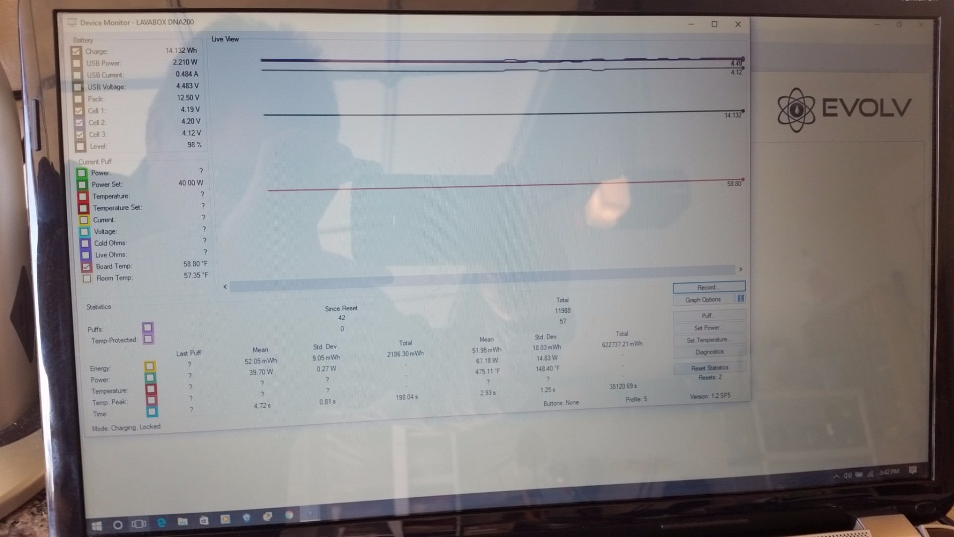

MRSpivey Posted January 27, 2017 Author Report Posted January 27, 2017 Basically 24 hours after full charge Cell 1 = 4.18, Cell 2 = 4.19, and Cell 3 = 4.08. This validates the observed drain on Cell 3 after four days (reading of 3.7). I removed the board and visually inspected the balanced connector on the board and there is nothing visible that would indicate moisture, oxidation, or other continuity issues. I will de-solder the connector tonight, clean it and the board contacts, and solder it back into place. Photo of readings attached.
