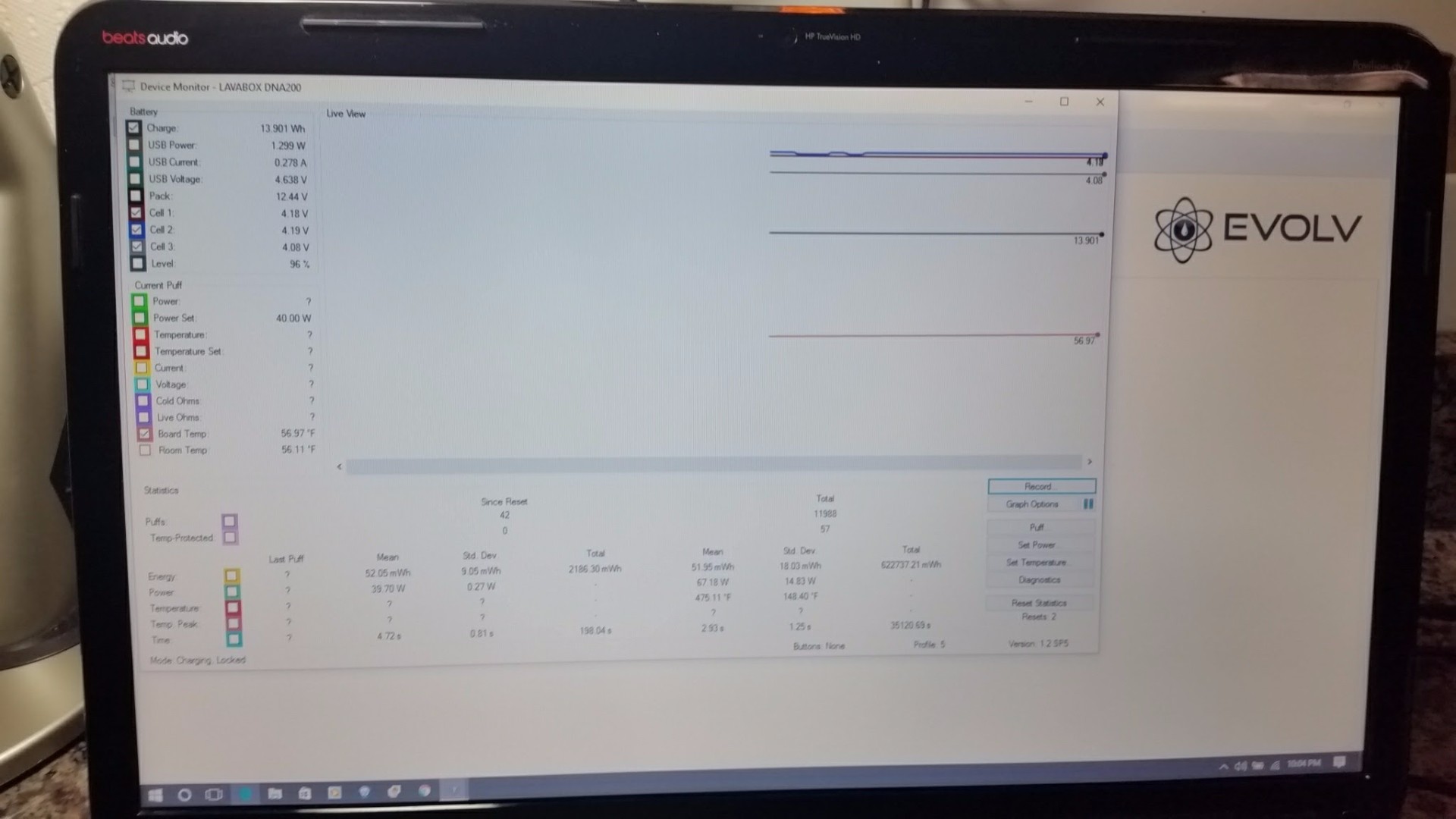

  3. Basically 24 hours after full charge Cell 1 = 4.18, Cell 2 = 4.19, and Cell 3 = 4.08. This validates the observed drain on Cell 3 after four days (reading of 3.7). I removed the board and visually inspected the balanced connector on the board and there is nothing visible that would indicate moisture, oxidation, or other continuity issues. I will de-solder the connector tonight, clean it and the board contacts, and solder it back into place. Photo of readings attached.
