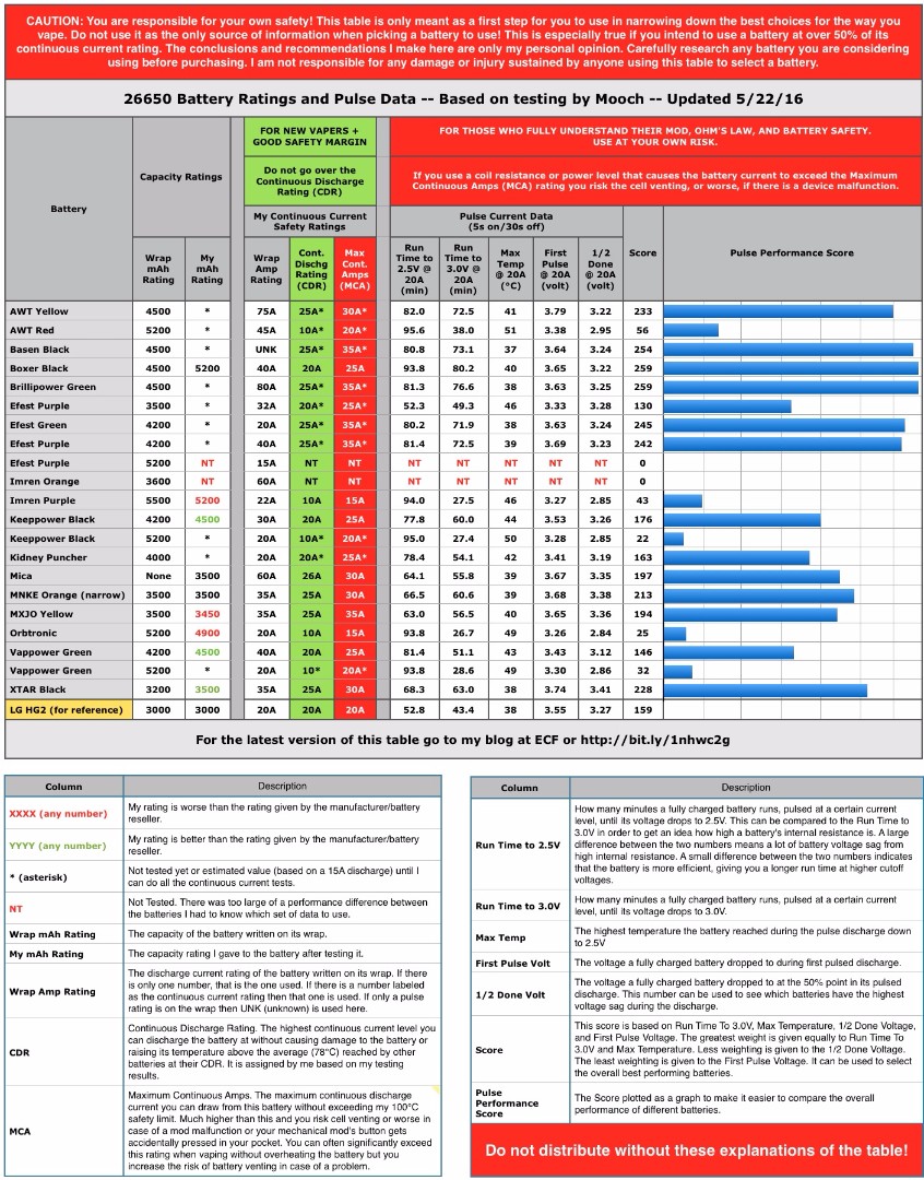

Spector NS5 RD Posted January 29, 2017 Report Share Posted January 29, 2017 26650's aren't the best performers in terms of providing enough current to the DNA 75 board. i'm sure what brand of 26650 cell Boxer re-wraps. you would need to get an actual 25-30 amp 26650 if you're going to run at 75w. here's a list of 26650 cells that a good fit for the 75 (the ijoy having the best CDR) Link to comment Share on other sites More sharing options...
Padillaeric Posted January 29, 2017 Author Report Share Posted January 29, 2017 I wnt off this chrt... Link to comment Share on other sites More sharing options...
