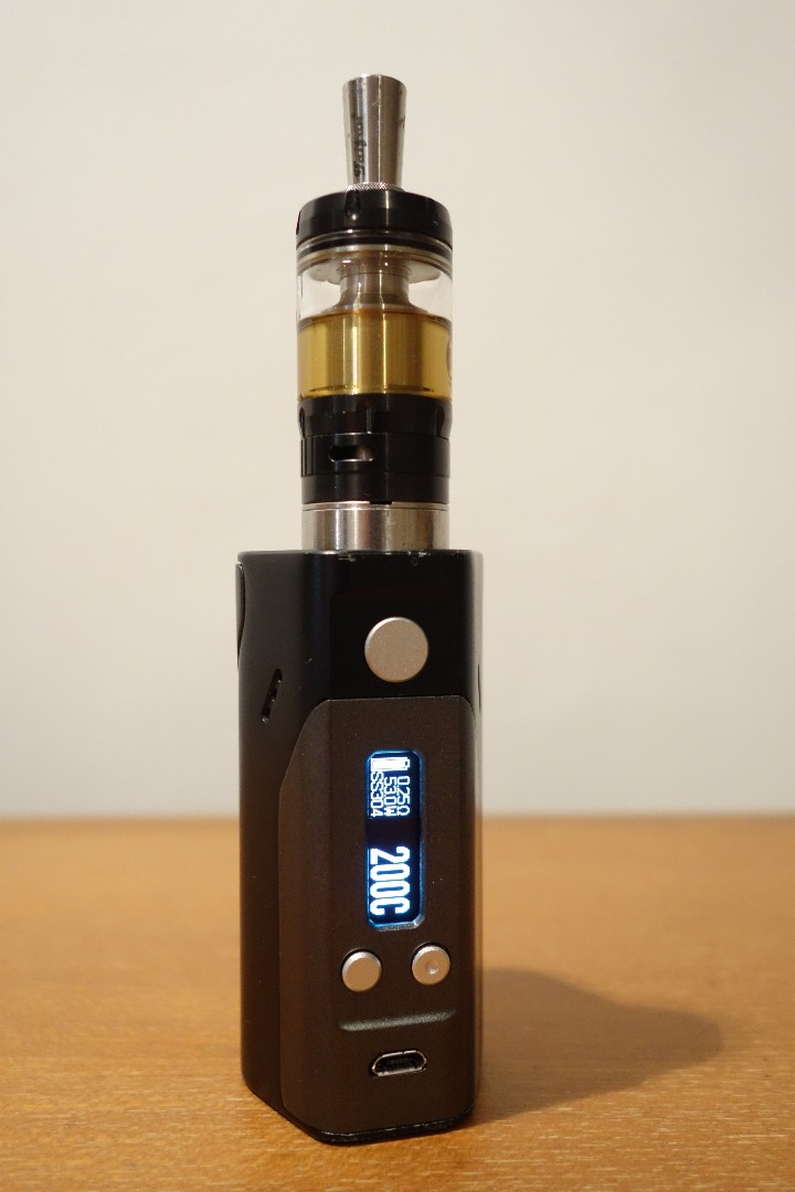

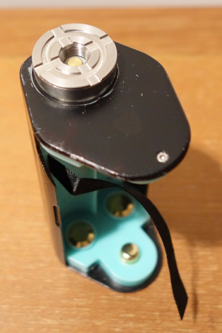

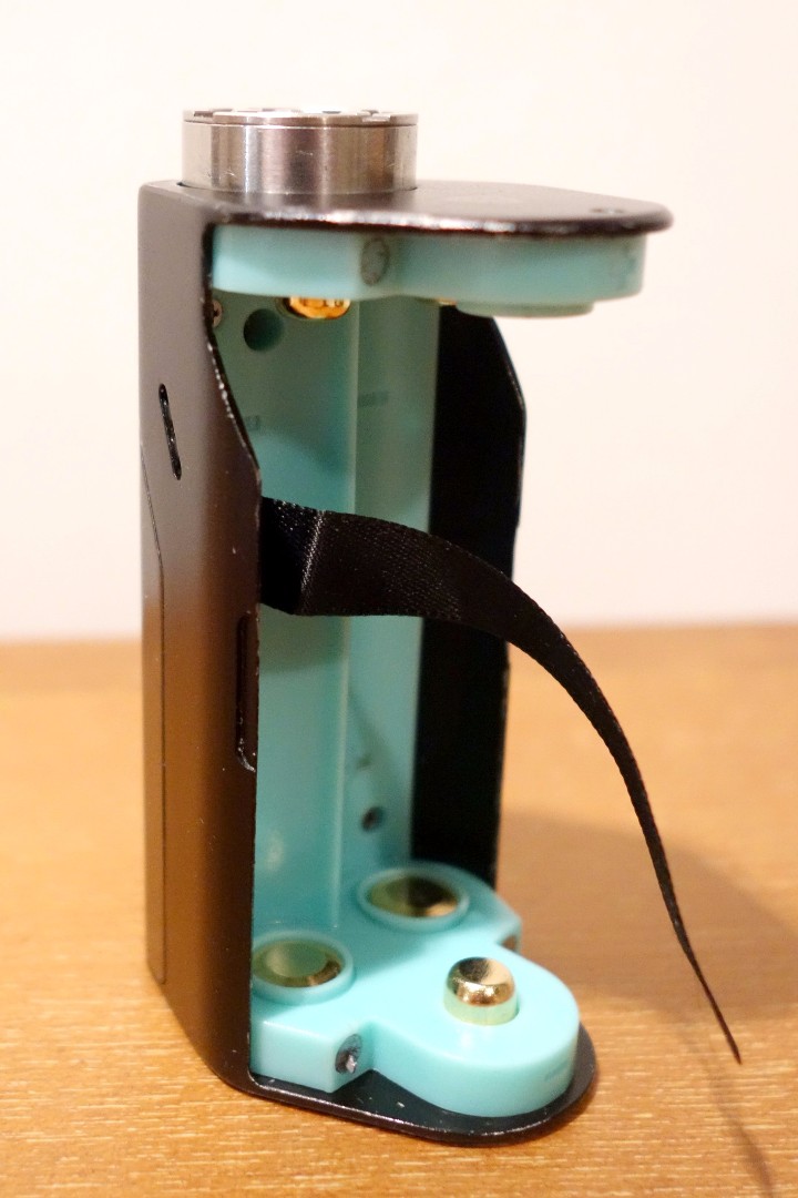

dl12345 Posted February 3, 2017 Author Report Share Posted February 3, 2017 I own three DNA devices, of which I have assembled one (a Boxer DNA133), completely rebuilt another (a Wismec DNA200) and now I'm seriously thinking of having a part machined so I can rebuild my HCigar VT75 nano.In all cases, the offending part is the really poor quality 510 connector which degrades the TC performance significantly. On the Wismec (both the RX200 I owned and the DNA), the spring loaded pin stopped being spring loaded and I needed to replace the connector.I have a similar issue with the VT75 nano. It's 510 is just crap and the base plate makes inconsistent connectivity with the body. But there's no real space to add a proper Varitube or FDV connector, so I'm thinking of doing something similar to what I did with my Wismec, which is to add a 22mm tube shaped mount on the top of the box to space the 510 further away so it does not impinge on the board. However, with the Wismec it was a little easier (apart from the really cramped space inside the box) - just a small SS tube with a 10mm hole in the top did the trick. With the nano, the tube needs to be threaded and the thread must be recessed. So it occurred to me perhaps I should just 3D print a new box. Can anyone recommend some good 3D printed 2x18650 boxes for a DNA75 (or even a single 26650)? Commercial or creative commons - I don't really care either way. Or even a fully made box (small and 2x18650 is desirable). Link to comment Share on other sites More sharing options...
