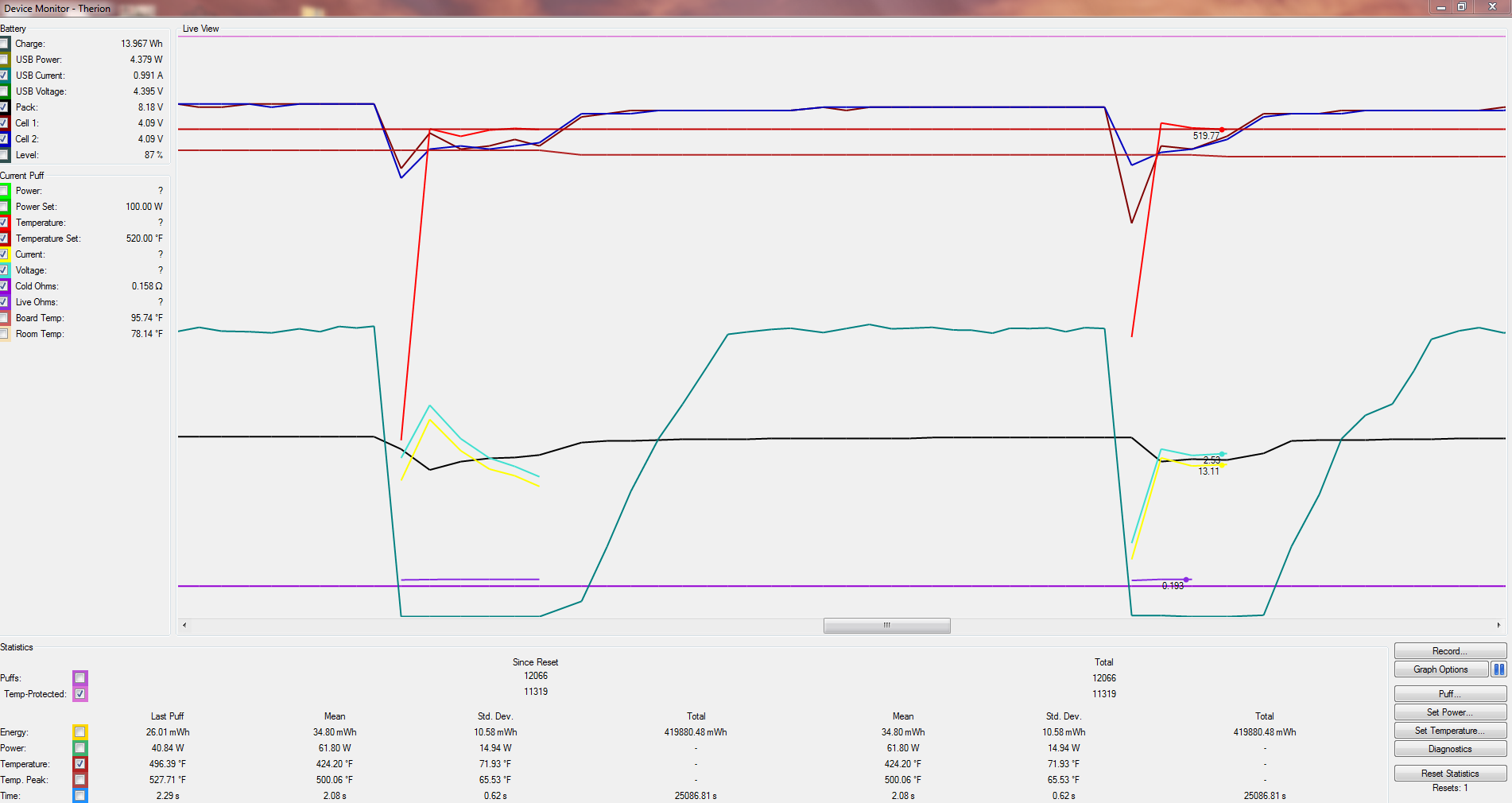

shugg1967 Posted February 4, 2017 Report Posted February 4, 2017 I have weak vape problem too its a dual 8 wraps of 24g 316L on 2.5 rod spaced it work great for 3 days then i put it back on its weak .using Tokugawa rda /Therion 166 good connection it worked great for couple day put it back on today its weak. ive had this problem before on other attys works great for a day then its act up weak vape back on its weak here is a SS
