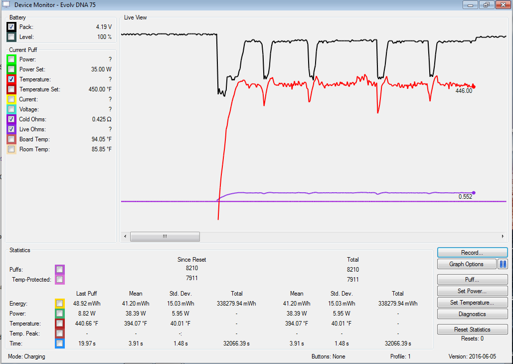

What does the Device Monitor screen show while firing the device?

Using a stainless steel clapton. I'm using the came csv that I've downloaded from steamengine for the passed few months. I've triple checked all of my connections and everything seems to be fine. I'm getting really frustrated.
