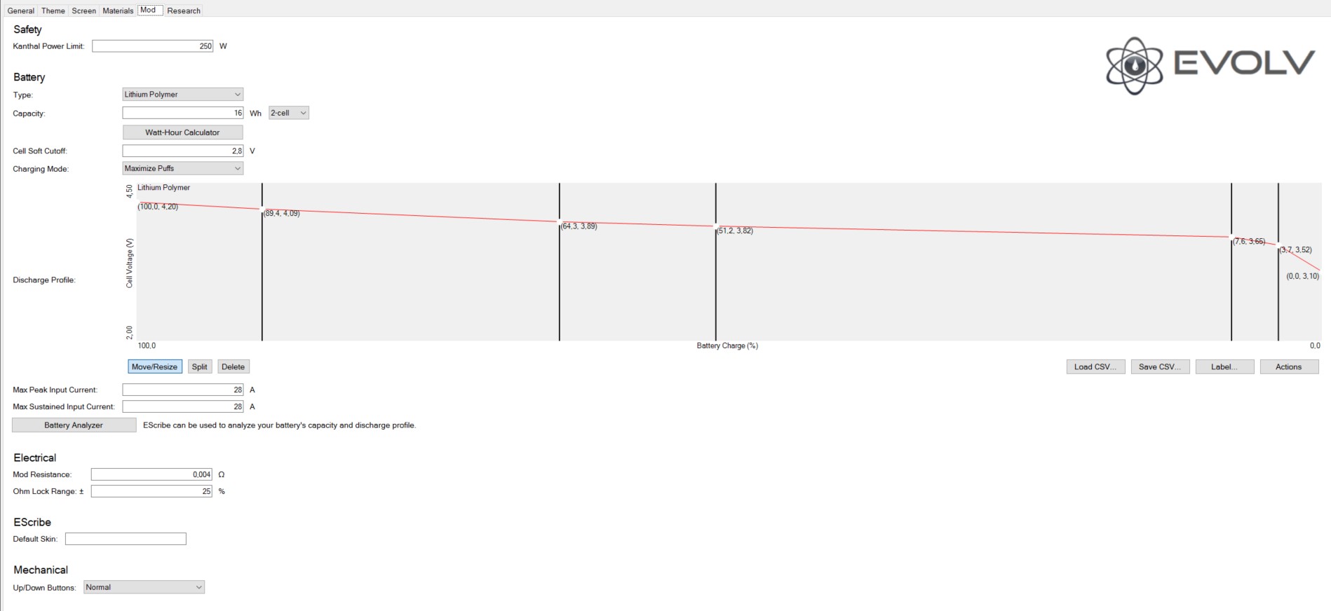

knikol Posted February 27, 2017 Author Report Share Posted February 27, 2017 Dear all,I have a therion 166 (bought it used) and I have the attached as default settings.Mostly, Im using vtc6 and vtc5a on it. When the battery meter reaches around 10-15% I charge the batteries and my lucv6 shows 3,78 - 3,8 volts in each battery.What settings should I upload on device in order to use both battery sets without having to change profile battery / settings twice per day.My triade 250 (sold) didnt have this feature of setting Wh etc I just had to change cells and thats all! before charging, batteries drained at 3.2 to 3.3 volts which is normal.Vt75 didnt have that feature too.. It is the first time I see this..Any help? Thank you in advance! Link to comment Share on other sites More sharing options...
knikol Posted February 27, 2017 Author Report Share Posted February 27, 2017 forgot the settings! attached please! Link to comment Share on other sites More sharing options...

knikol Posted February 27, 2017 Author Report Share Posted February 27, 2017 Thanks for the csv giz_60.. I found some others too, I read some things before posting.. My issue is that, apart from showing the battery empty (in 3.8 volts) I want to use different sets of batteries and not only vtc6.. Can I use some "universal" settings? Or something between vtc5a and vtc6 at least? Link to comment Share on other sites More sharing options...
giz_60 Posted February 27, 2017 Report Share Posted February 27, 2017 By setting the Wh's a bit higher than what you have, it will improve the accuracy of the battery indicator...these settings only effect the battery indicator, not battery life...looks like that Wh setting is a factory setting...There is no 'universal' setting as all batteries are different...Edit: You will have to manually enter the Wh's...it doesn't load from the .csv... Link to comment Share on other sites More sharing options...
knikol Posted February 27, 2017 Author Report Share Posted February 27, 2017 Ok, thanks! So If I want to use both vtc5a and vtc6 I just have to raise the Wh? should I leave the curve to default? Or you do recommend to upload the vtc6 amd adjust Wh to 19.96 either If I use vtc6 and vtc5a? Link to comment Share on other sites More sharing options...
giz_60 Posted February 27, 2017 Report Share Posted February 27, 2017 Try the .csv I sent ya & set the Wh's to 19.96...see how that works for you...not gonna hurt your batteries none...Edit: That .csv file was generated on a Therion 166 Link to comment Share on other sites More sharing options...
knikol Posted February 27, 2017 Author Report Share Posted February 27, 2017 Ok I'll do so and I will let you know! Thank you for your time! Link to comment Share on other sites More sharing options...
knikol Posted March 4, 2017 Author Report Share Posted March 4, 2017 Update.. Using vtc5a with settings / curve for vtc6 (the above csv) worked fine!I charged when battery meter set to zero, right before flashing and my charger showed 3.15 and 3.17 volts..That means it worked fine! Link to comment Share on other sites More sharing options...
