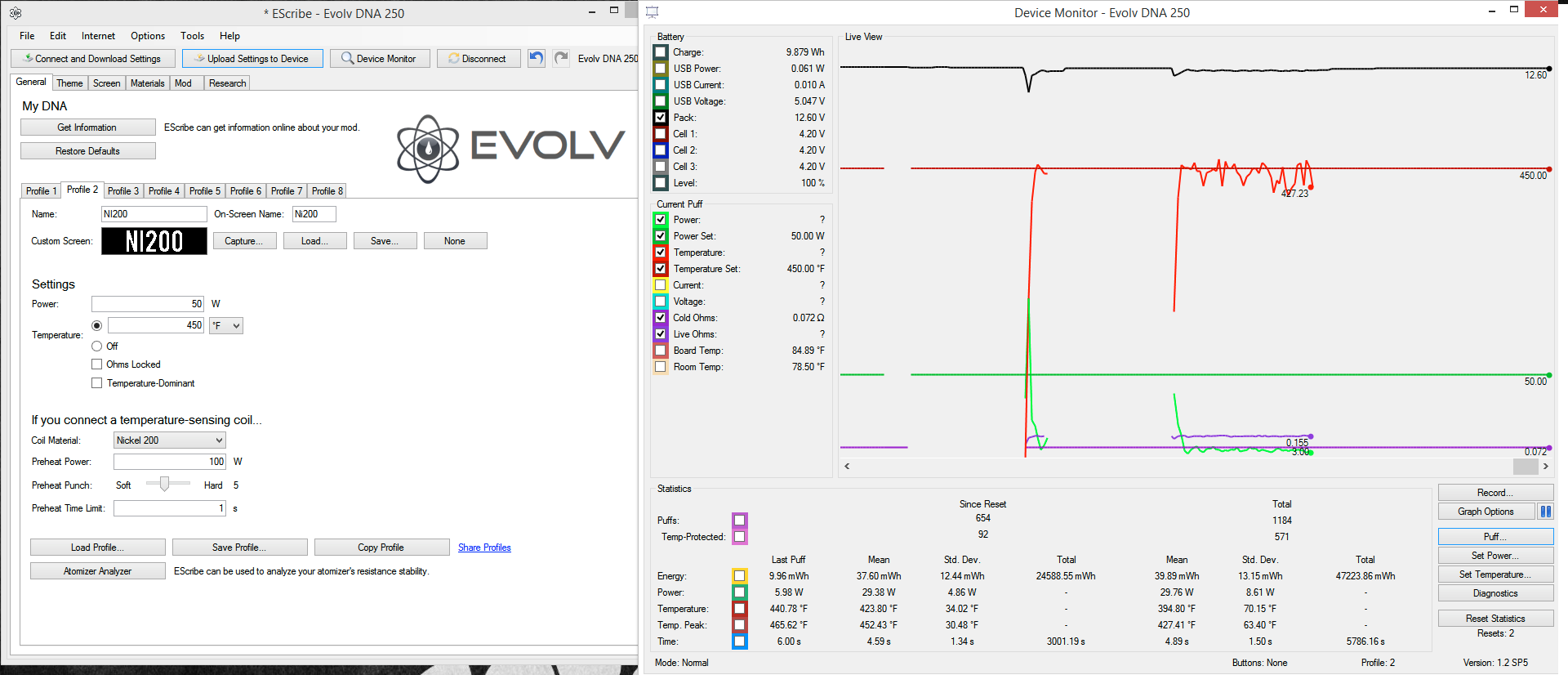

Warpten Posted March 20, 2017 Author Report Share Posted March 20, 2017 Hello guys !I'm in a world of despair, i've bought a Vaporshark DNA250, a Wismec Theorem, an Ammit from Geekvape, some cotton and a truckload of prebuild coil from UD and so far, none have worked !First i thought the SS316 was too finnicky so i switched to Ni200 (i was kicked out of TC non stop...) and even in Ni200 it's not working, i"ve tried multiples setup and my DNA250 keep sending 5W output, i'm forced to cut temp control to vape on Ni200 which isn't pleasant at all, please help ! Link to comment Share on other sites More sharing options...
giz_60 Posted March 20, 2017 Report Share Posted March 20, 2017 It looks like your live ohms are fluctuating, which usually an indication of a loose or bad connection somewhere within the atomizer or between the atty & mod...try double checking all screws, etc. on the coils..also make sure the 510 pins on the attys are tight... & clean the 510 pins & threads with iso alcohol... Link to comment Share on other sites More sharing options...

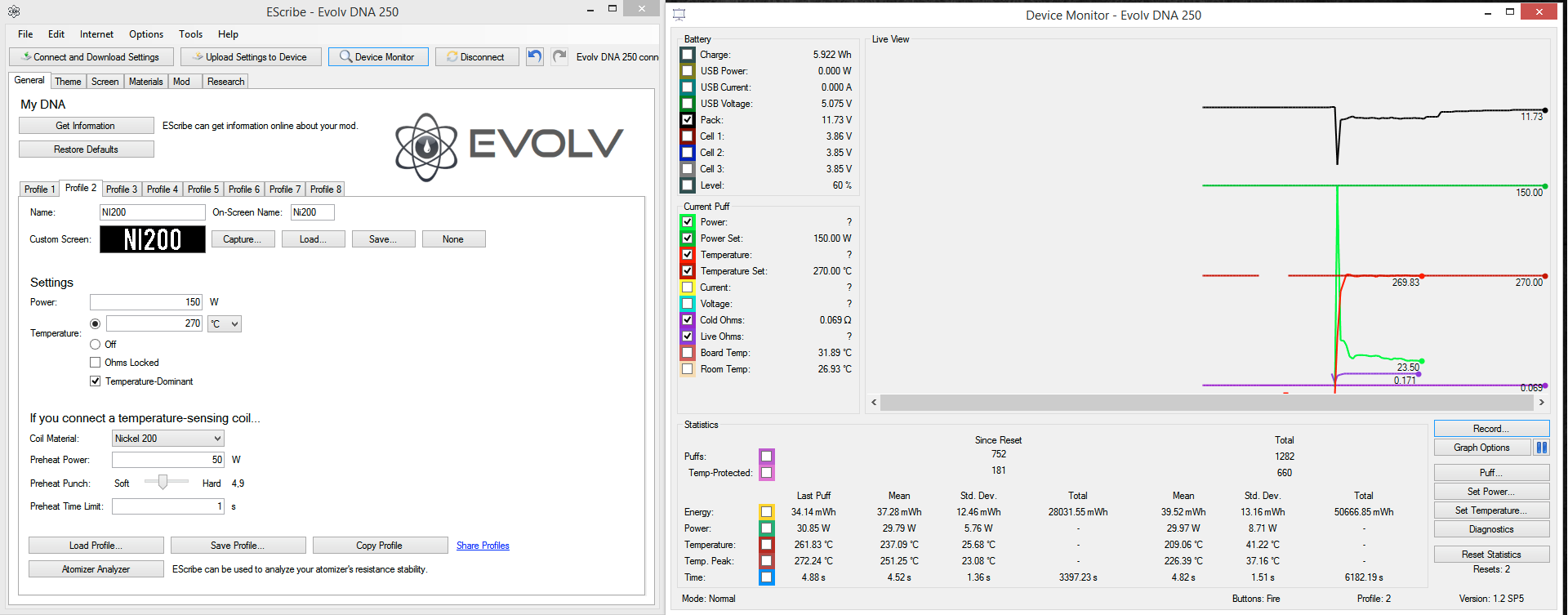

Warpten Posted March 20, 2017 Author Report Share Posted March 20, 2017 Still acting finnicky...I had to do some weird stuff to make it "work" Link to comment Share on other sites More sharing options...
giz_60 Posted March 20, 2017 Report Share Posted March 20, 2017 That looks a lot better & more stable...having good stable connections is very important with the DNA devices. The non-DNA devices are more forgiving & not nearly as accurate. Have you run a test for the mod resistance yet? Having the mod res set correctly will also help.Edit: Scratch the mod res test...forgot there is an issue with testing the 2xx devices with the software. Just check the mod resistance in the mod tab & make sure it has a value in the .003 - .006 range. Link to comment Share on other sites More sharing options...
