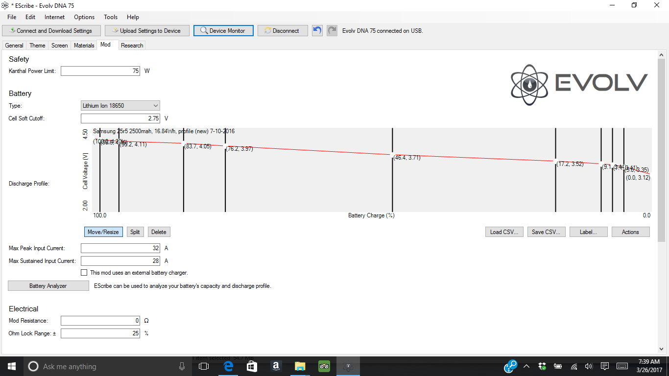

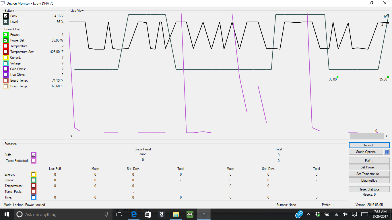

I have tried to duplicate your problem on one of my 75's...loaded a wire .csv into the battery settings & got the eeprom error..reloaded the battery .csv...check the external charger setting, but I can't duplicate the problem you seem to be having. Can you post a screen shot of 'Device Monitor' & the 'Mod' tab?

Thanks for the screenshot...helps alot...appears something strange going on with board or a bad battery connection...and seems I can't get your issue so show up on my 75, I doubt loading the wrong .csv into the battery settings caused it....As CB suggested, contact Flawless
