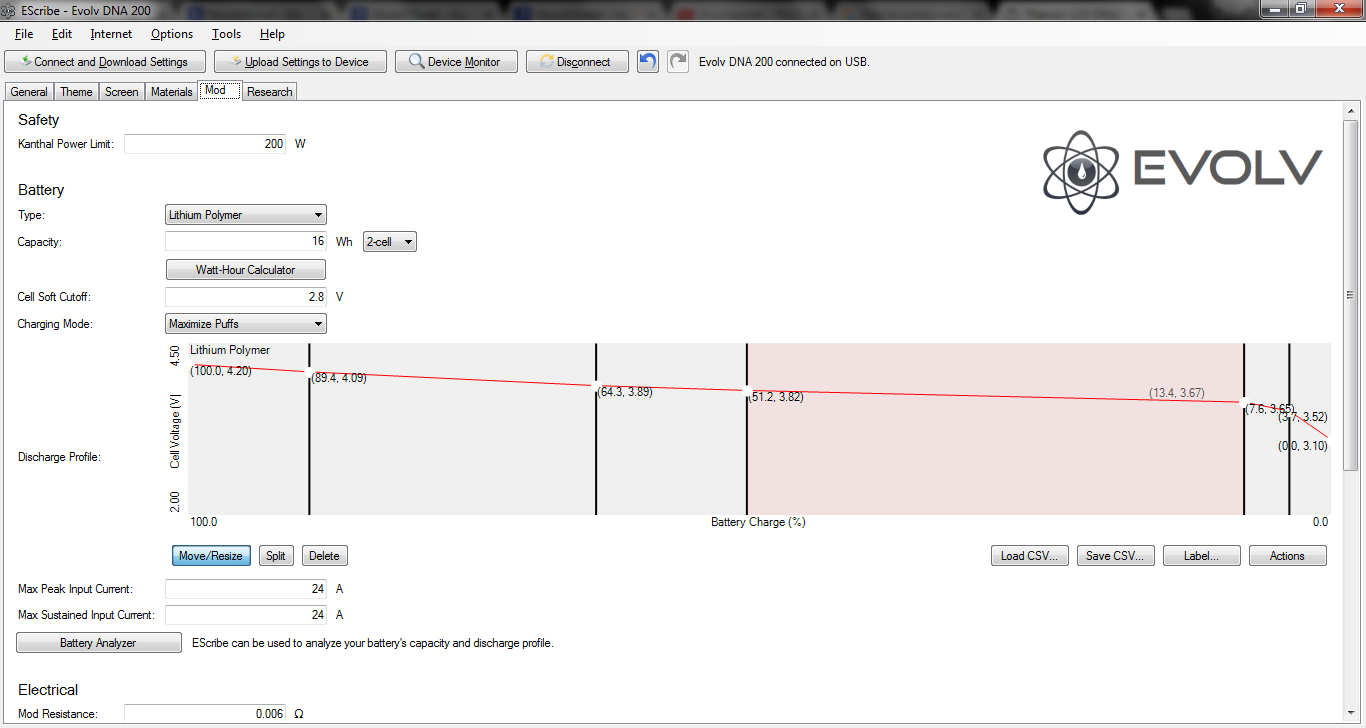

Amirulmukmiinin Posted March 27, 2017 Author Report Posted March 27, 2017 Hi guys, im having a problem with battery display in my Therion 133 DNA200,i already reset to default, reset all the statistic and so on but it still show my battery is empty. Tried to change the wH and do all the things that i found in this general discussion like change the wh to 24.42, its work but not long, after 1 minute, it will leave my battery display back to empty.I also try to ask my friend that using therion, they said i need to change the battery type from power supply to lithium polymer but i cant fire and show check battery at my display panel. help me guys. thanksim sorry for my broken english but i try my best to make sure u guys can understand what im try to discuss here. below i attach my ecig file, please help me. thankyou guysTherion 133 dna200.ecig
Spector NS5 RD Posted March 27, 2017 Report Posted March 27, 2017 post a screenshot of your battery settings in EScribe. thanks.
Amirulmukmiinin Posted March 27, 2017 Author Report Posted March 27, 2017 this is the printscreen of my battery setting. when i use this setting (lithium polymer) , my mod cannot fire and show 'check battery'.and my battery display still empty

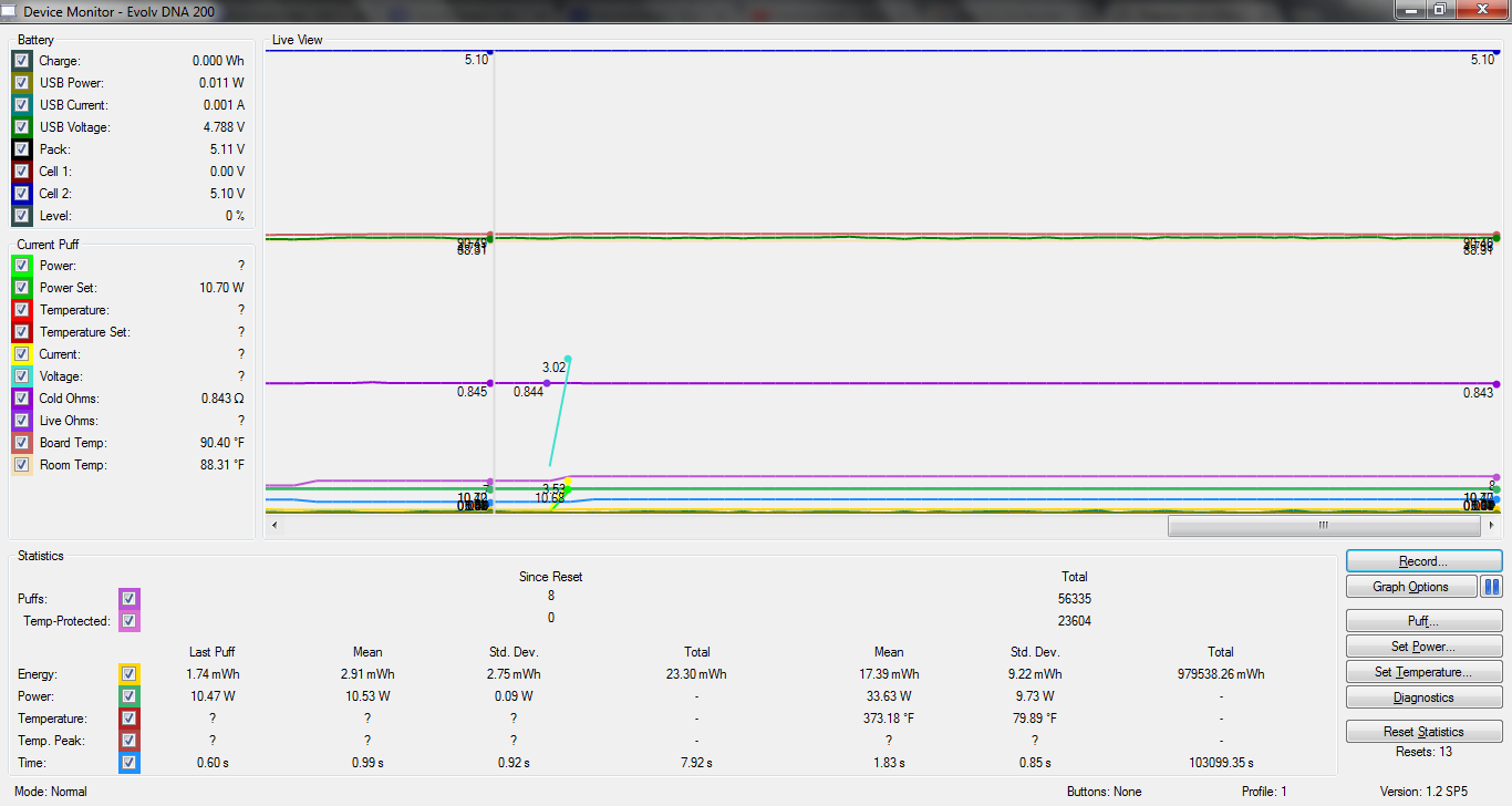

giz_60 Posted March 27, 2017 Report Posted March 27, 2017 How about a screenshot of Device Monitor, to see what your batteries are showing...
giz_60 Posted March 27, 2017 Report Posted March 27, 2017 Cell #2 is showing 5.10v...there is a problem with the device & there are no settings to change to fix it... you can contact lost vapes at...http://www.lostvaperepaircenter.com or via their Facebook page...https://www.facebook.com/lostvape.wholesale/
