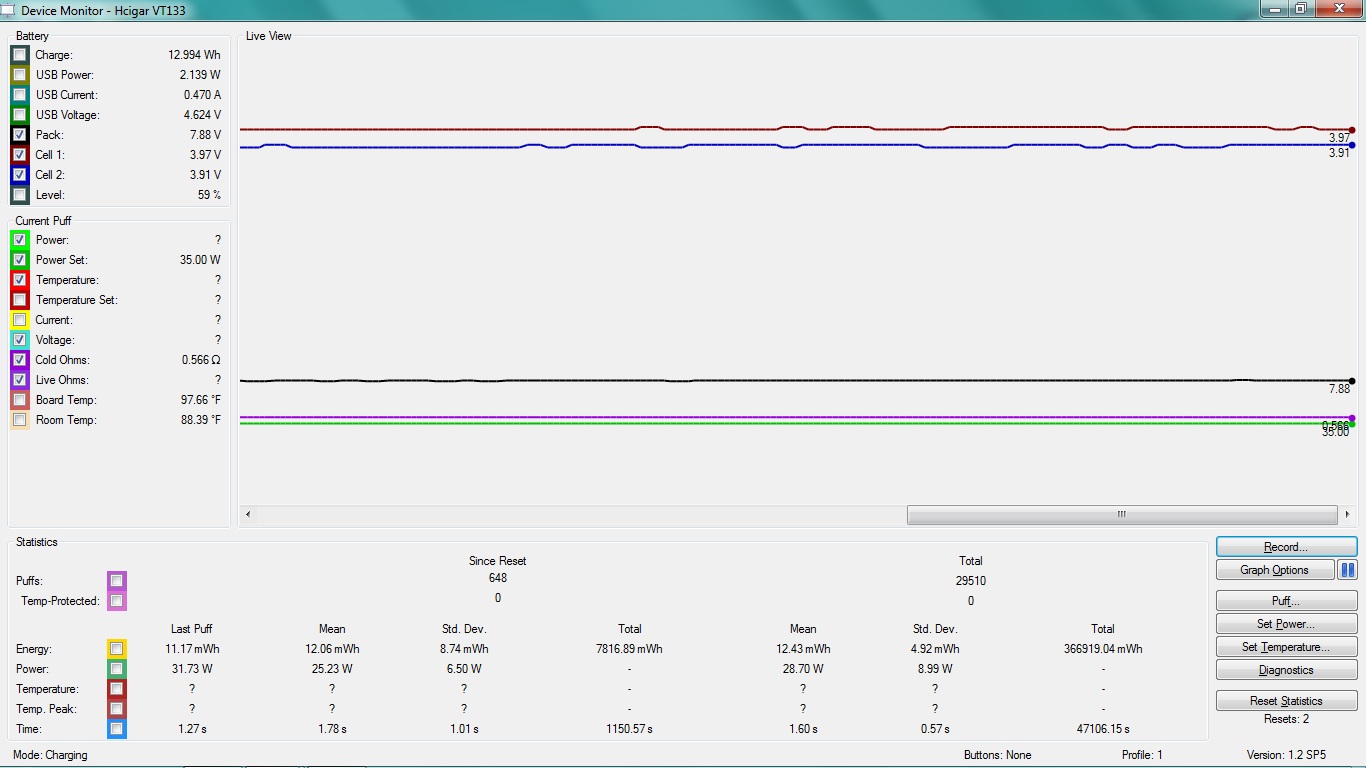

benpui Posted March 28, 2017 Author Report Share Posted March 28, 2017 im using an OBS crius plus. here a gif file of the monitor when im firing it. when i switch to another atty , its does the same thing. and also i rewrapped both of my LG hg2 once Link to comment Share on other sites More sharing options...
giz_60 Posted March 28, 2017 Report Share Posted March 28, 2017 benpui said:im using an OBS crius plus. here a gif file of the monitor when im firing it. when i switch to another atty , its does the same thing. and also i rewrapped both of my LG hg2 once CB was referring to a screen shot of 'Device Monitor' in Escribe...not of your device!! Can't tell anything from that.... Link to comment Share on other sites More sharing options...

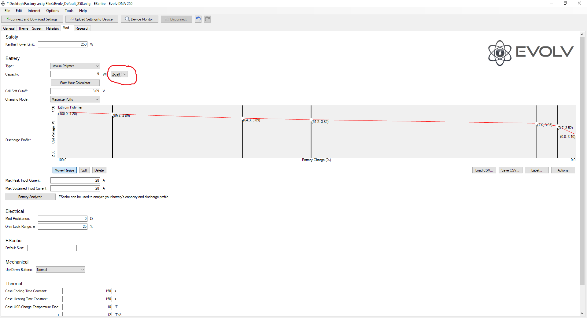

giz_60 Posted March 28, 2017 Report Share Posted March 28, 2017 Device Monitor is showing 3 cells when it is a 2 cell device..in the 'Mod' tab, make sure it is set for 2 cells & upload to device... see if that helps... Link to comment Share on other sites More sharing options...
benpui Posted March 28, 2017 Author Report Share Posted March 28, 2017 giz_60 said:Device Monitor is showing 3 cells when it is a 2 cell device..in the 'Mod' tab, make sure it is set for 2 cells & upload to device... see if that helps... i tried it . it still showing 3cell @ 1.10v and fire inconsistent voltage Link to comment Share on other sites More sharing options...

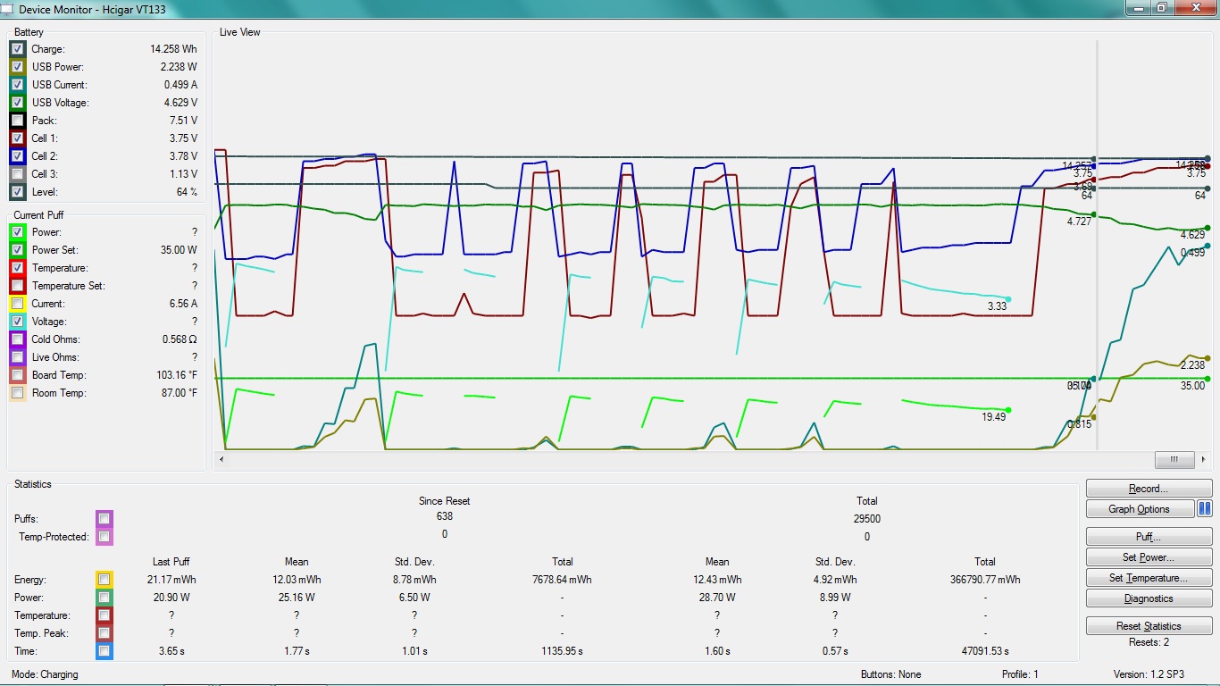

giz_60 Posted March 28, 2017 Report Share Posted March 28, 2017 You changed/posted a different screenshot...can you post another with the ONLY the following boxes checked...pack,cell1,cell2,power,power set,cold ohms,live ohms. Link to comment Share on other sites More sharing options...
benpui Posted March 28, 2017 Author Report Share Posted March 28, 2017 giz_60 said:You changed/posted a different screenshot...can you post another with the ONLY the following boxes checked...pack,cell1,cell2,power,power set,cold ohms,live ohms. ok got it. i updated escribe to 1.2 SP5 Link to comment Share on other sites More sharing options...
giz_60 Posted March 28, 2017 Report Share Posted March 28, 2017 While firing please... Link to comment Share on other sites More sharing options...
benpui Posted March 28, 2017 Author Report Share Posted March 28, 2017 giz_60 said:While firing please... ok got it Link to comment Share on other sites More sharing options...

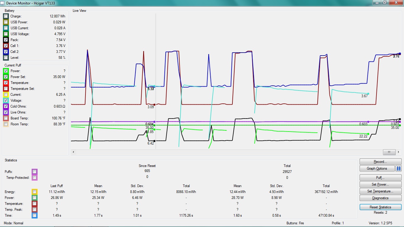

giz_60 Posted March 28, 2017 Report Share Posted March 28, 2017 In the mod tab, set your 'Cell Soft Cutoff' to 2.8v...looks like you either have a weak cell (#1) that is hitting the cutoff, or you have a battery connection issue....might want to try a new set of batteries & keep them married... Link to comment Share on other sites More sharing options...
benpui Posted March 28, 2017 Author Report Share Posted March 28, 2017 giz_60 said:In the mod tab, set your 'Cell Soft Cutoff' to 2.8v...looks like you either have a weak cell (#1) that is hitting the cutoff, or you have a battery connection issue....might want to try a new set of batteries & keep them married... thanks very much for patience and your help ! i might have damage the battery due to over heating the battery with the wrap. I'll purchase a new set of battery for it. Link to comment Share on other sites More sharing options...
giz_60 Posted March 28, 2017 Report Share Posted March 28, 2017 You will notice in the last screen shot, the wattage starts to drop off when cell #1 is hitting the 3.09 level...setting the cell soft cutoff to 2.8v will help, along with a new set of batteries...keep them married so that they drain & charge together... Link to comment Share on other sites More sharing options...
