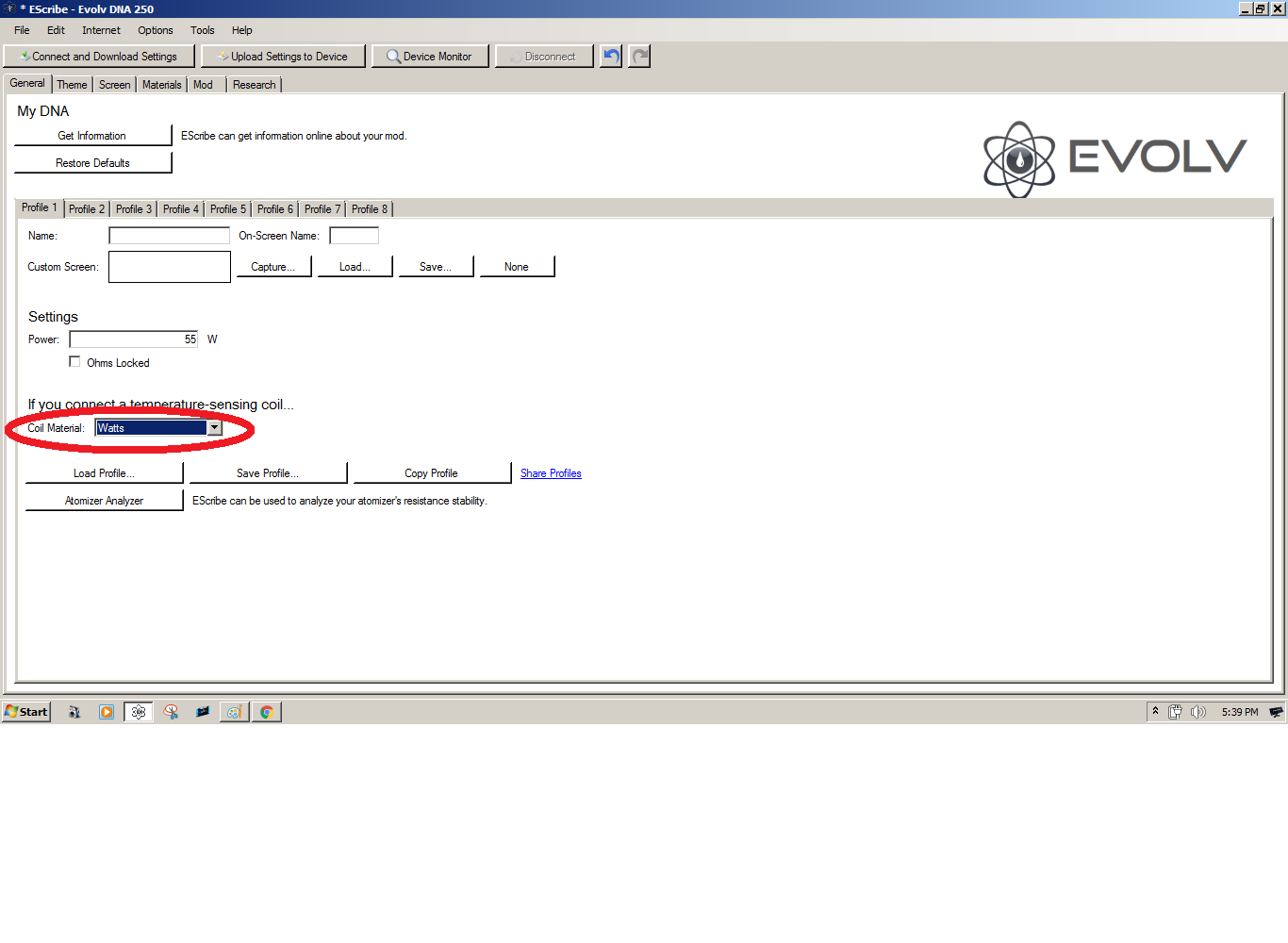

aslibanget Posted March 27, 2017 Author Report Share Posted March 27, 2017 halo guys i have hcigar VT167i have some problem and quetion1. my VT167 read ohm more high ,,, example in other mod 0,18, and in my VT167 0,22-0,24 its normal?2. cannnot lock ohm on power mode3. and now i cant back to power mode,,, no choice ,, only preset and power ctrl ss316pls help me Link to comment Share on other sites More sharing options...
Spector NS5 RD Posted March 27, 2017 Report Share Posted March 27, 2017 "ohms too high" means your coil resistance is to high for the wattage your are asking. the 167 max voltage output is around 6.2 volts.you can not lock ohms in power mode only TC mode.in EScribe, you can set up a profile for "watts" Link to comment Share on other sites More sharing options...

giz_60 Posted March 28, 2017 Report Share Posted March 28, 2017 aslibanget said:halo guys i have hcigar VT167i have some problem and quetion1. my VT167 read ohm more high ,,, example in other mod 0,18, and in my VT167 0,22-0,24 its normal?2. cannnot lock ohm on power mode3. and now i cant back to power mode,,, no choice ,, only preset and power ctrl ss316pls help meIf the mod resistance is set to 0 in the 'Mod' tab, then the reading you are getting is going to be the resistance of the coil plus the internal resistance of the mod itself, resulting in a higher reading...most mods run an internal resistance in the neighborhood of .0003 - .0006. Testing your mod is the only way to get an accurate reading of the internal resistance of your mod...Hcigar sets the mod resistance at the factory on some devices, but not all of them... Link to comment Share on other sites More sharing options...
