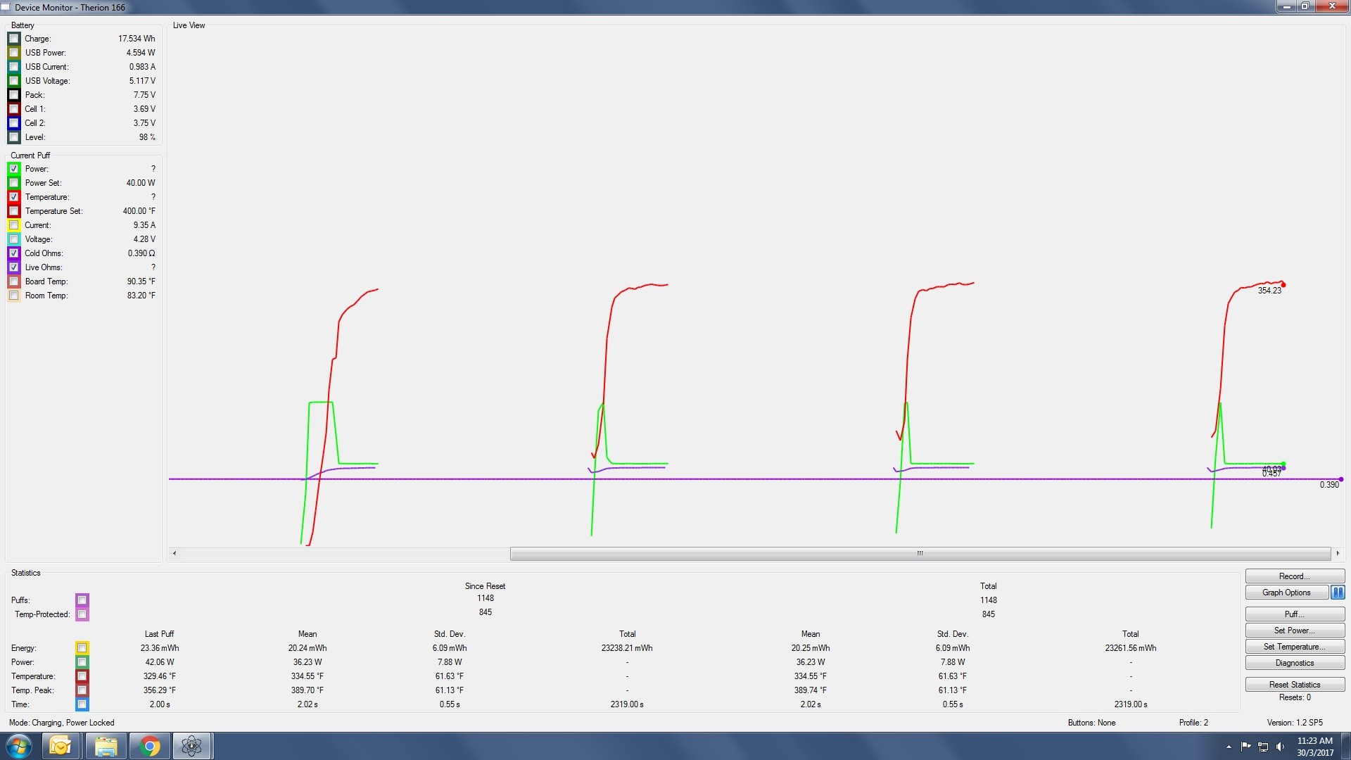

Milkbread Posted March 30, 2017 Author Report Share Posted March 30, 2017 Tried using the puff function on device monitor for 2 seconds, 4 hits from cold.Looks like the performance is back to par, not even hitting my set temp of 400F.Live ohms are looking good as well. Link to comment Share on other sites More sharing options...

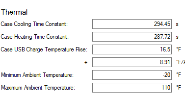

giz_60 Posted March 30, 2017 Report Share Posted March 30, 2017 Milkbread said:I am curious as to why the cold ohms read as 0.37 when raw ohms is showing 0.40, especially when the coil and mod is cold. The mod is also displaying 0.37 ohms.I also tried disconnecting for 30 minutes, and then reconnected atomizer analyzer. It is still showing 0.37 cold ohms and 0.40 raw ohms. The mod is still displaying 0.37 ohms.The difference between the cold ohms (coil) & raw ohms is..the cold ohms plus the internal resistance of the mod...perfectly normal... Have you set the mod resistance in the 'Mod' tab & run the case analyzer yet? Because, as CB stated, of the nature of SS wire, all the settings have to be set properly...a slight difference in ohms (1 - 2 milliohms) can make a big difference....judging by your cold & raw ohms, the Mod resistance is around .003Milkbread said:Tried using the puff function on device monitor for 2 seconds, 4 hits from cold.Looks like the performance is back to par, not even hitting my set temp of 400F.Live ohms are looking good as well.Looks like the reason you are not hitting your set temp is because you have your watts set at 40w, which is limiting the mod to 40w & it can't reach your set temp of 400F...try raising the 'Power' setting in that profile until it reaches temp... Link to comment Share on other sites More sharing options...
Milkbread Posted March 30, 2017 Author Report Share Posted March 30, 2017 giz_60 said:The difference between the cold ohms (coil) & raw ohms is..the cold ohms plus the internal resistance of the mod...perfectly normal... Have you set the mod resistance in the 'Mod' tab & run the case analyzer yet? Because, as CB stated, of the nature of SS wire, all the settings have to be set properly...a slight difference in ohms (1 - 2 milliohms) can make a big difference....judging by your cold & raw ohms, the Mod resistance is around .003Looks like the reason you are not hitting your set temp is because you have your watts set at 40w, which is limiting the mod to 40w & it can't reach your set temp of 400F...try raising the 'Power' setting in that profile until it reaches temp...I read an old thread about mod resistance and James suggested using the thickest copper wire possible and short the atomizer and get a reading from atomizer analyzer. I did that and the reading was 0.010 ohms. I took 80% of that and set 0.008 ohms under mod resistance. Would setting it based on the cold and raw resistance be more accurate?I ran case analyzer yesterday, and it didn't seem to do anything at all. Nothing was generated, and the thermal values for my case remained the same. I have no idea what is the expected outcome of it. I will run it again later when my batteries are lower.Yes I have increased it to 50W and it's hitting the set temp now. Link to comment Share on other sites More sharing options...
giz_60 Posted March 30, 2017 Report Share Posted March 30, 2017 Milkbread said:I read an old thread about mod resistance and James suggested using the thickest copper wire possible and short the atomizer and get a reading from atomizer analyzer. I did that and the reading was 0.010 ohms. I took 80% of that and set 0.008 ohms under mod resistance. Would setting it based on the cold and raw resistance be more accurate?.Yes, you can read this post about it, starting at about post #72....https://forum.evolvapor.com/topic/65594-topic/ Milkbread said:I ran case analyzer yesterday, and it didn't seem to do anything at all. Nothing was generated, and the thermal values for my case remained the same. I have no idea what is the expected outcome of it. I will run it again later when my batteries are lower.For some reason, case analyzer didn't finish...I have found it best to walk away from the computer or leave it alone until the analyzer finishes because sometimes browsing, etc, will cause the USB connection to disconnect and of course, make sure batteries are at least 50% drained...test will take a few hours (I usually start the test, then go to bed)...your results should look something like this, but the values will be unique to your device... Giz Method Mod Calibration.docx Link to comment Share on other sites More sharing options...
Milkbread Posted March 31, 2017 Author Report Share Posted March 31, 2017 Thank you Chunkybutt and Giz for your help. It has really helped to stabilize my SS TC vaping experience!Looks like i'll have to run case analyzer a 3rd time when batteries are low. It crashed and reported a microsoft.net error when I was doing some work during the case cooldown after charging. By the way, are those thermal values automatically propagated or do I have to input them myself? Link to comment Share on other sites More sharing options...
