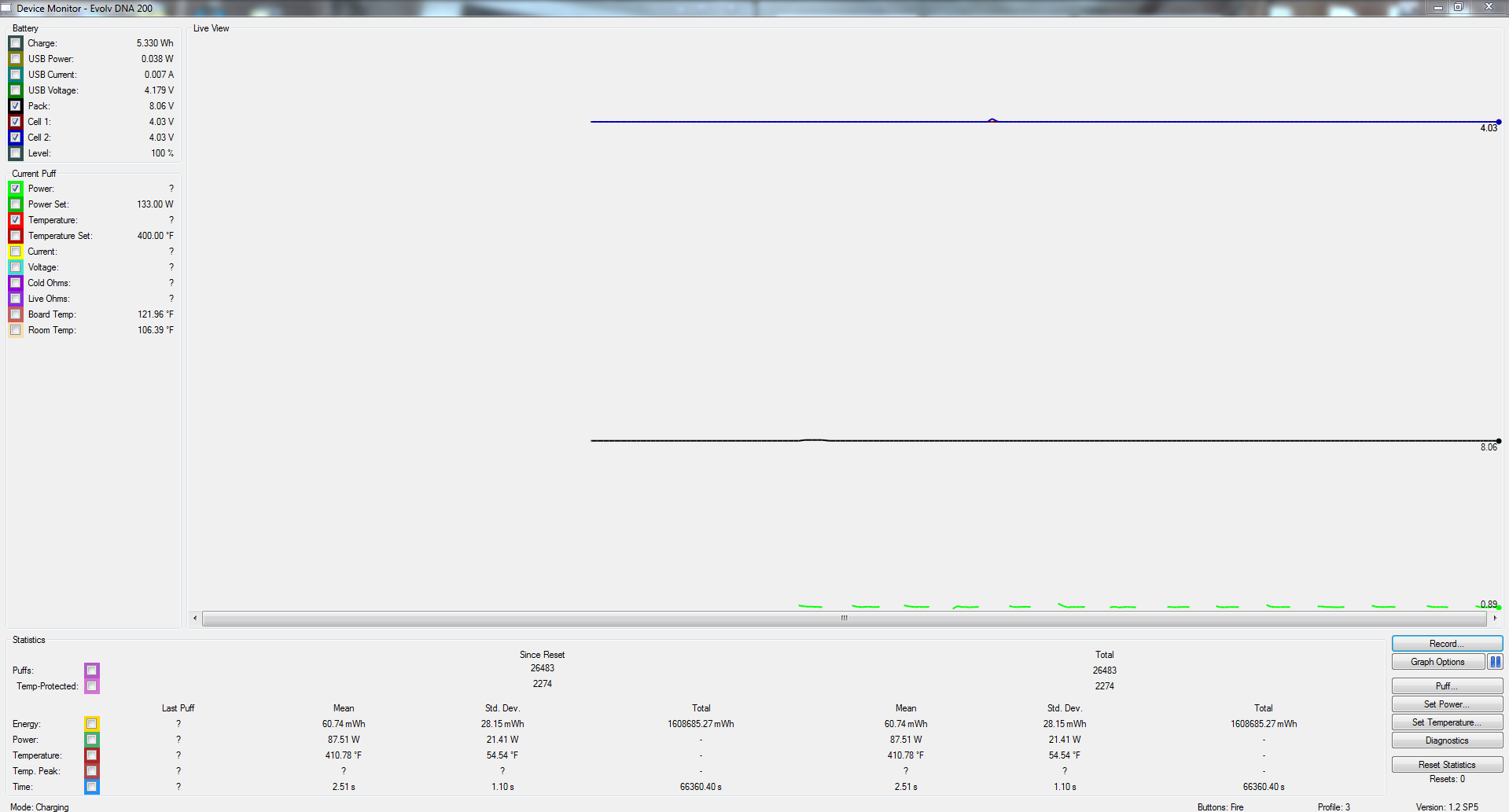

Spector NS5 RD Posted April 6, 2017 Report Posted April 6, 2017 hey steveo666, can you post a screenshot of DEvice Monitor with the battery option boxes ticked? i'm interested in cells 1-3 voltages.
steveo666 Posted April 6, 2017 Author Report Posted April 6, 2017 there ya go mate hope this is what your after

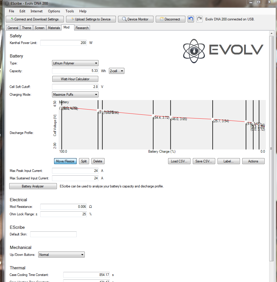

Spector NS5 RD Posted April 6, 2017 Report Posted April 6, 2017 steveo666 said:there ya go mate hope this is what your afterare you using the lipo or 18650's? in the "mod" tab of EScribe, under the battery section, you have to select and upload the proper battery config. lipo = 3cell / 18650 = 2cell. make sure to upload to your device after selection.
steveo666 Posted April 6, 2017 Author Report Posted April 6, 2017 using 18650s mate when it stopped working last night i swapped it too lipo to see if that would work but no joy so lad at shop today hooked it up for me and changed it back over see if he could get it working but alas no so doesnt wor with lipo or 18650s
Spector NS5 RD Posted April 6, 2017 Report Posted April 6, 2017 post a screenshot of your battery settings under the mod tab.

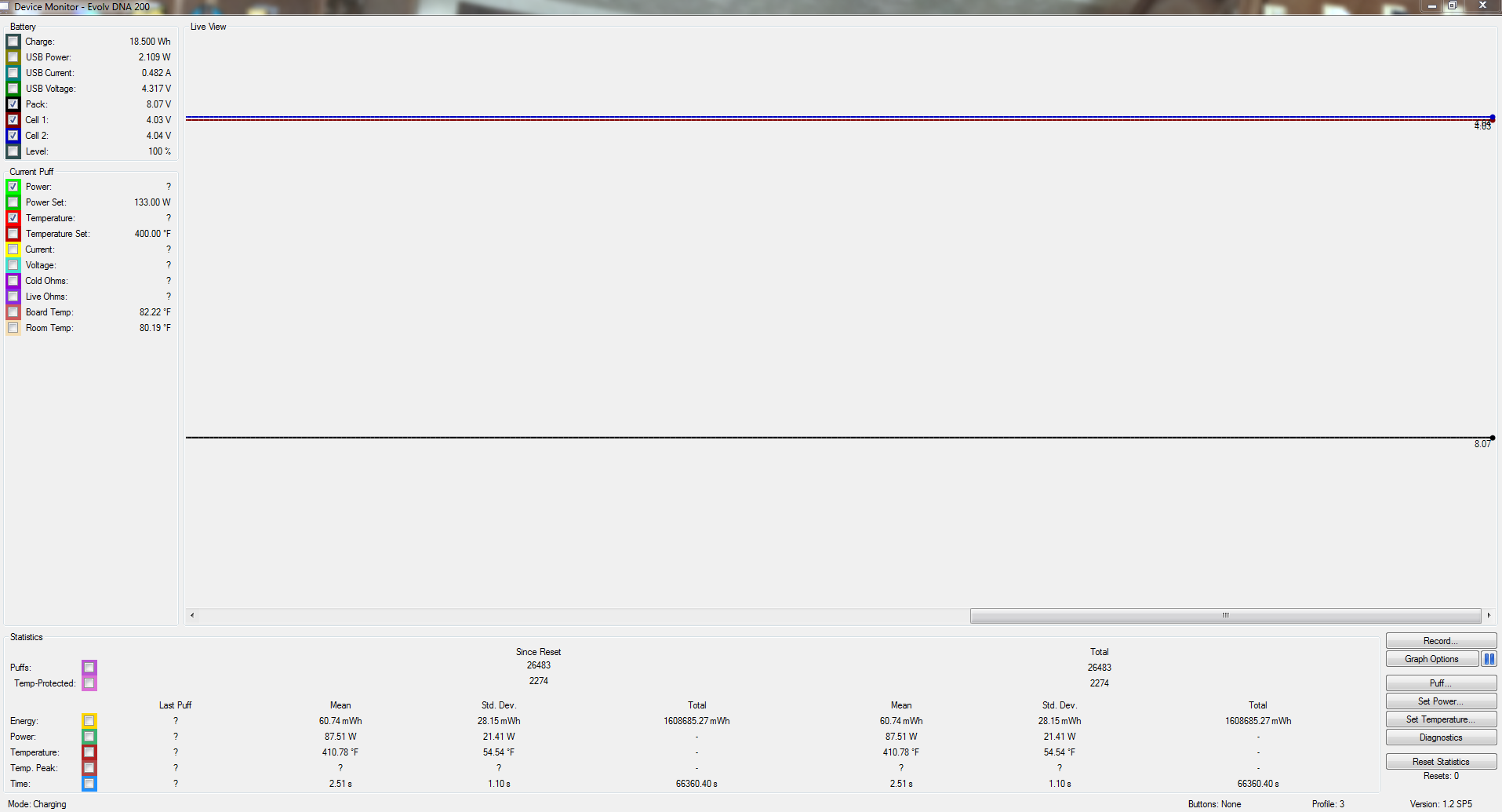

Spector NS5 RD Posted April 6, 2017 Report Posted April 6, 2017 i see you have 5.33 Wh's for your capacity. but in DM it show's over 18Wh's. i'm not sure if it will cause your device to not work, but i would correct the Wh field in the mod tab to start. also, what does the mod do if plugged into escribe and you try and fire an atty? a screenshot of DM while trying to fire would be great. another thing, what does the mod do if you hold down the fire button when not plugged into escribe? does it power on fully, then turn off as soon as you release the fire button?
steveo666 Posted April 6, 2017 Author Report Posted April 6, 2017 uum right how do i correct that please? and when i have an atty on when plugged into escribe it tries firing but then instantly says check atty and when its not plugged into anything it doesnt do anything at all like its totally dead thats the screenshot while trying to fire in escribe

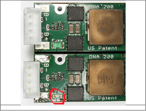

giz_60 Posted April 6, 2017 Report Posted April 6, 2017 steveo666 said: when i have an atty on when plugged into escribe it tries firing but then instantly says check atty and when its not plugged into anything it doesnt do anything at all like its totally dead That sounds like it might be a blown on-board fuse...
steveo666 Posted April 6, 2017 Author Report Posted April 6, 2017 thats what the lad in vape shop thought but thought id ask on here he did say take it to there shop on monday an they will send it to evolv for me
giz_60 Posted April 6, 2017 Report Posted April 6, 2017 If it is only powering up while on USB, then it's most likely a blown fuse...
steveo666 Posted April 6, 2017 Author Report Posted April 6, 2017 thankyou i shall take it the shop monday and get it sent off thankyou for your help
