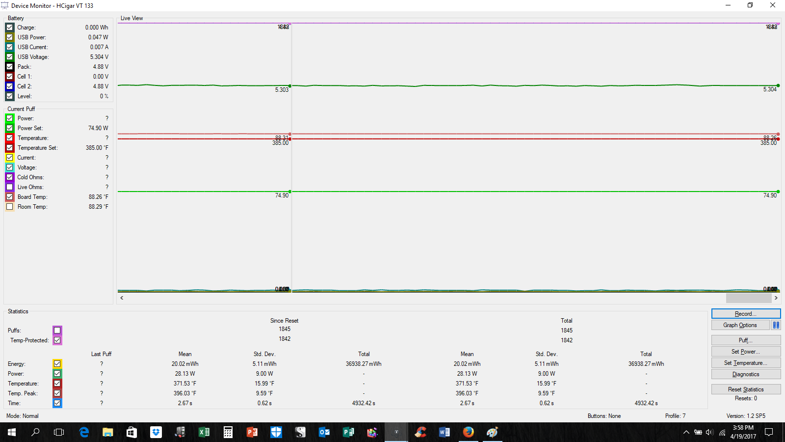

txmonkey214 Posted April 19, 2017 Author Report Share Posted April 19, 2017 Okay, after getting my mod going, and a new chip, it seems like something went south, again. Not sure why. It had about 87% charge, when I last used it. Now, it gives me check battery message, when on escribe. It simply won't turn on. Symptoms are somewhat different. Battery tray, or chip? Any guesses? I reopened my case with Warranty service. I'll see what they have to say. Link to comment Share on other sites More sharing options...

Spector NS5 RD Posted April 20, 2017 Report Share Posted April 20, 2017 txmonkey214 said:This is the third mod I had go south on me, in the last few weeks. Two were old Hana V200's. Since they're both 2 years old, I guess that is to be expected.what mod is this? One of the cells is reading 0 volts. Could be a sled/contact or broken solder joint/wire going to the Batt contacts. Does the mod vape if you select Power Supply in the mod tab of EScribe? Dont run it for too long in that mode, more so a test. If it does vape in PS mode, the board is bad or the balance tap wire isn't connected. Link to comment Share on other sites More sharing options...

dwcraig1 Posted April 20, 2017 Report Share Posted April 20, 2017 Do you have a volt meter? I'm guessing that the voltage on the pair is actually greater than 4.88 volts. can you check that? 1 Link to comment Share on other sites More sharing options...

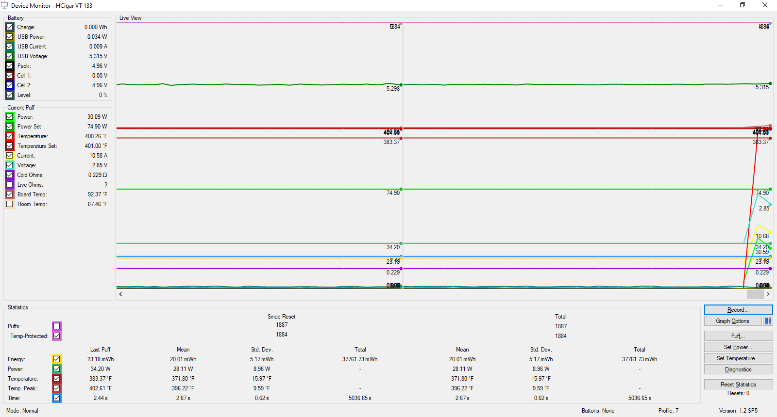

txmonkey214 Posted April 20, 2017 Author Report Share Posted April 20, 2017 Yes, 5.11 volts, standing. Here's a screen shot with the mod firing. It drops to 4.96 volts, according to device monitor. BTW, at first, the battery charge was reading at 63%. But, it would not charge. After a hard reset, that disappeared. Link to comment Share on other sites More sharing options...
dwcraig1 Posted April 20, 2017 Report Share Posted April 20, 2017 It appears to me as a typical situation where battery management on the board went south. 1 Link to comment Share on other sites More sharing options...
