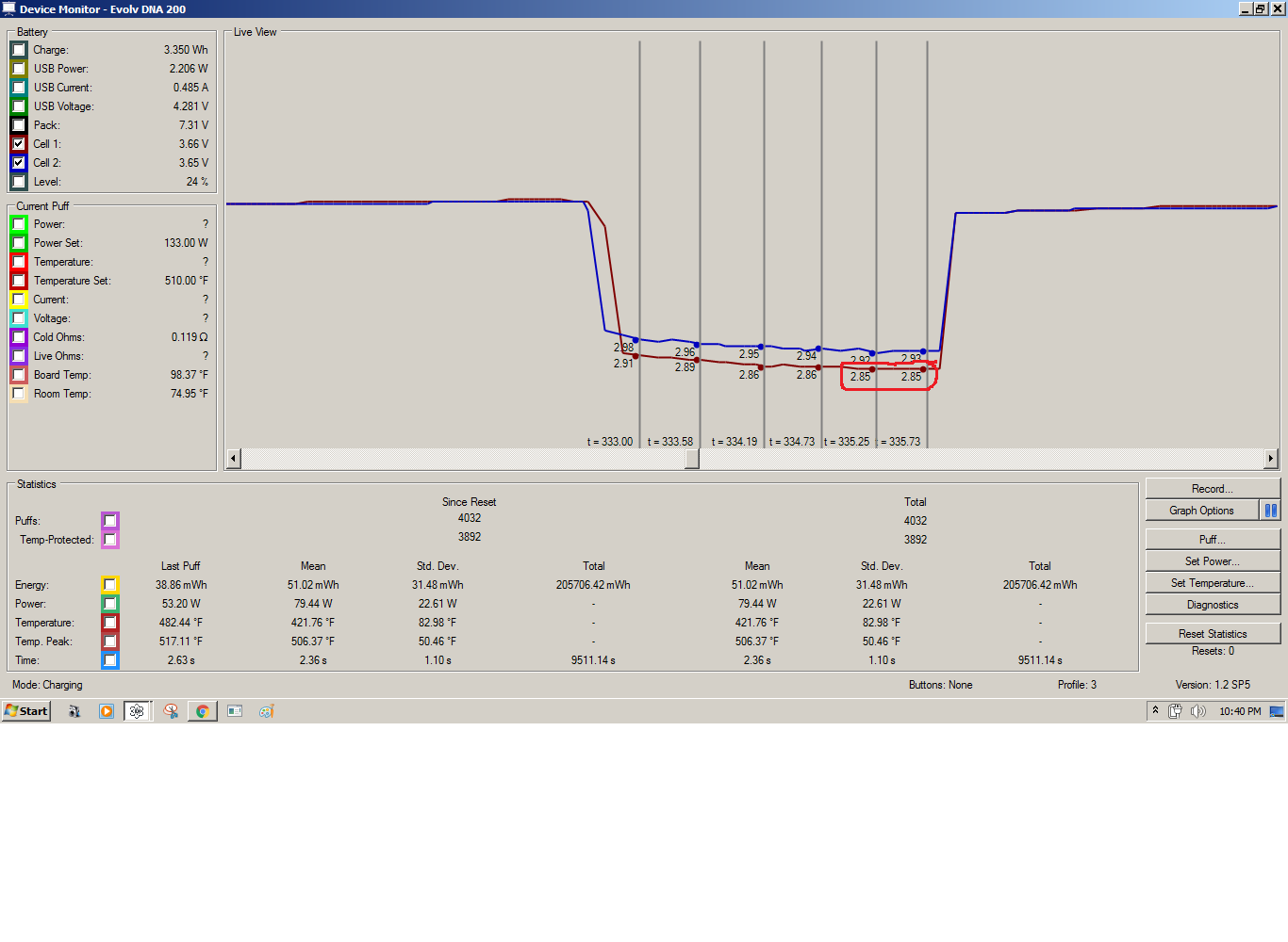

dwcraig1 Posted October 21, 2016 Author Report Share Posted October 21, 2016 It seems this is unknown, maybe Evolv can set us straight on this.What is the hard cell cutoff on the DNA250? Link to comment Share on other sites More sharing options...

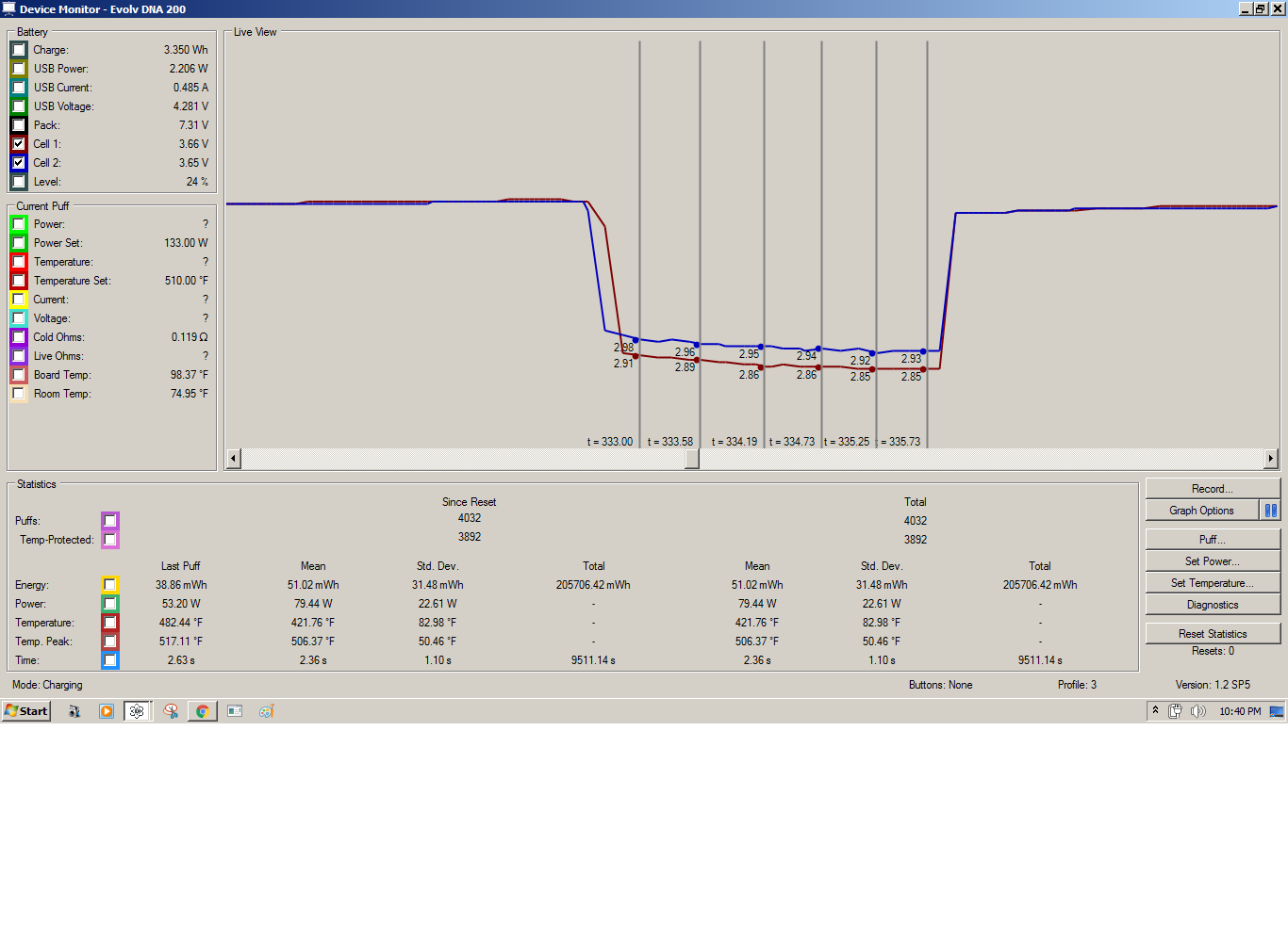

jakeycrx Posted April 26, 2017 Report Share Posted April 26, 2017 The hard cutoff is 2.9 volts. Even with the soft cutoff set to 2.5 volts it cuts out for low battery at 8.7 volts. Link to comment Share on other sites More sharing options...
Spector NS5 RD Posted April 27, 2017 Report Share Posted April 27, 2017 to back up my boy dwcraig1, this is the absolute lowest, in voltage, any one cell can go before the "weak battery" message is triggered, regardless how low your CSC is set. this is for the DNA 200 and more than likely the DNA 250 as well. the DNA 75 has a hard cutoff of 2.5v. Link to comment Share on other sites More sharing options...
