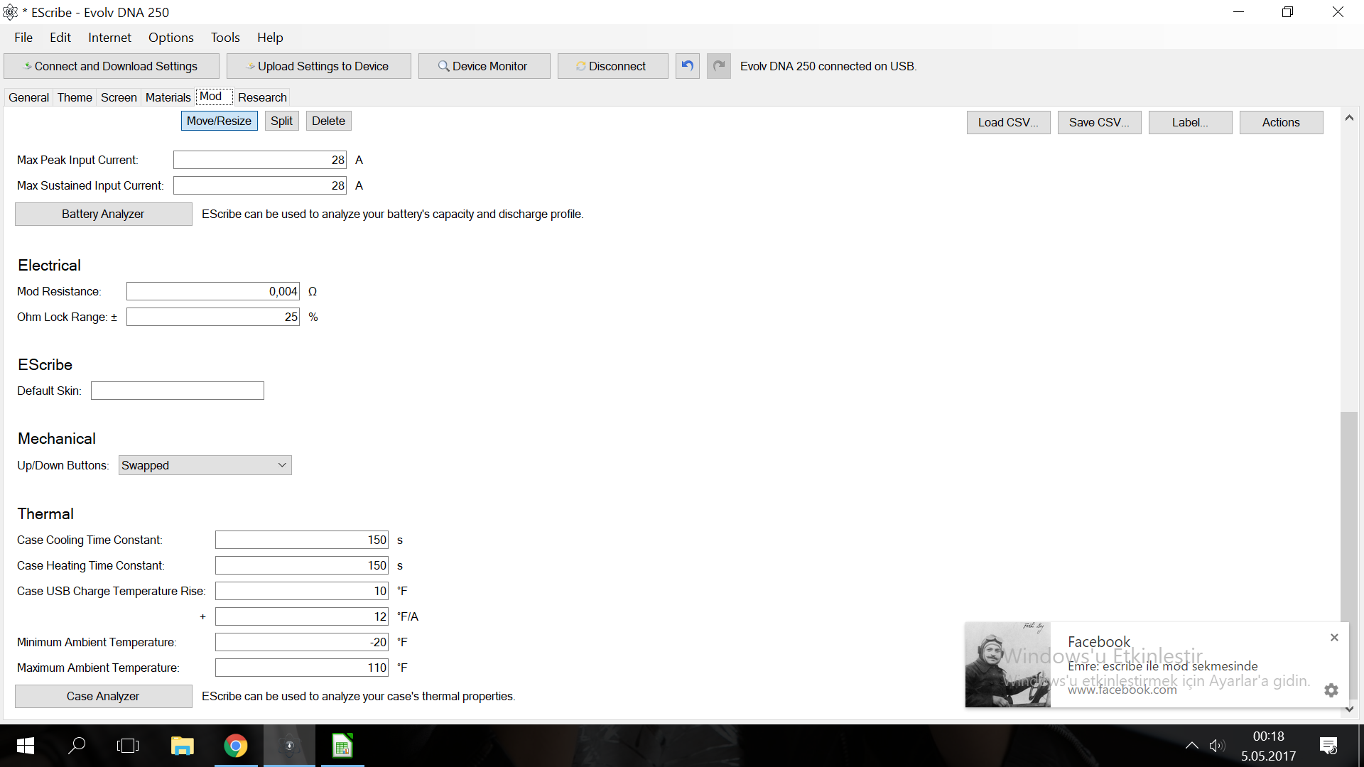

VapingBad Posted May 4, 2017 Report Share Posted May 4, 2017 It seems to be reading the ohms far too low, unless you have a big Ni coil then I would stay >= 0.05 ohm, if not Ni check the mod resistance is not set over 0.01 on the mod tab in EScribe. Link to comment Share on other sites More sharing options...

Tubbyengineer Posted June 30, 2017 Report Share Posted June 30, 2017 You need to put on a known NON TC atomiser and run the atomiser analyser - it appears you are getting a short on the 510 - either from the atomiser - or more likely from a faulty or dirty 510 on the mod. Run the atomiser analyser with the known NON TC atomiser, and then without an atomiser - You should get just a ? without an atomiser, and close to the known reading for the NON TC coil, If you get anything other than the ? with no atomiser then the fault is within the mod and is a short either in the 510 or the wiring leading to the 510. Link to comment Share on other sites More sharing options...
