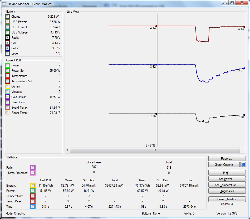

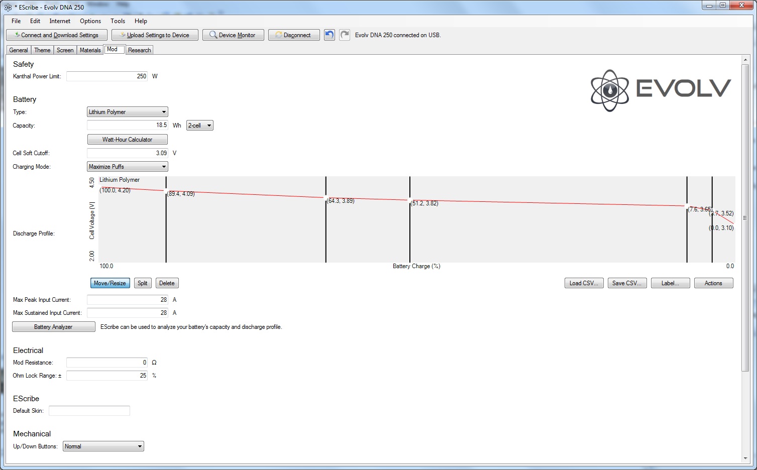

DanielB Posted May 8, 2017 Author Report Posted May 8, 2017 HI all,i have bought a drone bf 166 and i have a problem with it.It displays always the battery empty and when i monitor the device with escribe i see the cel 1 and cel 2 with different values, this values change in short time asynchronous, the cell 1 become 4.2V and cel 2 become 3.7V.I measured more pairs of bateries with my tester and the batteries are ok both 4.2V.I have two pair of batteries, one pair samsung 25r 2500mah 30A and one pair imren 3000mah 40A.Some times, after i wait for hours the battery icon apperas filled and i can press fire button, some time the battery icon is empty and the fire button work, many times i see check battery.Please let me know if you have some similar problem, and if there are solutions.i tried to download ad upload the firmware of drone and therion from the site to my box but nothing change. i have installed the service pack but nothing change. i did more and more tentative but nothing change.Please help me i'm so frustated
