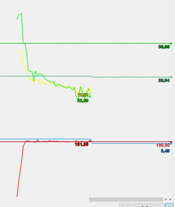

Hi, I'm vaping on a Thelema solo DNA 100C, I'm trying to optimize my salted butter caramel flavor, it's not easy. could someone explain to me why the temperature information is different between the Escribe monitor and my box, please? monitor : 190ยฐc (+-3ยฐ) Box : 184ยฐc

Not finding the option in your theme, I removed the Coil material option, which I did not find useful, to replace it with the power option, this allows me to give enough watts to heat up desired max, I find that it avoids the diesel effect, this effect of rising in temperature very slowly. If I understood correctly ๐ค I hope to be understanding๐
Thank you for this information, I had not understood the use of this option as you tell me. Yes, it is degrees Celsius. Another question : - I vaping with a single wire SS3165L coil, is it normal that I have temperature variations? - Is it normal that we can modify the holding power in temperature control mode only on the Escribe software, and we cannot access it in the theme?
Hi, I noticed this problem with the DS and Gold version. Yes, in "temperature control" mode, the desired temperature is set, but if the holding watts are too small in the profile, the desired temperature cannot be reached. In my SS316L profile I had: power 20 watts; Temp 200ยฐ and boost 70 watts, the box didn't want to go up to 200ยฐ with 20 watts, with the Escrib software I modified the 20 watts to 55 watts and the box went up to the right temperature. You cannot change this value in your profile. I may not have understood how it works
