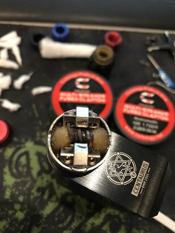

Dna 250c Titan 1 installed on the atamizer.the resistance of 0.333 on the bench press for a few ohms very often reaches about 0.415 and the wire is very hot.I do not click often it decreases back less and less !Is this how it should be?Maybe I need a profile for titanium 1 other.:For example, titanium ready esgo ?And what soprotivlenie it is necessary to establish that minimum ?And then it jumps as I described the problem from above!
no, not a person, but it was a little, the taste was weak, even the tc worked a little. Yes, even on titanium, cotton wool burns (resistance jumped). But before that I smoked on 316 stainless steel, there were norms (more than less) on firmware 33, then switched to 38 and again the taste was gone. The theme of the cp (gauges) I measured the broadside admiral clone resistance (if I did the right thing, I clamped tightly the connector of that part separately until the very end that the last one gave out and left it! I need to finish it. I bought 6mm of copper and I'm waiting for the inhabitant by measure.But 6mm is not enough, I did not find any more, for example 7mm (I needed it)
made one coil parallel from two multi standard fusion claptons one ss316 another nichrome 80. .stim engene chose parallel added 316 + ni80 But the replay is not even included! He seems to work thermo then no. I understand that the replay can be played on different materials. Explain how to use different materials.? And is the ss-core ni80 wrapper suitable for replay? сделал один койл паралель из двух мульти стандарт фьюзд клэптон один ss316 другой нихром 80 . .стим энжейн выбрал паралель добавил 316+ni80 Но реплей даже не включается ! Он вроде рабоатет термо то нет. Я так понял реплей можно гонять на разных матерьялов . ОбЪясните как на разных матерьялов изспользовать .? И подойдут ли для реплея обертка от ss -ядро ni80?

Как я понял про эти номера меди они разные, какой-то номер из них для токов и проводников электрики(То есть для разных применений эти номера) .м1 и м1р в этих присутствует 99,9% везде по-разному пишут м00 там меньше или также 99,5 .-99 На фото посмотри про , эти номера У меня нет инструментов и где медь взять ,тоже не понимаю .Я знаю в трансформаторе есть, почище там.Но я не полезу туда . хочется ,дна высчитывала хорошо и правильно .Как на все 99,9 и купить на али -
Какую нужно купить чистую медь 99,9% для измерения внутреннего сопротивление мода дна .Проволоку ,.?В атамайзер на крутить за место спиралей ,я наверно так понял надо делать.М00М1М1рОни различаются чем то ,для разных спецификаций предназначены .Вот какой нужнее и правильней 99,9%?Размер какой нужен ?Для установки в атамайзер как койла?
