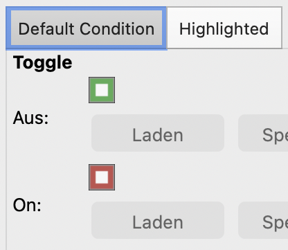

There are no specifications as to how the so-called "user toggles" are to be used.
Every theme author uses them for different things, so it makes sense to reset them before installing a new theme (I created a tool for this find-fix-problems).
It also happens that conditions appear in a theme that are linked to a user toggle that is not set anywhere: many themes develop over a long period of time and not everything is always followed up, or certain fields are used in different themes and sometimes these conditions are very complex and an adaptation is neglected by the author. I am also affected by this, as I have developed both monolingual and bilingual themes. In my current theme there are always unused fragments of old versions - it's not nice and actually sloppy, but that's just the way it is.
