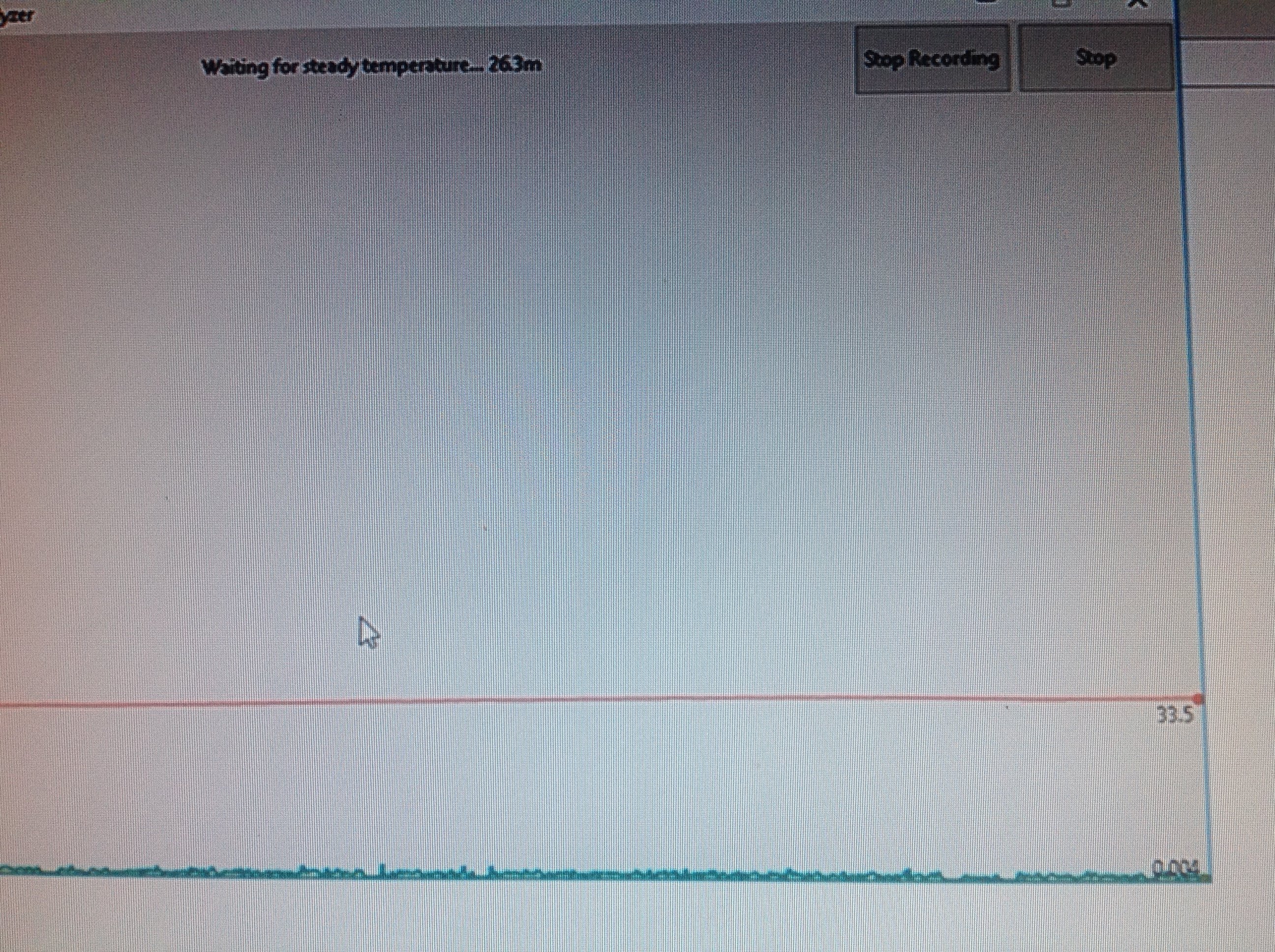

Triade dna250c, case analyzer, device still charging at 0.001- 0.009 amps

I didn't state how long I left the test run for the first time. I let the test complete but the results were bad because of this trickle charge leak. The pictures above show the first five minutes of it heating up over 5° C in that time period when it should not be heating up at all I know this is not normal for it to leak charge when it should not be charging. I want to know how to fix the problem ? do I need to send it away?- 10 replies

Yeah well like I said if the respondent had of read it the ticket they would know and I was talking about case analyzer lol and the ticket subject/title name is (case analyzer, device still charging at 0.001- 0.003 amps) I guess I should've been more clear, this part of the test is trying to establish stable temperature at the very start of the case analyzer test. There should be in zero charge going through to the battery to a establish stable temperature reading and because of the small charge leakage going through it is heating up, more than 5° C within the first five minutes. which will throw the over all readings out. Like it said in the picture waiting for steady temperature, and again because of the small charge leaking through it is unable to do so because the temperature is rising. PS the charge leaking through at that point of the test (The start of the test) is not normal and should not be happening! yes the mod has been left to sit for a long period of time before doing this test and yes the battery has been discharged past 25% I guess I should change it to (case analyzer, device still charging at 0.001- 0.003 amps when it should not be CHARGING AT ALL and it is heating up the mod)- 10 replies
Triade dna250c, case analyzer, device still charging at 0.001- 0.009 amps when i run case analyzer its showing my mod still charging at 0.001- 0.009amps.the battery is at 25% an left sitting for a few hours before running the test.i have tried a firmware update, soft and hard reboots, disabling usb charging. i have checked the battery profile, its ok.i have NEW (LG HG2 batteries)LINK to batteries https://cdn.shopify.com/s/files/1/0674/3651/files/lg-hg2-spec-sheet.pdfI have looked online for hours for a fix but no fix, just other people with the same problem. But there is no information on how they resolved the issue.can you please help me fix thisthanks I have lodged a ticket and so far there has been no help this is the reply I got. (Your battery needs to be fully charged before starting the test. Additionally, I would let the device sit for and hour or so before starting the test) I don't think anyone actually read my ticket!
