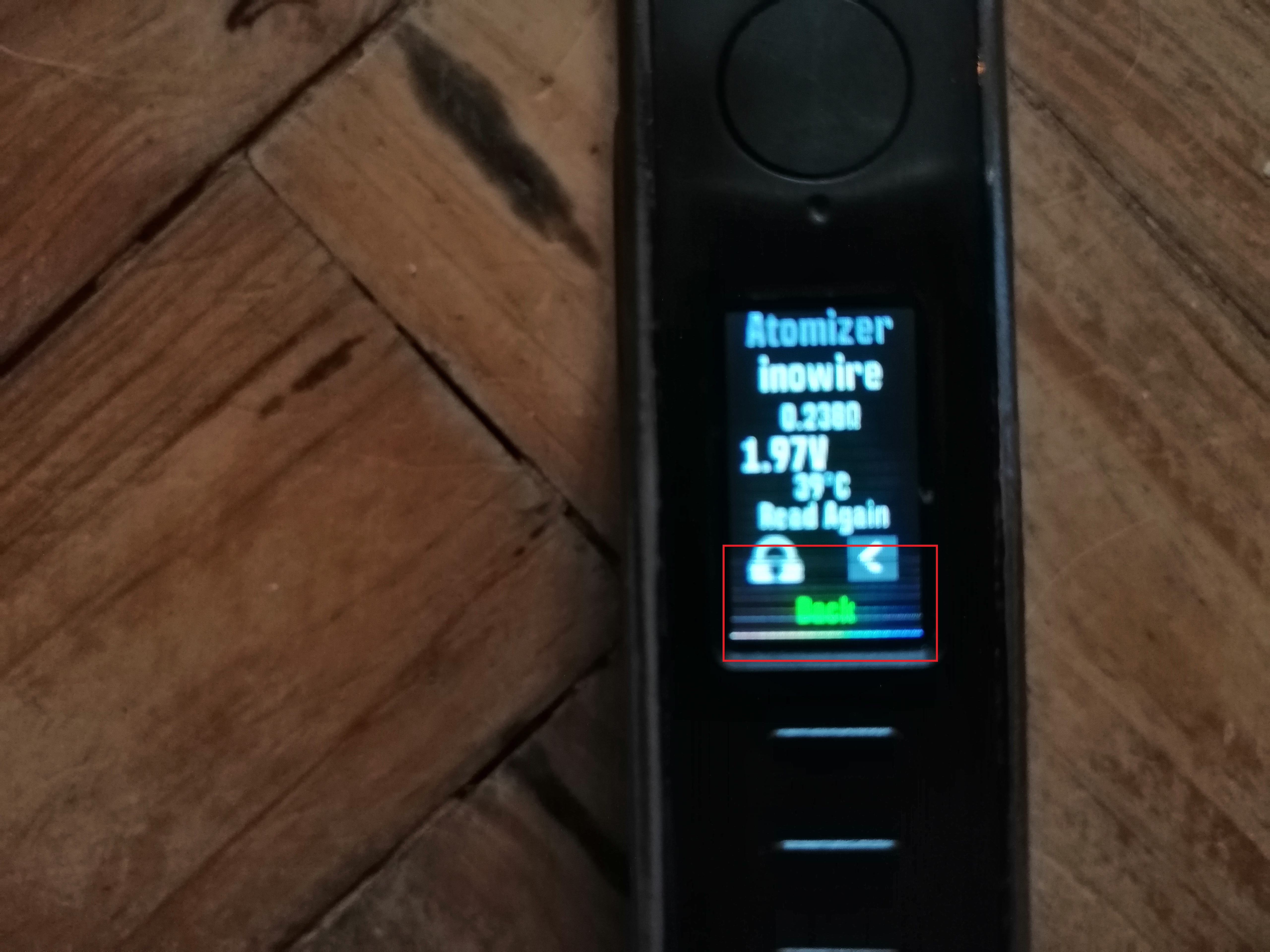

so i received a new screen and worked like charm by one weak, today i looked at screen and at bottom i saw some horizontal lines... is this screen fault or maybe board or even maybe firmware ?

this works ? the img attached how can liquid be inside just on middle ? how did that liquid got up inside ?
ok, thank you 😃 anyway how can this happen ? the mod didnt got droped off neither i hit it anywhere, i just turned it on and was like that
so i just turned on my DNA and appeared like this: didnt got it droped or smached in anything, solution is to replace screen ?
